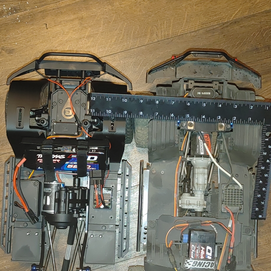

By my understanding, the Element, 10.2 and Trail King are all pretty similar. Does anybody know if they're similar enough that I could mount the Element IFS let to the TK chassis? With or without the 10.2 conversion kit?

I'm pretty sure the TK motor position would land right where the IFS kit needs to go so I'd wager it wont fit.
If you swapped to a different tranny I'm sure it could work.
I'm pretty sure the motor position would land right where the IFS kit goes so I'd wager it wont fit. If you swapped to a different tranny I'm sure it could work.
I didn't think about that until just now. Thanks for bringing that up.
I'm mainly curious about the chassis holes and chassis shape though as I might be able to use a shorter motor or relocate the servo if necessary (I could change the transmission but that would eliminate one of the features I want from the TK). But I'm not sure if the TK chassis would be compatible or if it would need a special mounting plate

I have both trucks but I posted this while I was at work hoping anyone could offer a definitive answer so I wouldn't have to tear apart my two favorite trucks
Taking a closer look at my Knightrunner, I see the frame rails are very flat in the front compared to the TK/scx10.2 syle chassis. So I imagine I'd need the 10.2 conversion at least. But it appears I could make the TK motor/transmission fit (barely) with slight modification to the E-IFS if I relocate the steering in some way.
The square shows the approximate location of the end of the TK motor relative to the IFS on the KR

The way your motor/transmission is set up, ain't gonna fit the IFS. The rest of the chassis, it's possible.

I think, but can't really say until I try it, with the E-IFS servo removed, steering reconfigured and a notch cut forward into the IFS mounting plate it might work.
There's a decent gap between the mounting plate and the differential that's only occupied by the servo and the link to the bell crank. With those out of the way, the motor looks like it could fit in that gap.
