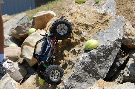

some Rc Porn for ya!

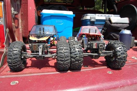

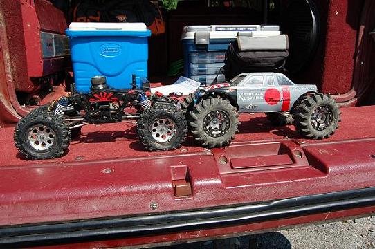

quick tire break down
I run the flat irons . And im always messing with my foams trying different things. I like the foams that come with the flat irons cut down a little bit all the way around ,and i narrowed my fronts and glued them together with the lugs lined up instead of staggered . This helped with the grip as more lug hooks up on the rock edges . and it also changed the look of the tire . plus being narrow helped the turn radius . stops rub with the lower links .hope this helps ."thumbsup"
