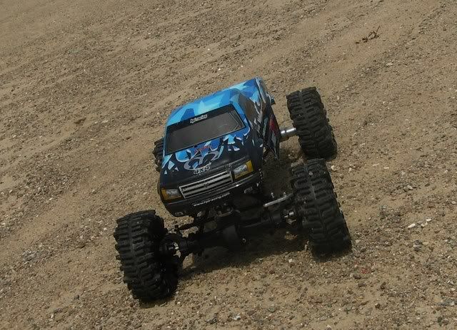

Flip´d axles with BTA

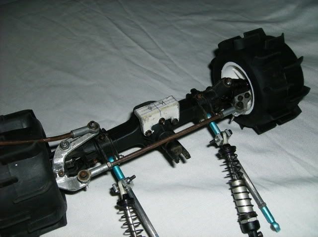

Rear axle with custom link mount
Clean looking front end
and look at the pumpkin ... c",)
Wild wheely king with BTA
