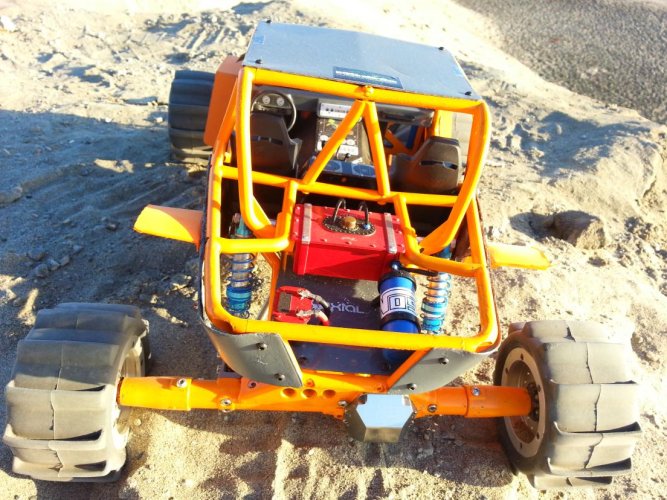

My next project!
That is a Yeti XL cage and those are 1/5 Trenchers. I will be buying 2 sets of RC4WD 1/5 paddle tires soon after the buggy is complete.

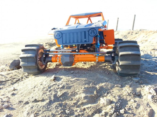

Well it's been a while since some body posted "almost 2 month"so a guess it time for a new blood this is a start of something possibility #1...."thumbsup"
Possibility #2
#3 is coming.....
Well it's been a while since some body posted "almost 2 month"so a guess it time for a new blood this is a start of something possibility #1...."thumbsup"Possibility #2
#3 is coming.....Hell this is number #3 [/QUOTE]
SCX10 chassis rails
SCX10 skid plate
Wraith skid plate
AR60 front end "Diff Reversed"
SCX10 rear end 25mm "Wider"
Yeti rear shock tower
Yeti rear shock tower "In Front"
Yeti gas tank "Modified"
Internal Springs shocks "Traxxas"
Integy all metal gears trans
Proline Sand paws 2.70 x 5.22
AX3 ESC TX 3150 Kv Vanguard
Turnigy 2X 2200 Mah 3S 40C
Custom cage
Custom links
Custom battery tray
2X Fans
Towardpro MG996R Servo
