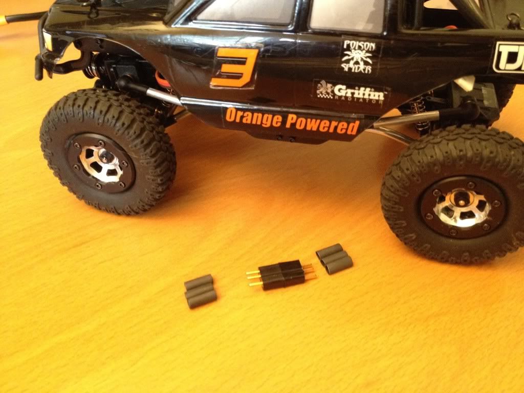

I'll be swapping my servo out shortly. One think I was thinking about doing was using deans micro 3pin connector for the servo, and CA glue the female connector (connects to servo) the back of the servo.
The micro deans are polarized (can't reverse them by mistake) and pretty small. While they come with pre-cut heat shrink tubing, I think I'll solder these to wire without the heat shrink (so I don't have to split the servo wire up further from the soldering), and instead just liquid tape the exposed solder leads. You can also use the liquid tape for the servo wires themselves, makeing them all-black which is a cool look. That requires 2-3 coatings so it's on thick n' good and wont rub off.
Here's pic of the dean's micro 3pin, connected:
I know, it involves soldering. But having crimpled a lot of JR servo connectors, I actually think the deans connectors are easier to use and have a better connection.
