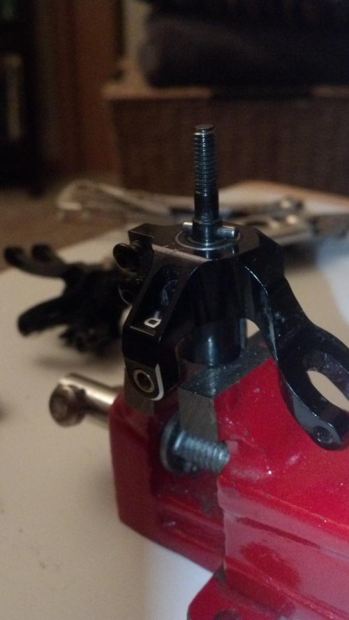

The pin that goes through the axle and that the hex fits on is supposed to keep the hex from hitting the bearing. With the wheel and hex off you need to check to see if the pin is hitting the bearing. There is suppose to be a gap. If not, post some picture so that we can see what is going on.
Here's a picture of it. There is a very small gap between the pin and the bearing. I can get a piece of card stock between there, but certainly no more.

What does the back of the hex look like? Did you try pulling the inside bearing out to make sure it was ok? What knuckles are those? Its possible the knuckles were not made right and are a little too deep.
If you look behind the wheel when it is mounted is the plastic of the wheel touching the knuckle?
It looks like your wheel has been brushing on your steering arm too, but I think maybe your inner bearing isn't sitting deep enough, or it may be slightly too wide.
It looks as though your driveshaft isn't protruding as much as it should. Is the ridge still present on the inside of your hex? I had something similar on an old Tamiya buggy where the ridge had gone (sanded flat by a previous owner) and the back face of the hex was pressing against the whole bearing face, rather than the ridge pressing against the inner race and allowing it to spin freely.

I think the bearing is being pressed regardless since the problem persists without the wheels on. I'm not sure how well my video showed that, but I don't think the wheel is rubbing on the knuckle. The steering arm I'm using was not installed in the pics or videos; those are still on the truck. I'm guessing the wear that's on the BTA arm happened some other way.

Looks like your outer bearing is sitting proud of the knuckle, so maybe the extra width inside you mentioned is the problem.

It does sound like the bearings are being crushed tight, can you get a pic of the driveshaft with the bearing removed. I'm wondering if it's binding up here rather than at the hex side.
