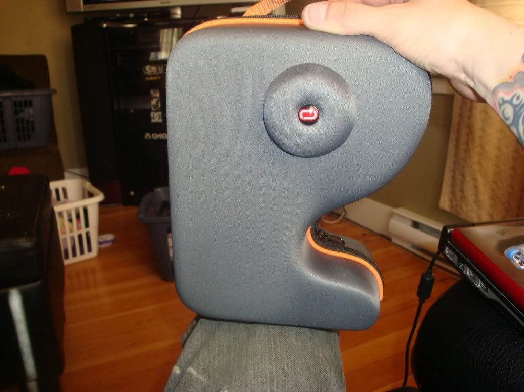

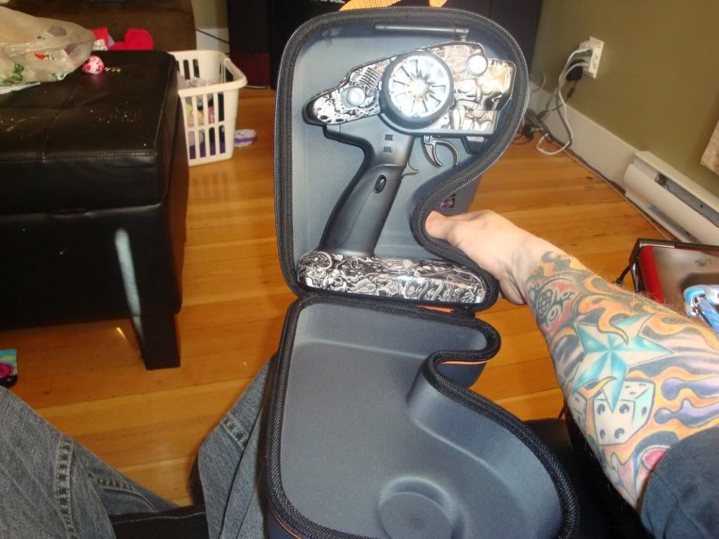

Hey Harley, I hope you don't mind me throwing this out there but I wanted a case to protect my 4pl and I didn't have much money so I found this online for 20 bucks. I figured I'd give it a try but wasn't sure if it would fit since it's made for a dx3r/s/e, low and behold it's like it's made for it"thumbsup" Part number is VNR2024, made by Venom.
Thanks for the above post, my LHS carries those cases and I keep forgetting to bring my radio in to check fitment. I'll pick one up finally.
