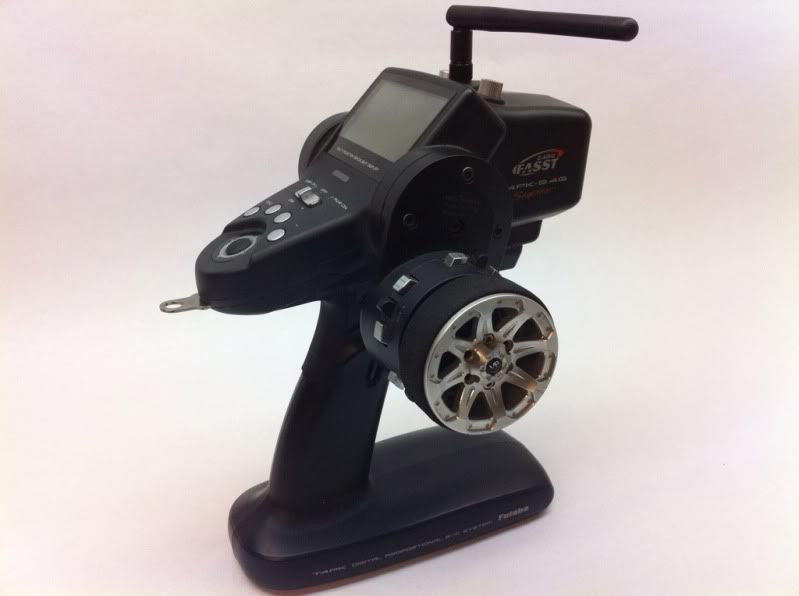

If anyone is wanting to put a VP 1.9 on their radio (4PK or 4PL) let me know. I banged out a handful of adapters last night. I don't plan on offering these for very long. I was just testing out the mill setup last night. Email me for pricing.
Uses the stock wheel's foam.

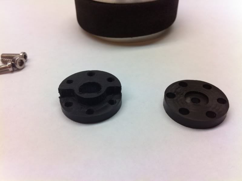

2 piece setup.
you have to drill and tap the larger piece. All holes are spotted .050" deep already so there is no guessing. Super easy.
