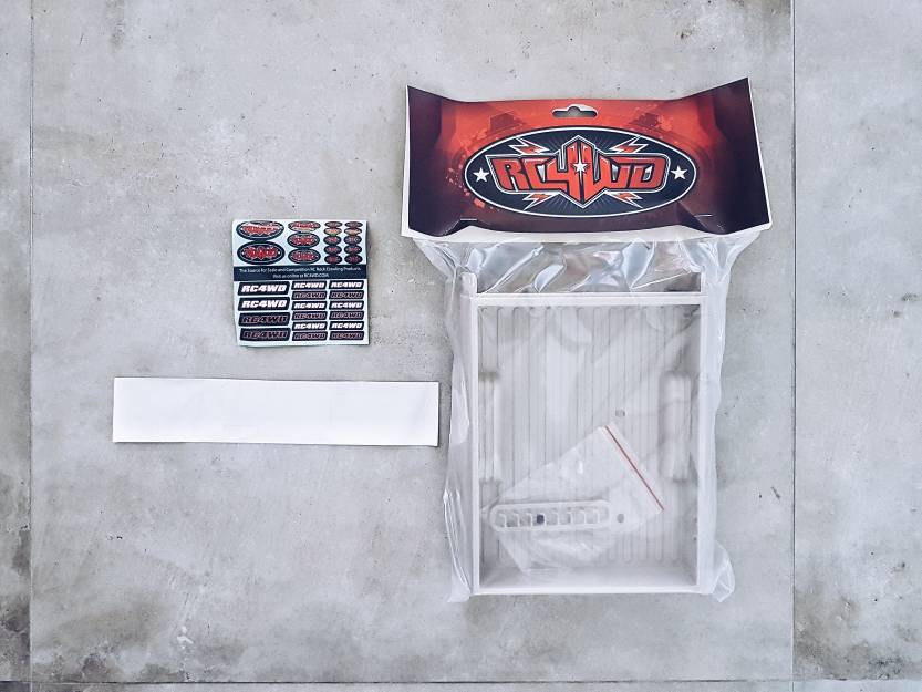

Mail day is always a great day!
I ordered a new back bed, Gelande Shock Hoops and 3k & 5k diff oil as recommended by new2rocks.
