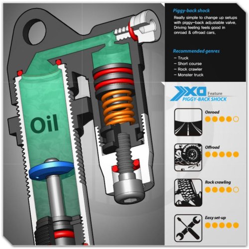

So you can adjust how much resistance the hydro lock gives you ? Fluid in the shocks should dampen as it travels thru the pistons,not increase pressure. Thats what springs do....
Does this help?

Your absolutely right. If you adjust to full pressure you will definitely get the Hydro lock. If you adjust in small increments, you do get the dampening affect. I did notice, at a certain point you will get the hydro lock. You have to tinker with them (fine tune). You do get 3 different pistons to try out (2 to 4 hole piston). I used the one with least resistance (4 hole in piston).
I was kinda being sarcastic, I dont feel inducing hydro lock to dampen is a good idea by any means.
But it is great marketing"thumbsup"
Shocks do look cool, and I bet you could work it out as to not have the hydrolock effect.
