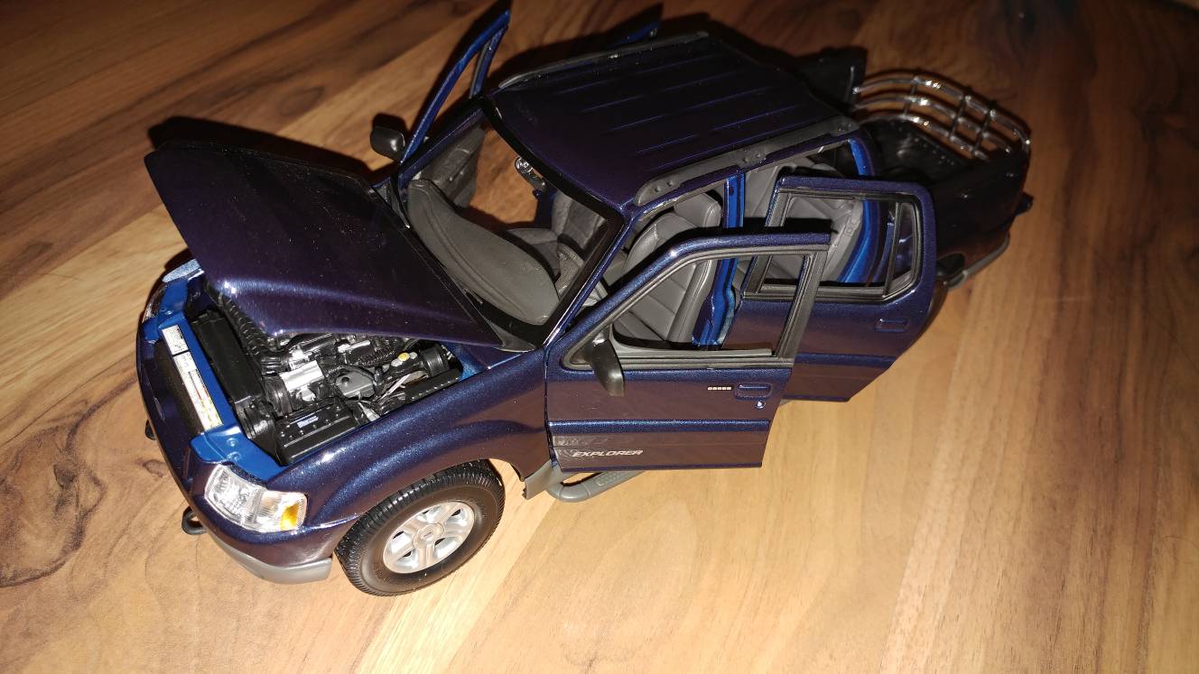

For $12 I picked up a packaged Maisto 1/18th ford. I am hoping to be able to make this into an alernative body for the G2. Although, the wheel base is slightly longer. We will see where that takes us.

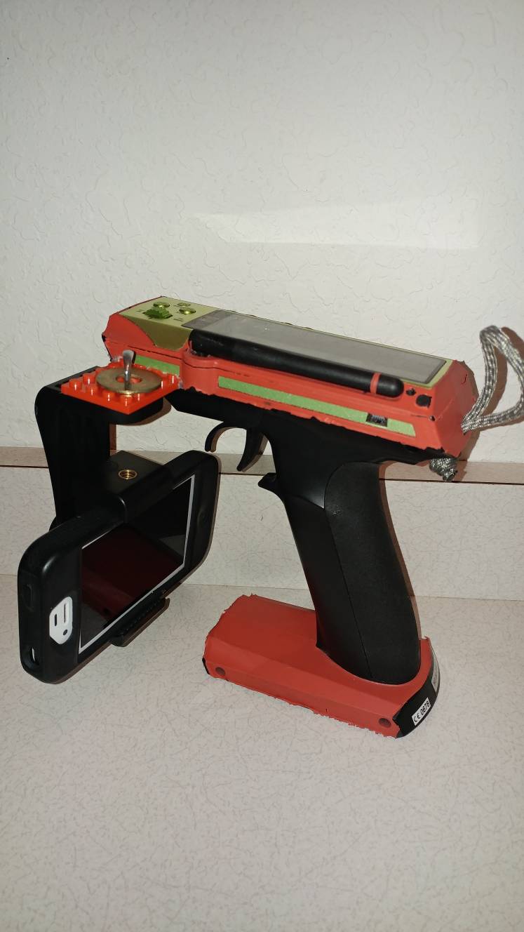

I did however recently modify my FlySky GT3C radio. It now has a mount for a camera. Very easy install not exactly clean, but I'm sure ill upgrade radios some day and ditch this one. Anywho; its simply an 8x4 Lego flat. Dremiled yhe nubs off the front half and Dremiled an opening in the Radio's body. Slid it in; glued it(gorilla hot glue//white expandable) and after that cured, I drilled a 1/4" hole for the phone mounts install.
The mount swivels 360* so the phone can be used horizontal or vertically.
Horizontally the phone is upside so the camera doesn't capture the mount in the picture.
And I can always remove the mount so it is just the 4x4 Lego left attached.

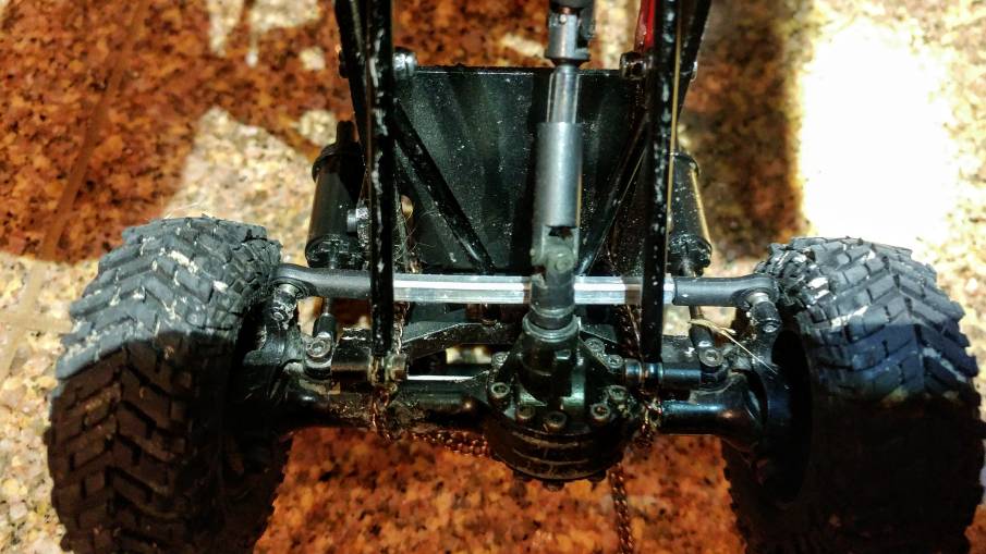

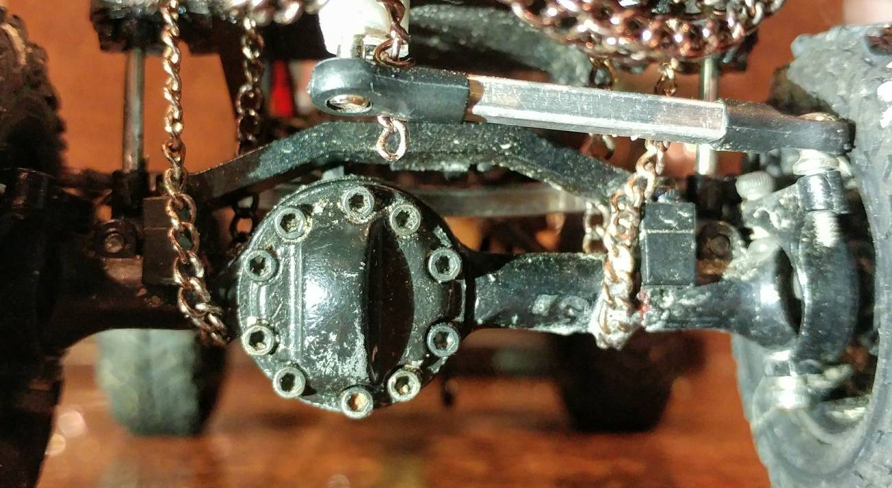

The two steering links: from the servo to a knuckle, and between the two knuckles for each front wheel.. all this has been covered in another thread I am just adding it here so the information can be found easier..
I used 2-56 threaded rod, with a sleeve of 1.8xXX aluminum stock: I used square for my steering links, circular is the same dimensions, same method.
And for the ends i used RedCat Racing Rod Ends(#24708 ) and for both the suspesion and links i have used RedCat's Long(#24728 ) and Short(#24005 ) Ball Studs.
In addition, the Long Link, between each knuckle, is also relocated to behind the driveshaft in between the Four Link(upper 2 and lower 2)
Using the Ball Studs the two links have know way to mount to the same side of a knuckle, so its gotta get moved...
The rod ends thread right onto the 2-56.
Doing these alone allow the suspension to have more travel. The Servo link here is the first to bind on extension.
I will be doing the Four Link in this exact method, either using square or round aluminum. I don't think ill make a post for those later as this method is now posted here, as well as, in many other places on this forum.

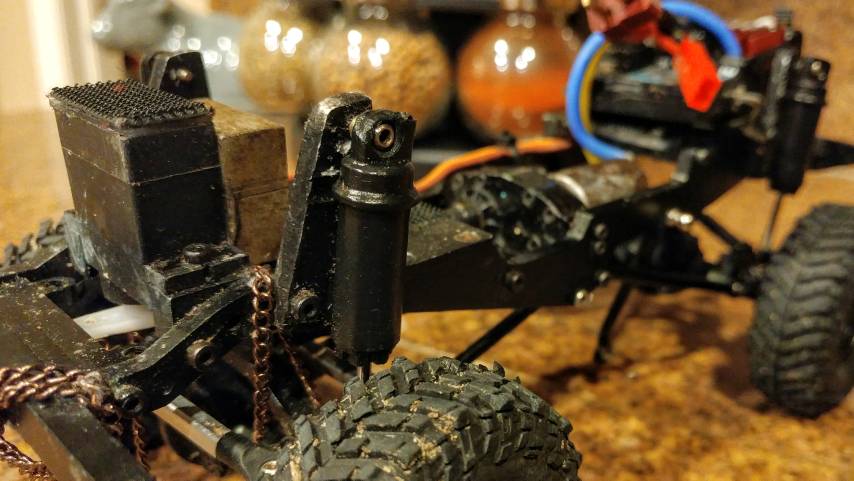

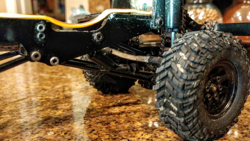

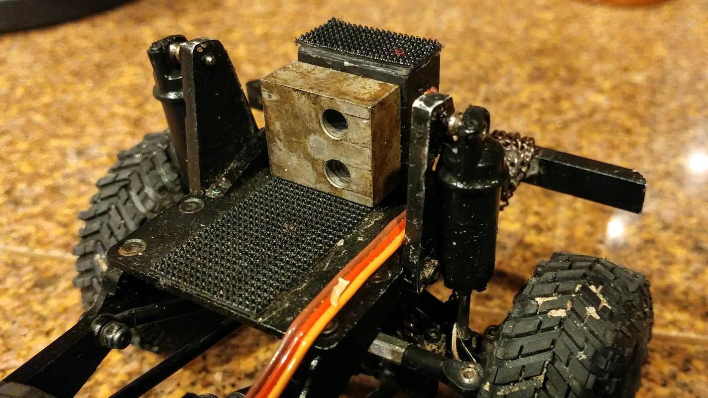

ahh good ole extended shock mounts for the new Frankensteined shocks.
so, these were easy, just time consuming to shape.
First i used 3 layers of .04 styrene and gorilla super glued them together; about 1"x2" rectangles. Made in pairs, front and rear, the two will be different dimensions.
Then I used the original shock mounts and traced the bolt holes to the pieces of styrene. Using a caliper I then measured the height I needed, 8mm, and drew a new bolt hole higher onto the styrene.
Then I eyeballed a shape, traced that and began to trim using my dremil.
and then paint it black and get ready to mount.
I used the ball studs to self thread into the styrene, still used lock tite ofcourse.
So far the styrene has been holding up well. we will see how long that lasts.
This method would work well for 1''x1/8'' aluminum.

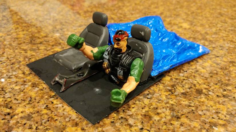

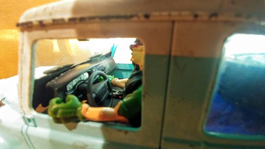

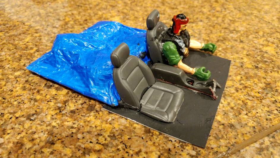

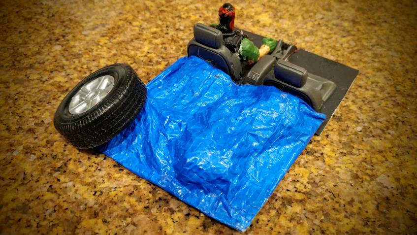

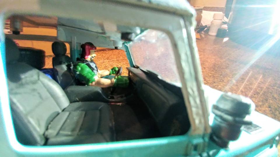

Finally got around to interior pictures and rough install.
So, the base is made of .02 styrene, expandable foam under the cut up tarp. The expandable foam pieces were lighter than styrofoam from a box...
Seats, spare tire and dash are from the maisto explorer that i posted about previously.
Driver is $1 from dollar general; he came with a passenger and two guns. The guns look decent(not shown)
Under the tarp is a cutout square so the wiring for the receiver and ESC can run their normal routes; odd shaped foam was glued around the edges
It needs to be cleaned up, and id like to add scale wood 2x4s in the rear.
But this is good enough for a quick write up.
^Not resting all the way down at the moment.. Needs some modifying and magnets in the rear.
