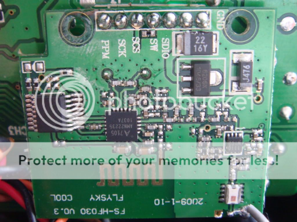

HOLY WOW.......Austin can you get me a good picture of where the antenna wire solders to the board?? Put in my VR and wire broke at the solder joint. Hard to tell what one it was soldered to. And is it one braided wire or is it like coax with two points to hook to?? Wish it would have just had a plug to unhook it each time. "thumbsup"
I know it was on RCT somewhere.... still searching it. Figured may help out some putting it here also
EDIT////// ok its coax..... looks like center of coax goes to the center of the three spots there and the outer of the coax goes to the outer (opposite the power switch) Third hole to the power button side gets nothing.
Correct???
Ok..... i think i got it...... hella small stuff. Had to pull out my fine fine point for my soldering iron. Seems to be on there (no solder bled between). Anyone run theirs with broken antenna and know about what the range is when its not connected?? Just want to make sure all is 100% here. Kinda sketched on running the 1/8 scale ofna onroad with it...... CC 2650 on 6S LMAO.
Yea the looks good, and yes there's only two wires the outer mesh and the inner, and they arn't fun to solder back on. Should i make the warning on step 4 in the vr install in a red bold print?, instead of just bold
Im sure it would help out someone...... Ive torn it apart a bunch of times and stupid me pulled top cover and flipped the board around forgetting about it. I guess remind people to pull the top cover and not the board over the antenna :lmao: Im sure the solders were not on the wire all that well due to the wire just snapped off right at the solder joint. Was easy (easier than i thought i should say) with my small point tip and Trak Power @ 600 deg :mrgreen: Just stripped coating with blade..... separated them both and tinned a good deal. Then carefully soldered away
