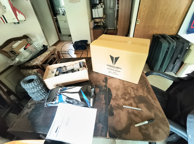

Mine just showed up on Tuesday, it was already out for delivery when i noticed the shipping notification. Mine is number 207.
I haven't assembled much yet just a few wheels and mocking up a few panels.
I added the IFR rings
As you can probably see I really need to clean up my workbench before I really dig into it.
