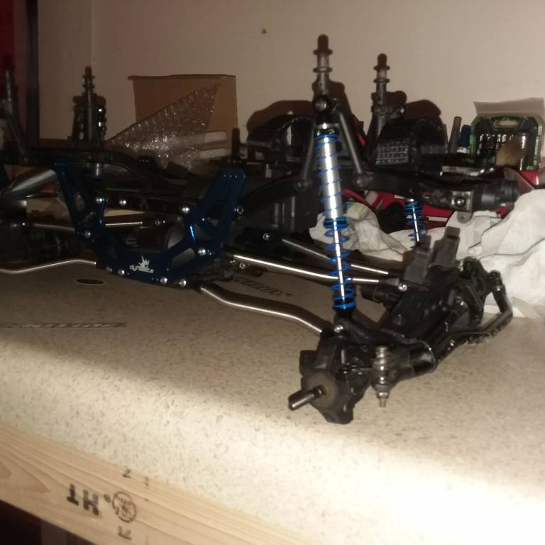

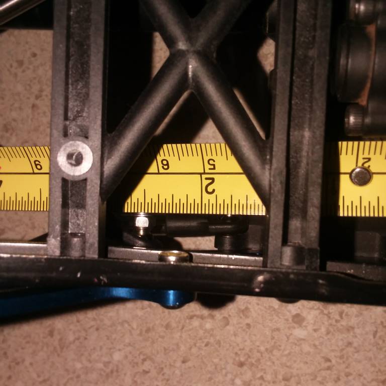

Hey john, ive been searchin for a BL motor n cant find quite wat im lookin for. Could u please help me out. Im lookin for a low kv, non sensored, 40mm dia max, 55mm long max, 6mm bullets. Shaft doesnt matter, either 3 or 5mm will work. 4s if possible. The trans im running is the scx10 3 gear. Im buildin a solid axle monster truck from a scx10 chassis and ar60 axles. I have metal axles comin for the build. Thank u for any n all help, very much appreciated!
Heres pics of wat im workin on if it helps
If you want brushless non sensored and low KV there is only one option to consider from Holmes Hobbies
Sent from my SM-J327VPP using Tapatalk
How low is "Low" kv? I have some prototype 4053 size motors that won't be making it into production. But a puller 540 standard also makes pretty big power, it goes down to 2200kv currently.

Thats bout wat im lookin for in kv. I think i can get by with 60mm long max. Id like to b able to run 4s. Like i said before, im buildin a solid axle monster truck with ar60 axles. Im sure i probably dont need 2200kv or 4s, but wheres the fun in goin small lol. I seen where aaron from rcsparks put one of your 3500kv sensored in his mud truck. Im goin for the bigger tires n im using a scx10 chassis with a ax10 chassis for the lift. It more of a go fast than a crawler build. Plus ive got a leaf sprung project im workin on as a crawler. So ill be lookin at gettin your trailmaster 550 21t. Got one in my scx10 ii n love it. Thanks for the reply back an all the help n info, very much appreciated!
