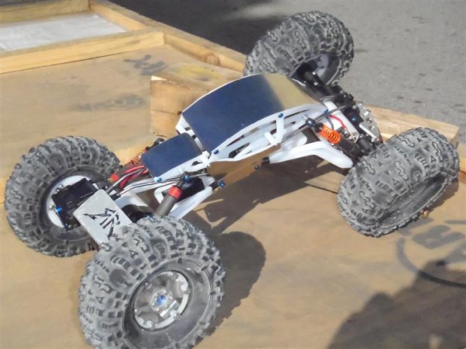

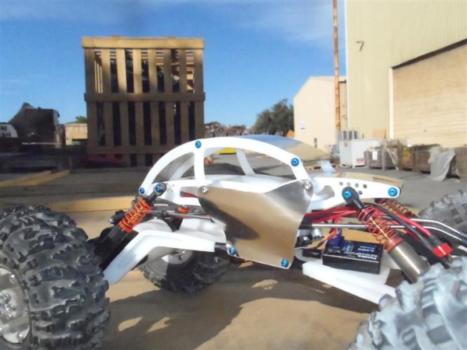

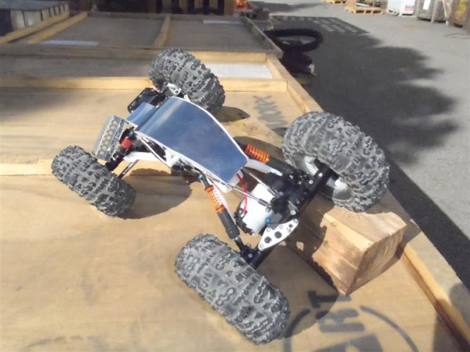

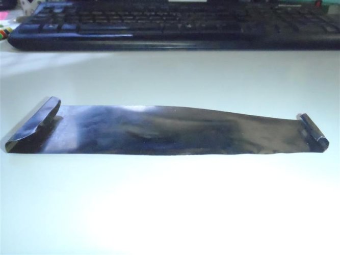

Skins are done and mounted, again I went for the 0.125mm stainless steel. Notice anything different about them? Its a little something I picked up from DickyT. Before here defected to the Berg side:flipoff:

Panels look sweet! Im guessing your talking about how the top and hood panels are held on.

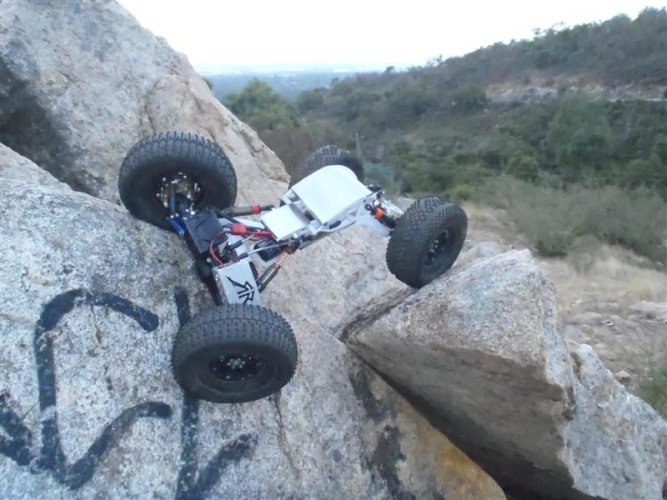

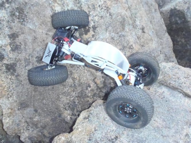

I had my thing out on the rocks last night for its first run. So far I am satisfied with its performance, it is not quite as good as the Manits for my eyes yet but there is a lot more testing and tuning to go into this. Before I can make any kind of decision. There was a couple of lines the Thing was able to do that the Mantis has difficulty with but there were others that the Mantis does easily and thing struggled with also (not just break overs). I have just been reading through jcboof's posts in Kratos' thread and think that I may need to move my rear links down one hole. As it tended to flip backward a little too easy.
I ran it last night with my Khaos Rovers on 1" VP SLW V3's and Dlux Knuckle weights. I need to get some longer hubs before I can use the D Lux Wheels with out them scrubbing on the Servo.
When I got home from the practice. I removed the OG rowdy Racing Battery mount and installed an I think its a Big Ron CF battery on motor mount. I found the large RR mount was catching on under hangs way too easily.. So we will see how that goes. I had to shorten the skid by around 2.5cm (1") for the new battery mount. I've also decased the BEC and Rx and condensed them into one package. To fit onto the newly shortened skid.
Sorry guys no video of the outing as I did not have my tripod or girlfriend to hold the camera. So a few photos will just have to do.
