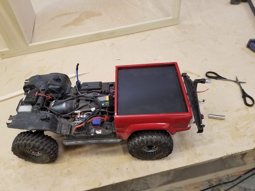

I’ve been wanting to convert my main trx4 into a pickup for a while now and with the help of a wine night and some partially aware late night shopping I had the body and some other goodies delivered yesterday.
Here are some pics of the mock up and the current state. I was able to originally have the cab sitting fairly low on the chassis but the bed is another story. After crudely cutting holes for the shock towers I was able to get it seated to the point where I was okay driving it but still want to get it lower. As pictured I had to lift the cab up a little higher to keep it in line with the bed.
If anyone has any tips or ideas here please share.

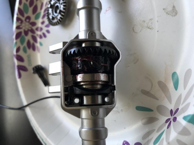

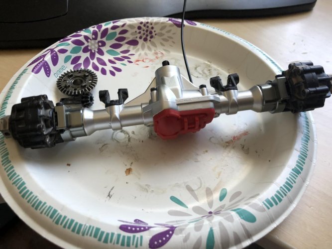

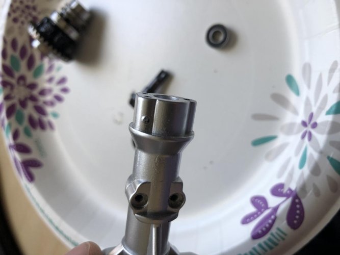

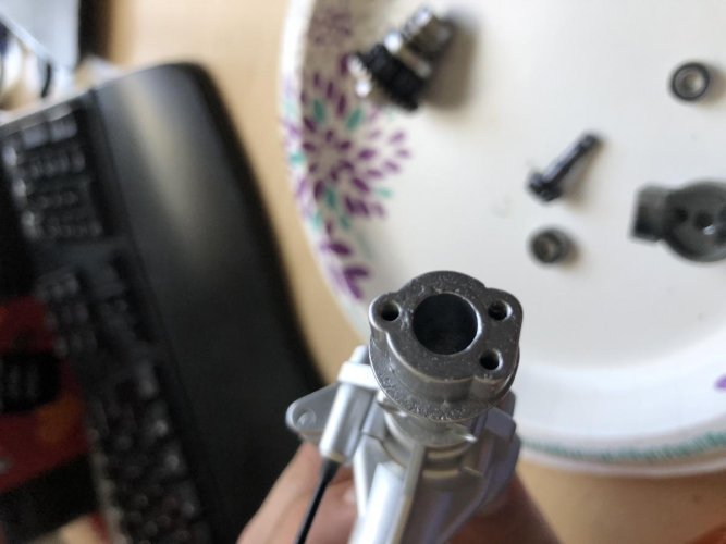

The steel alloy axle housings from xtra speed added good weight but there are flaws in the finish and some of the tolerances were very tight and took some finangling to get the bearings situated and the rod ends in place. They were cheap, less than $40 for the pair shipped from China if I remember right, but I can’t reccomend them due to the fit and finish issues and the prospect of returning a defective item to China isn’t anything I’d want to go through. See attached pictures (better quality than Imgur) for examples of the finishing flaws and a couple pictures from the completed rear axle build before I added the spool.

Truck looks great and I love the 4.3” Pro-Line Super Swampers! Tonneau cover to get bed lower or Ascender or SCX10 rear cage. :)
Thanks Nate!
I thought about going to a hobby lobby or something similar to see if I could fashion together a tonneau cover, does anyone make a scale version that looks decent?

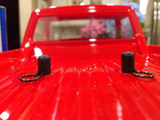

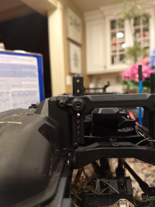

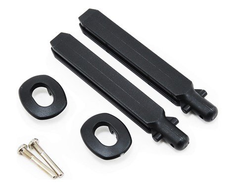

I've attached a few pictures of my trx4 in its current form setup for the comanche body. I used the Traxxas X0-1 rear body mounts they fit well but will need some customizing. After mounting them up in stock trim they still weren't low enough with the included "ring," that attaches to the mount.
The round piece that supports the plastic c-clip acts as a nice guide for drilling a new mounting hole. Brought it over to the drill press, put them in a vice and went for it then shaved off any material left over. Kind of tough to explain but hopefully it makes sense.

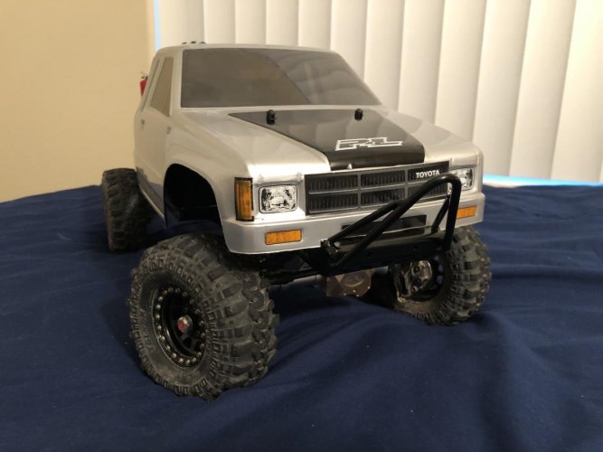

The truck crawls much better with this latest update. I’m really happy with the smaller tires, it goes vertical more confidently and I didn’t have any real clearance issues.

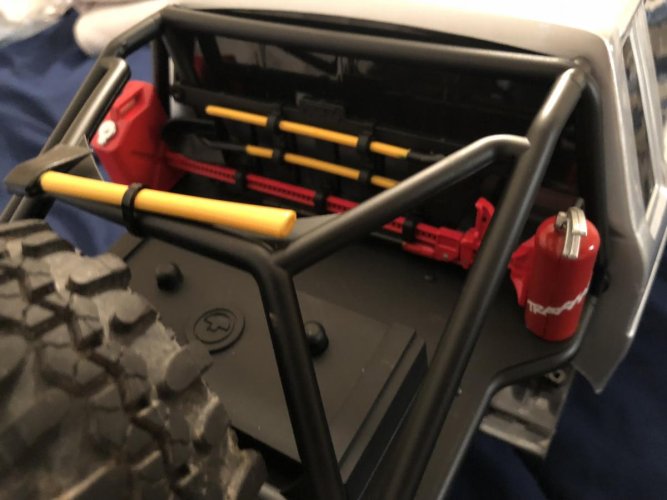

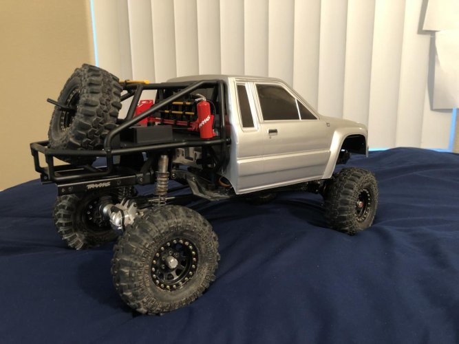

I ditched the bed and installed the new proline cage. I like it so far, I don’t like the spare tire weight but will probably just keep that on there for show and take it off on the rocks.
Added some scale bits and a werty made stinger bumper as well.

Looks great bro! I really dig the truggy look. When I decide to do a new body I'll be doing a truggy. Will be building a custom cage tho. Keep up the great work!
I really like the proline cage That fuel cell and spare tire location are awesome.

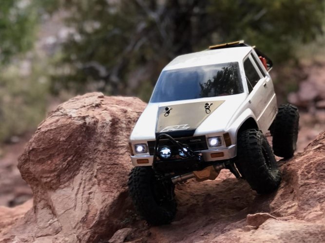

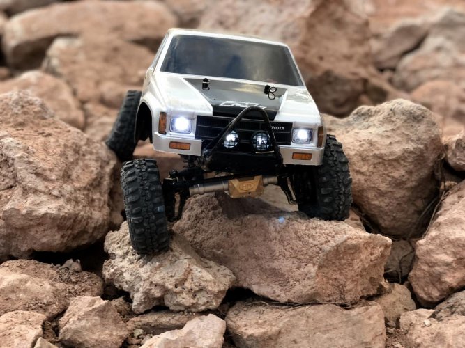

Staying busy with the TRX4. Most recently added the super shafty mip driveshafts, these are great. Smoother power transfer and they are much quieter.
I also added the traxxas orange springs up front and switched to a 20w shock oil. I rebuilt each shock as they were still sticky. After removing the O ring and adding a little oil to it and bleeding them again they were working great.
I also added mirrors and wipers, but the mirrors didn’t make it past the first quarter mile of the trail.
I’m pretty happy with it at this point. I’m looking to get my hands on a promodeler 470 and if proline comes out with 4.3” swampers in the predator compound I’ll be all over them but other than that it’s time to just drive. Matching spare is on the way.
Here’s some pics and a couple videos I shot. The second one I used some wheel speed, the under and overdrive gears help keep it from pushing itself over.
