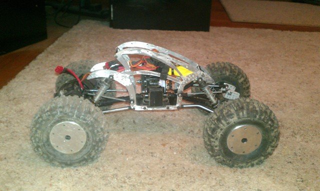

All Four Complete Finally
Also made the chassis. Not quite as polished and nice, but gets the job done.
