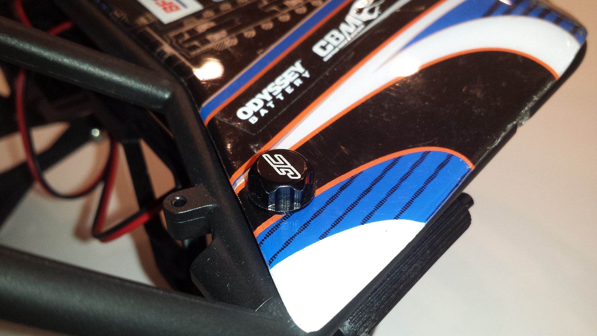

Use the Axial fake wheel hub caps.

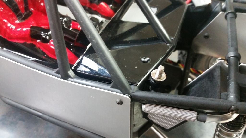

Cut off body post top.
Use 4mm x 20mm setscrew or screw with head removed.
Drill out body post. I used 1/8 bit.
Insert screw.
Screw wheel hub cap onto body post!
I did this mod today. Removed the hood pin mounts and drilled the hole out take an m4 up through the tab put a nut on top and then use the proline tops that I had and works like a champ.

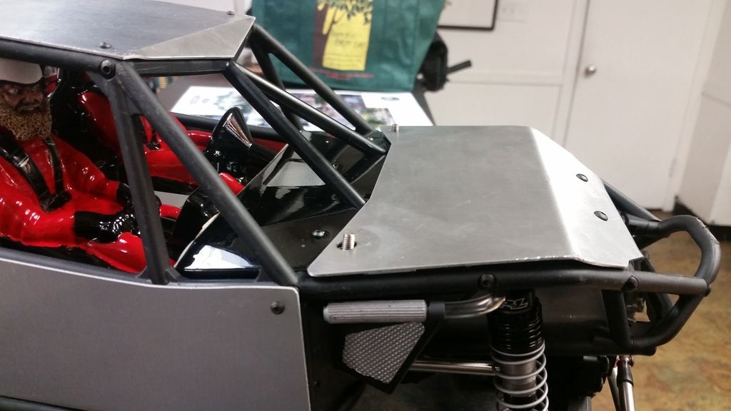

Interesting! My Bomber needs something like this too... the aluminum hod is too thick to use the push pin, so only the battery retainer is locked - the hood claps freely at every jump...
