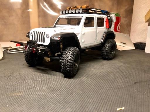

Hi everyone,
I had seen some mixed reviews of the hot-racing aluminum shocks for the scx24, but liked their look so thought I'd give them a whirl.
When I first installed them they looked cool but were far too stiff & springy (with the firm springs, the soft ones could barely support the weight of the body).
I added some green slime to the piston/cylinder, partially filled them with 30k cSt diff fluid, and after a few hours of break-in they’ve softened a little and I’m loving them.
I made a short slow-mo video to show the dampening etc: https://youtu.be/gsGk1rjfy1I
They really give it a scale look. It’s not bouncing like undamped suspension.

From the looks of things, way less bouncy. i know they utilize a fake reservoir like factory shocks. Is the damping way better than stock even using the same mods to fill the stock axial shocks? ive got 2 jlu running factory shocks using green slime and heavy duty ball joint grease from my truck getting similar effect. Did you happen to run the soft springs with out your scale body with weight? Just wondering since i had planned to by a set of these or 3 and not load it down with scale accessories. So wondering how they are overall since ive got them and a c10
I think with stock weight they're not a huge upgrade over modded stock shocks (besides the looks/being aluminum), though I didn't run mine stock for very long. The main advantage I found was that the stronger springs allowed for more dampening before they'd start to "stick".
And yeah the soft springs were bad even before any extra weight - they could barely decompress on their own once dampened even off the body.
