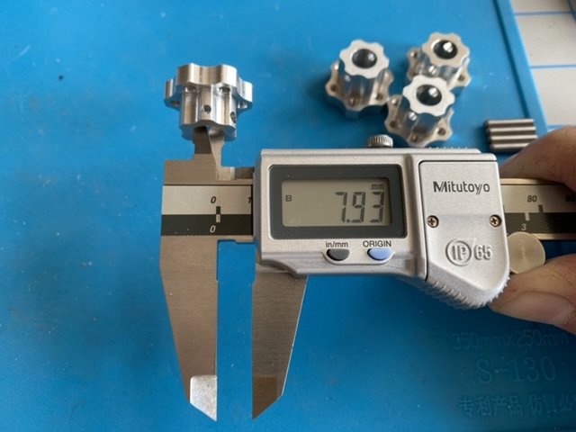

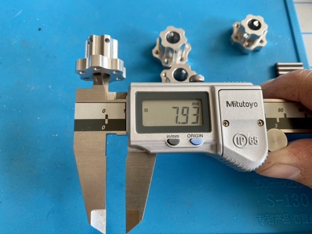

After measuring and contemplating, I found out that the issue was the hubs not the axles, and even though it makes more sense to modify the static part I drilled out the hubs instead. Easier, quicker, and the actual problematic part, but it could be an issue later if I end up swapping hubs… Oh well, done now.
Since the shafts actually measured 8mm (.315) I ran an O drill (.316) through them and they fit nice now. Surprised to see they were almost .003” small, no wonder they didn’t want to fit!

Hi Kevin! I wonder if it was an issue with a single lot from a supplier or if all the new ones are that way?
I am liking the new beefy 3mm pins. I didn’t see a lot of 2.5mm pins break on their own, but I know they could be bent from tightening the set screw down too tight, and if not tight enough they come loose, slide out, bind up and break…
I still like to use blue loctite on the set screws to help keep them in. I usually run solid face wheels so it is not convenient to keep tightening them…

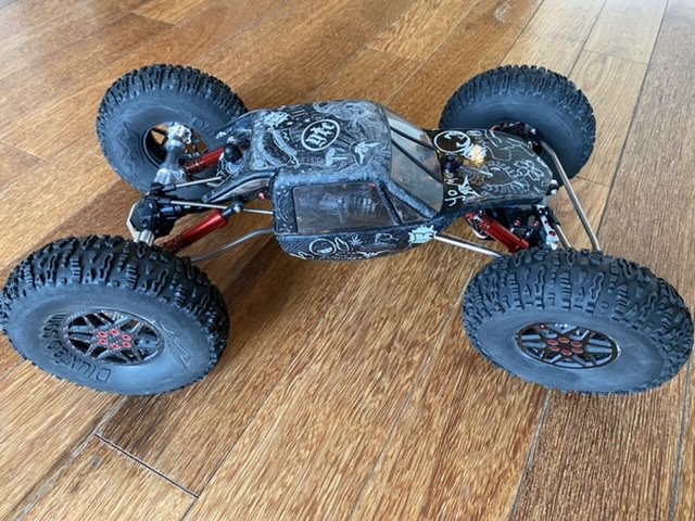

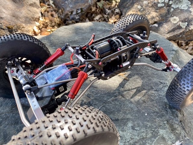

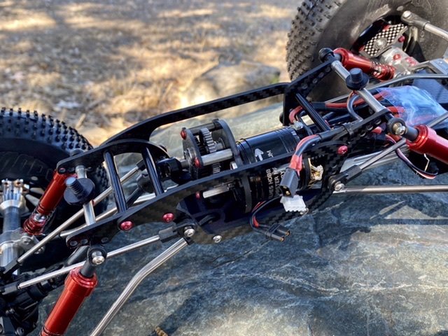

Mocking up some bodies to figure out a cut pattern.
Figured you guys would get a kick out of this one, eh? :mrgreen:
Long live BC Paints!

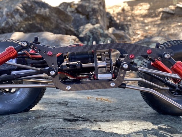

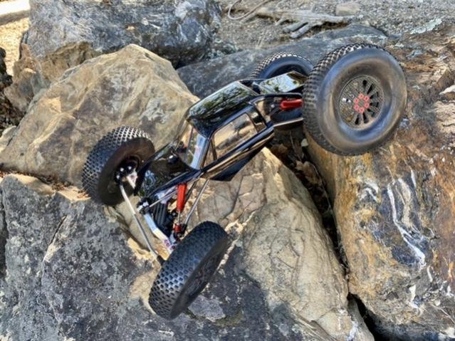

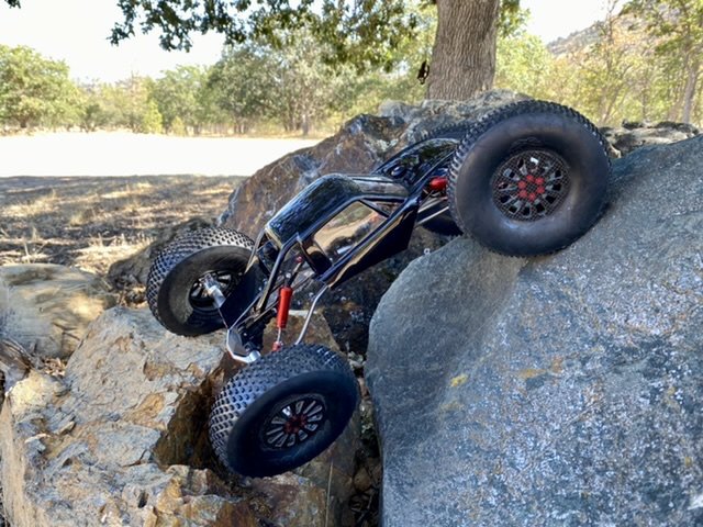

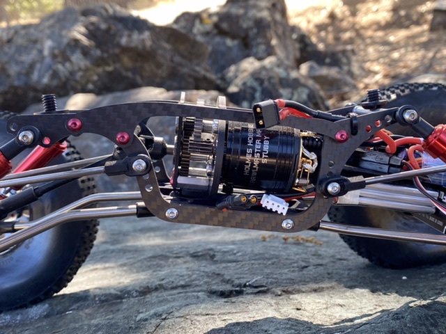

Finally got it out for a quick shakedown run. No issues so far, seems pretty solid. "thumbsup"

Sweet color scheme, damn thing looks like it could crawl upside down [emoji1303]
This body’s cab is too tall for that, maybe with one of the newer styles or 1/18 scale but I cannot stand the disproportional looks of that. I know, function before fashion, but I just can’t do it… :ror:

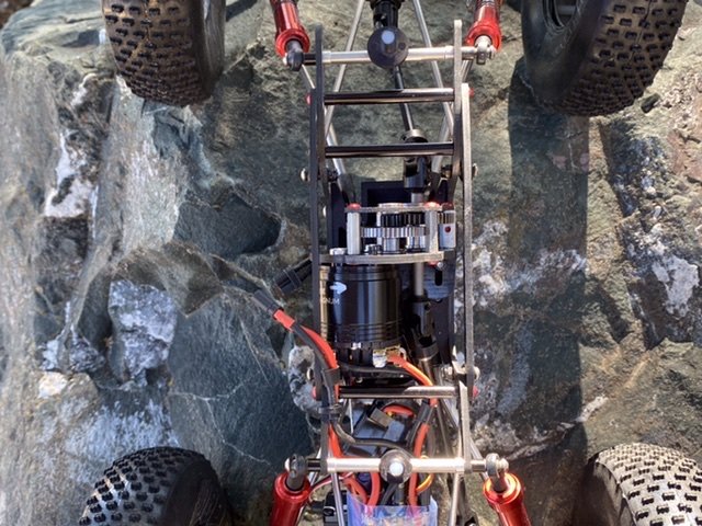

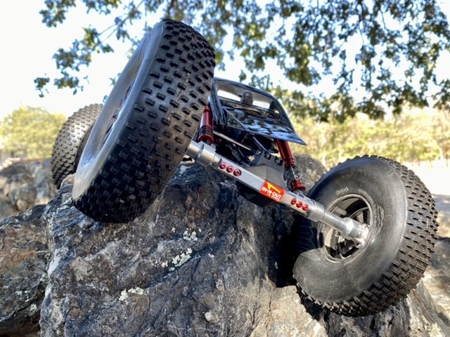

I’ll have to take a few bodiless pics to show the final result as well.

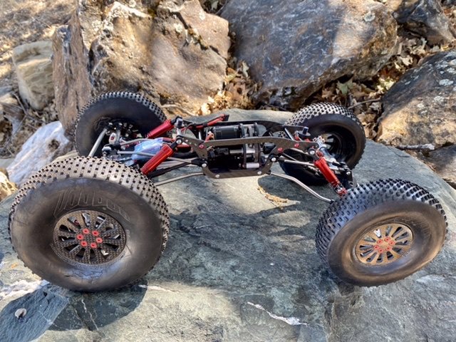

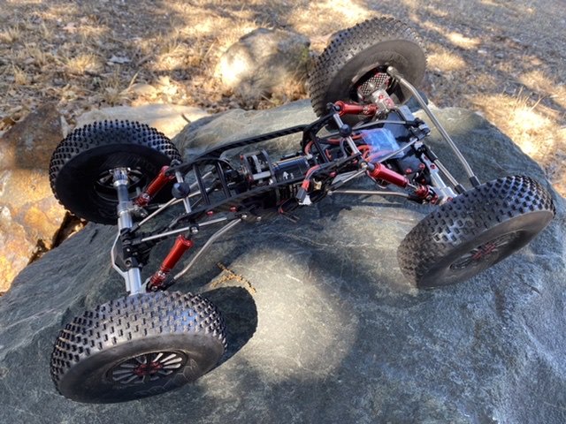

Here are some naked pics for your viewing pleasure…

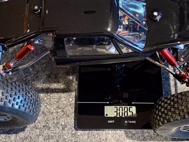

What was the final weight?
Just a hair over 3.5 lbs. :shock:
That is RTR with tungsten loaded knuckles but no loaded dice hangers on it.
I will most likely run it with them, but that will still be sub 4lbs IIRC.
