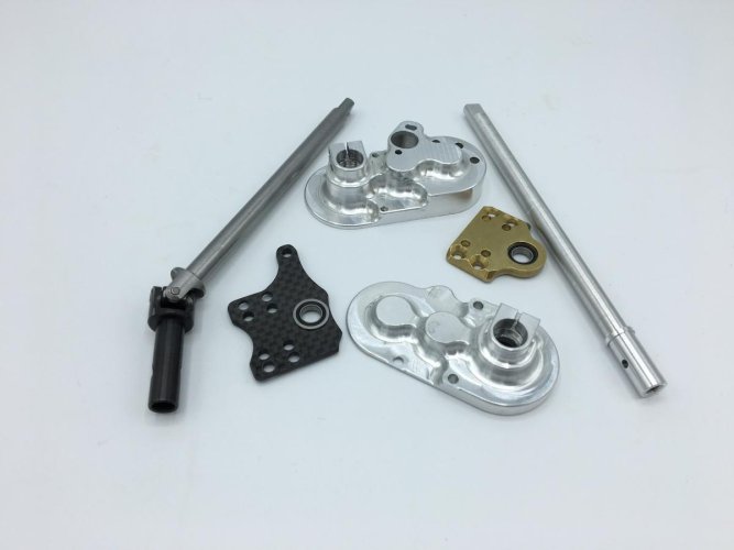

Thanks guys, I know that this isn't all that exciting since I have already
made these parts fit together on my other car and have been driving it...
With that being said I really like my car the way it is and don't want to change
it and not like it, so I figured what the heck, I will just build another one.
Besides, one can always be an emergency parts rig for the other at a comp.
Those who know me have seen that I have had some "interesting" failures
over the last few years. I think I have fixed most bugs, but since I am doing it again
I figured I would share...
No need to build a second car when you know some schmuk to steal an axle from if you break in a comp. :lmao:
The axles are pretty groovy, how thin are the tubes at the case with them #BAMFA shafts?
Yeah, right!?!
I have yet to make this set, but they should be right around .047 Wall which doesn’t
seem to be too thin if you are using good material... Hopfully they hold up.
The shafts are .275 dia and the tube thrubore is .281 with a .375 OD.
Gawdammit I'd break them right at the case for sure, but I am a ham fisted moron. I tend to jump things with my pro so yea. :lol:
Erik was complaining about my motor not making any power compared to his. Then I reminded him I run 4s, kinda different ways to go about the same thing. I'll upgrade this winter and still run 4s so it'll be even dumber.

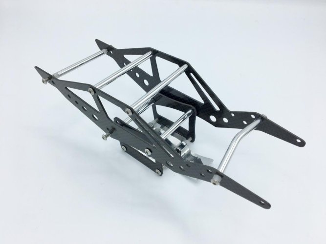

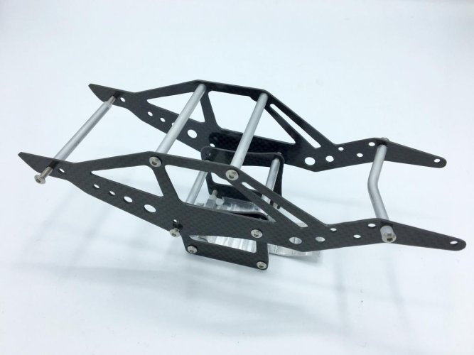

Machined aluminum and carbon fiber...that's a sexy start to a build!
If it’s anything like the other one I’m sure it will be awesome, Let me know if you need my address
Thanks man, I have always been a fan of your rigs. Always top notch.
I do need your address so I know where to send this thing for you to tune it once it's built! :ror:
I think they should all come this way, what do you think? 8)
I know, I know, function before fashion, right?
Well maybe it will slide on the rocks better now...

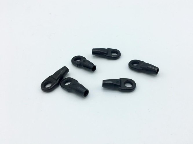

Just a friendly reminder, if you want tapered rod ends just go to Dlux Fab and order the sliders for $12.
Don't take the time to machine them. I did this over 6 years ago and forgot how miserable those little ******* are...
I couldn't keep revo ends alive so I switched to jato length from rpm. A quick trim with a dremel and a little drilling with a 3/16" bit so there is a shoulder over the link keeping the transition to threads strong and they're solid.
Nice, I will check them out, thanks.
As far as standard Jato ends I will never use them on a lower link after watching two fail back to back last month... :shock:
Just my 2cent I've had good luck when using jato rod ends.
Out of curiosity who broke 2 jato rod ends back to back at BOTW?
Dooley did. His new car was a bit short so he used two Jato's to get it out to spec.
Broke one on course, thought it was a fluke, swapped it out, broke the new one,
went back to Revo ends and finished the day! Maybe a fluke? Who knows. My kinda luck!
Maybe my curse is finally broken and he contracted it! :ror:
I've had to source as strong as parts as possible and the rpm jato trick has proven itself on my bomber so I call it good. :lol: just need to set the drill depth correct so you don't drill too deep and pull the few threads left. I did exactly that and pulled an end off the tie rod. Shoved it back together and finished the course but I got lucky it held.
As for Dooley breaking them I'm betting the links were bent so the jato ends saw an angular load and not the typical push pull along their length. Go ahead, ask ke how I fingered that one out... :lmao:
