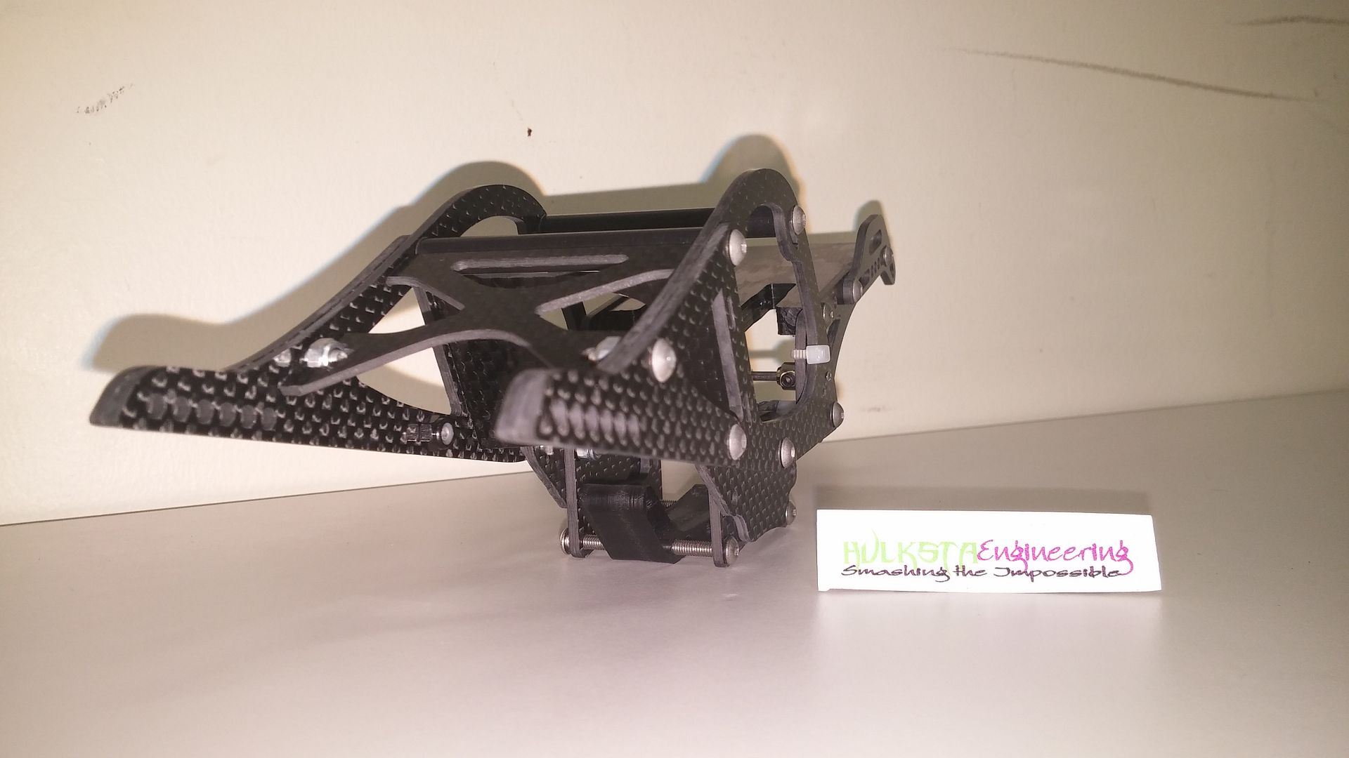

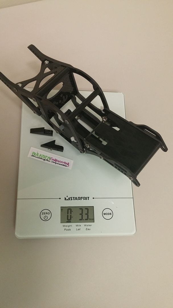

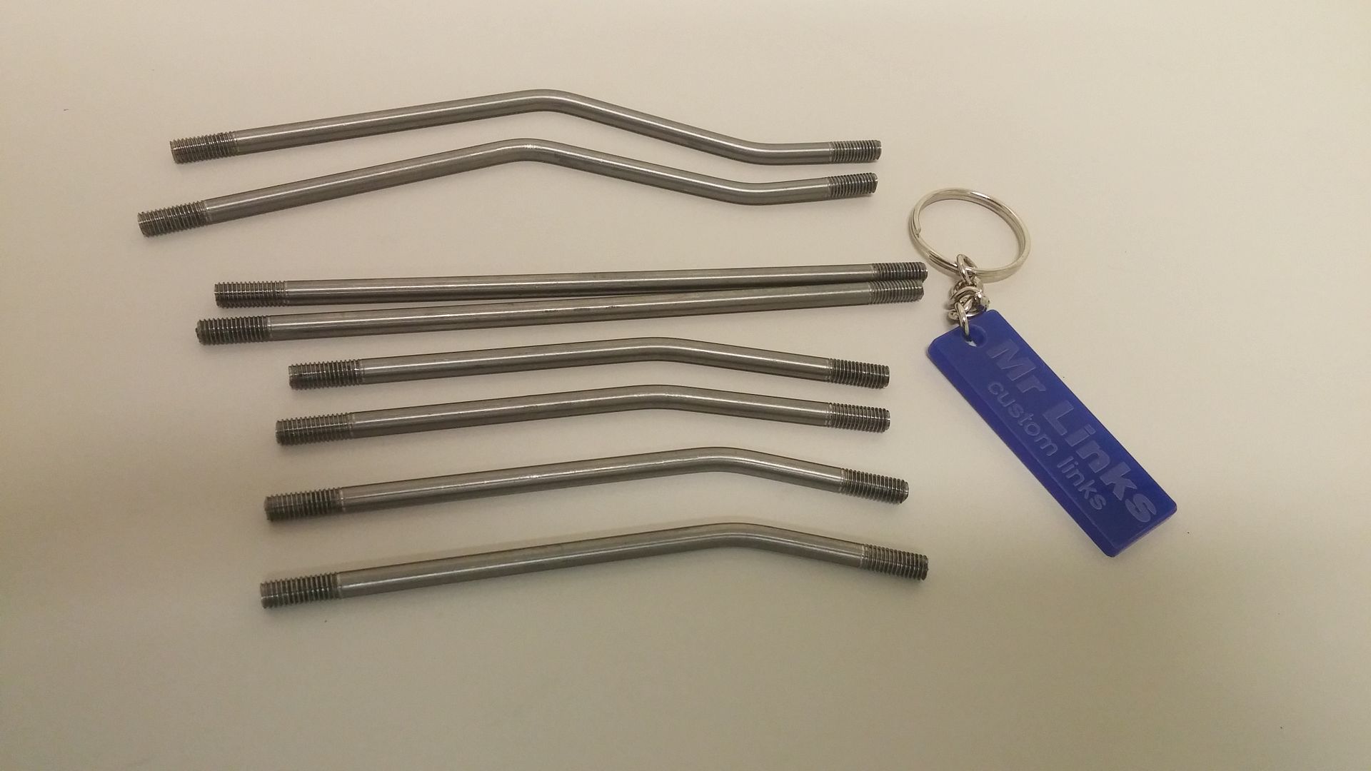

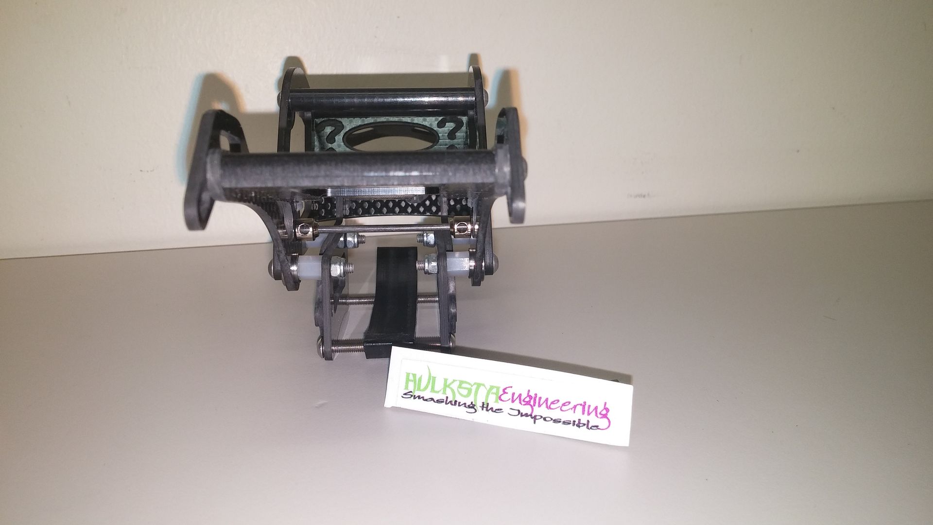

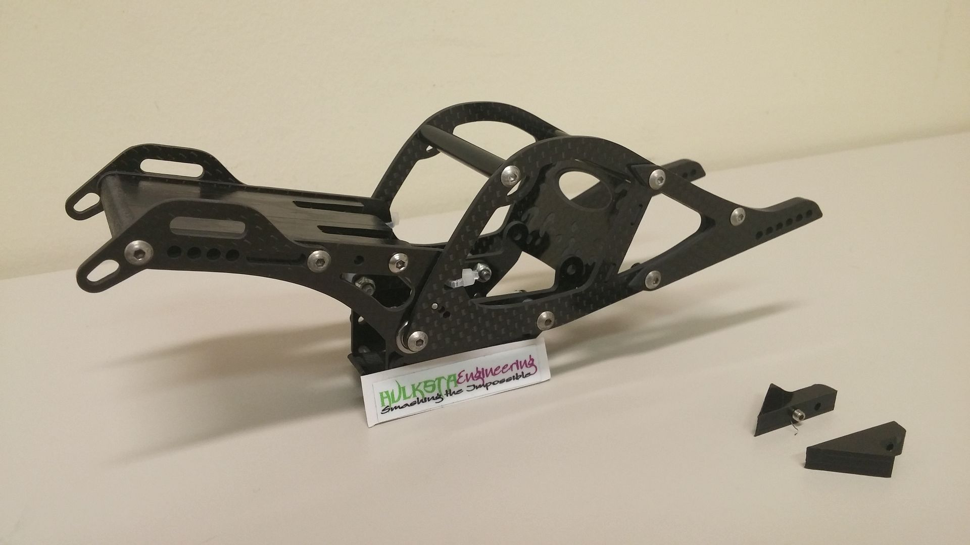

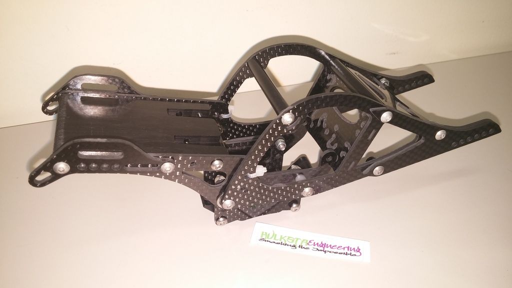

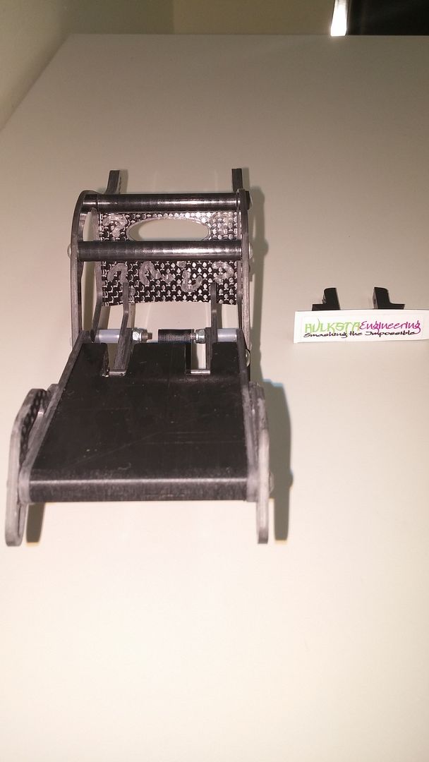

Look wath showed up this morning...
A beautifull piece of engineering...
A big thanks to Daniel @ Hulksta Engineering and Greg @ Mr Links..."thumbsup"
Hell yeah... Thx again Michelle... An alien spaceship look-a-like for an out-of-space chassis...
