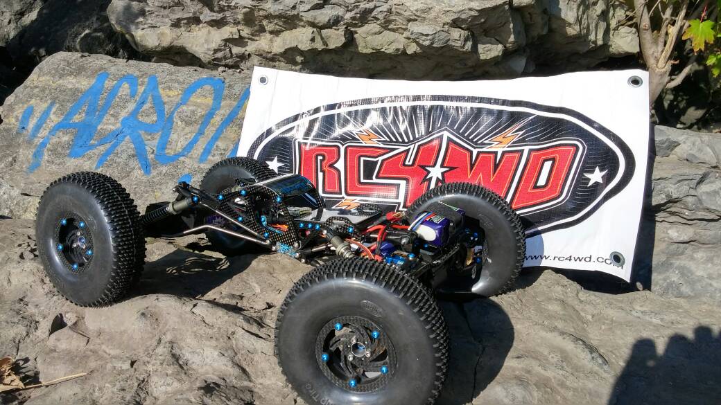

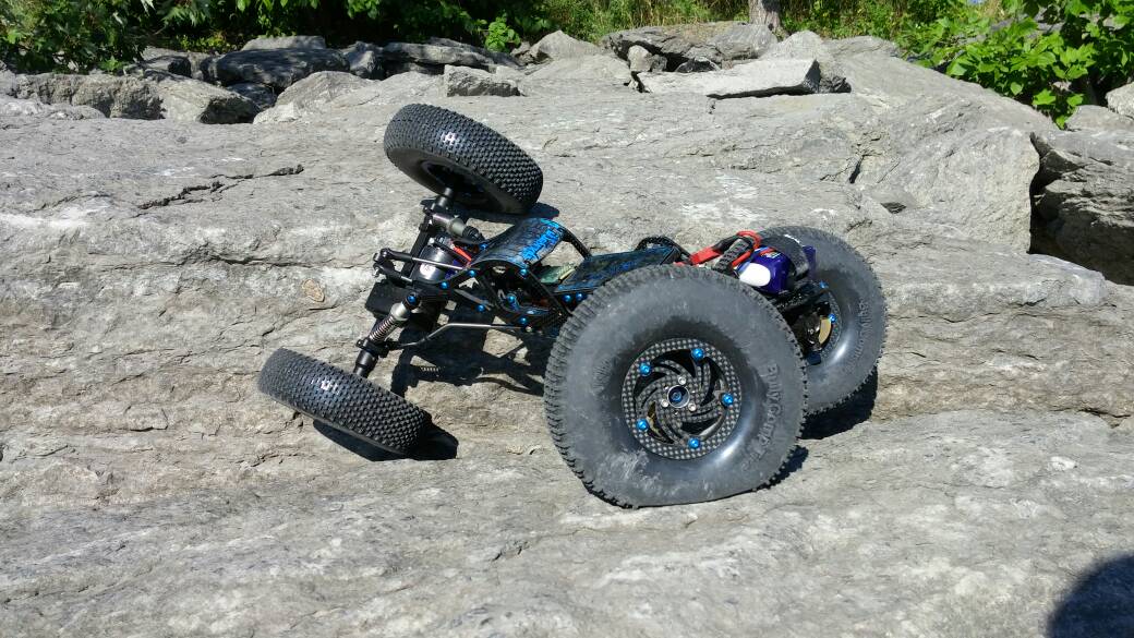

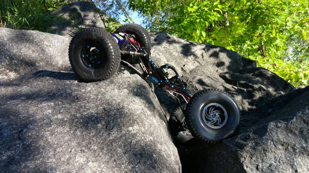

1st test for the Riddler Pro... Only 2 packs because of a small breakage...
But still, can't wait to get back on rocks for more tests...
#RC4WD #bully2 #RiddlerPro

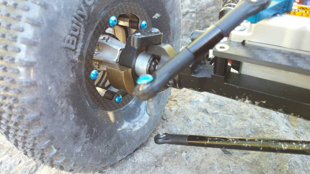

The screw broke at 2 places and is now stuck in the knuckle arm, Damn it!!!
Envoyé de mon LG3 avec Tapatalk
Since theres some threads on top, use a dremel with cut off wheel and use a flat head screw driver. If its got loctite, heat up your soldering iron and put it on the screw under the knuckle.

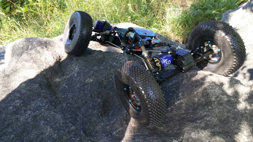

TGN beadlocks installed...

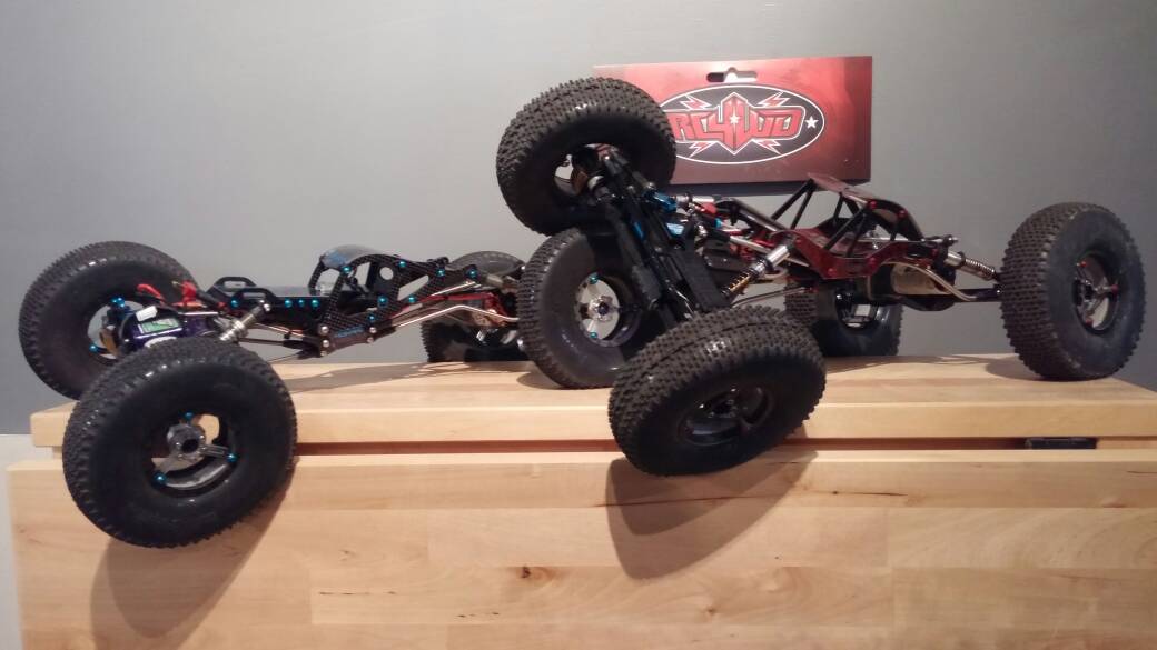

My Riddler Pro vs my Remedy 3.5

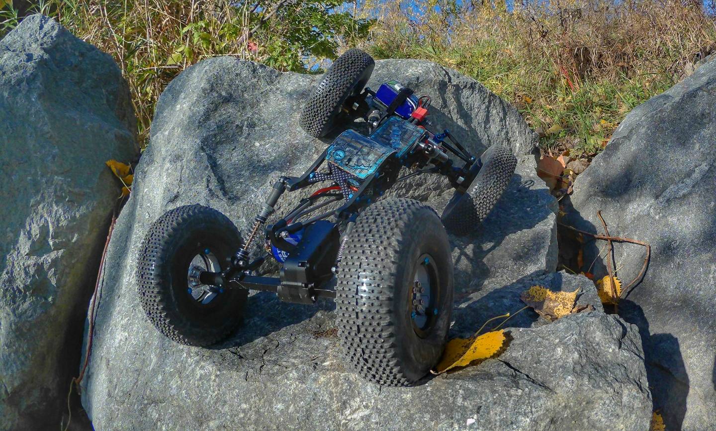

Its been so long since I took out 1 of my comp...
Them I love those...
I fall in love with the hobby again and again each time I run 1 of those...
