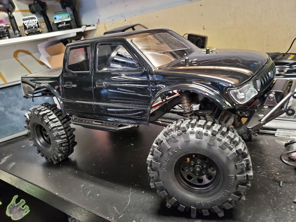

I got everything ready to go, or so I thought. I just painted the new body and plugged everything in, and I've got no steering.
A few weeks before I took it apart, I had the same issue. I thought I burnt out the servo, but decided to test it after I had the other one installed.
It was fine. The only thing that's changed is I put an iq link in my transmitter.
