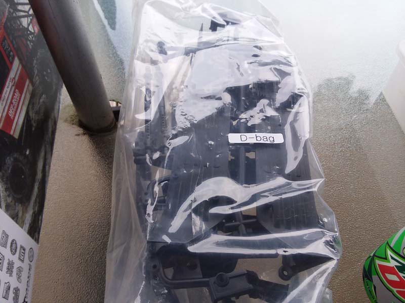

Starting off with a box shot of course... showed up on Saturday along with some SSD brass knuckles, Traxxas X-rings and some shims just in case. The Mountain Dew was already here and is a poor substitute for Leinenkugel.

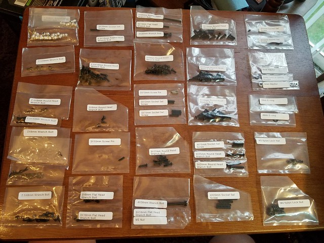

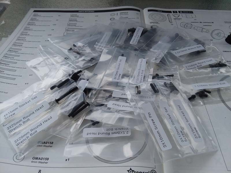

All the screws for the kit are separated into tiny bags, not with the other parts for each step. Not sure I've ever seen this before. For each step, you have to hunt through and find the screws you need. Unless you have several tiny bins, it's kind of a pain.

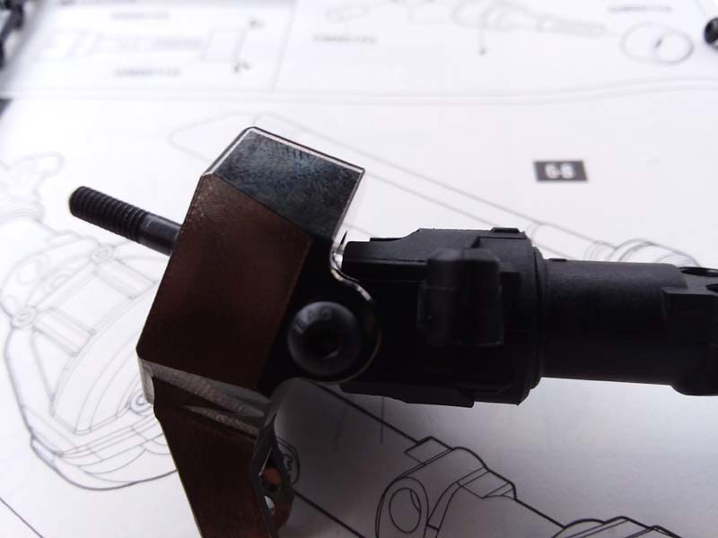

Bolted on the SSD AR44 brass Knuckles and found that I had about 20 degrees of steering. They bolt on fine, but the shoulders/stops of the C-hubs restrict movement..hmm..
I took a chance and ground down the stops on the C-hubs while watching the Brad K show/wreck fest at Vegas. Don't think it compromised strength any, but time will tell. I did add a 3mm washer to the top of the C-hub as I had a pretty good gap. Now fits perfect with no play, and plenty of steering angle.

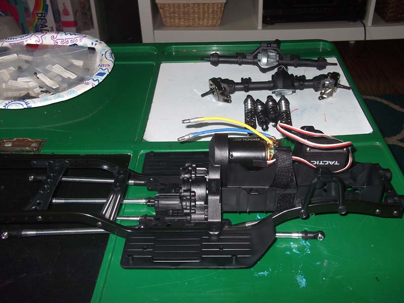

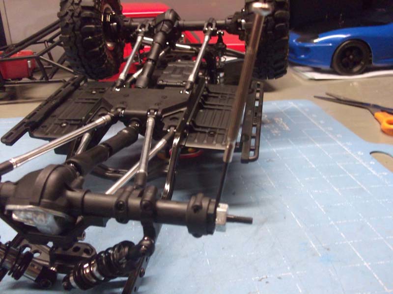

That's where I stopped for the night. I got both axles assembled, and the gears are very crunchy as others have noted. More crunchy than I'm comfortable with. I expect a little crunching as the gears wear in, but at certain points I cannot turn the axle by hand. Made sure not to over tighten the bearing caps, and not sure where else to buy some clearance, so I'll just let them break in I guess. We'll see if they loosen up after a few runs..
