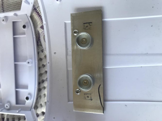

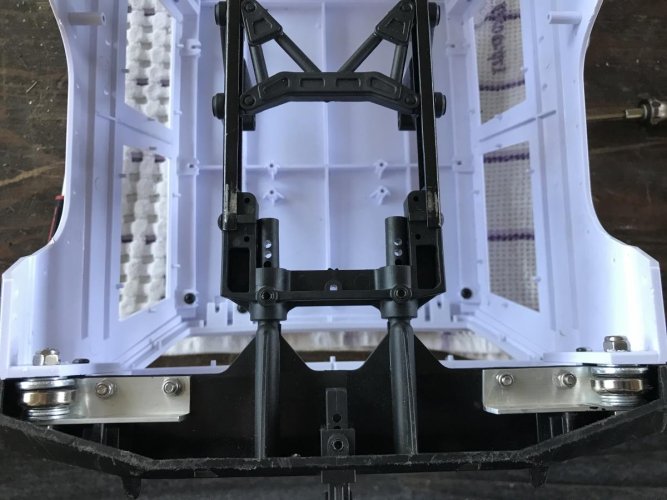

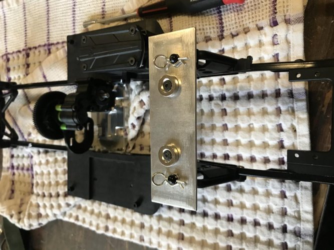

Here is where I’m at now. A buddy had a great idea to mount some aluminum to the rear bumper in a prime spot for attaching the body either via magnets or hidden body posts. It’s a thick strong part of the body, so I think this could work very well.
the front is pretty straight forward, just will be mounted with magnets
Great solution!!!!
This is one of the biggest reasons I bought a 3D printer, making brackets like these is done some much easier.
