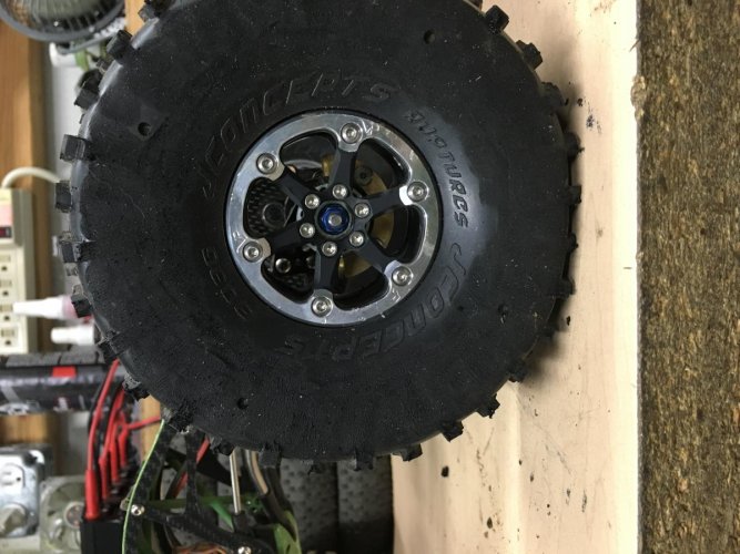

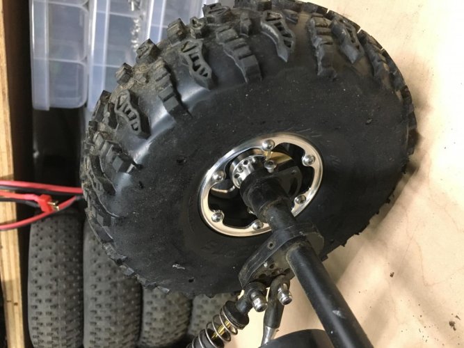

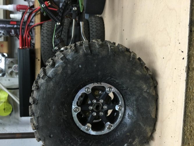

Haven't tried them yet . I have only worked on the fronts mounted them on Slws with 6.0 soft DD foam and shaved side walls and they seem soft very soft :shock: I will mount the rears and try them next week
So I ran the tires today they felt like a mix of rovers Sedona and voodoo :shock:
I mount the rears with the stock foam in the back and un manipulated
I felt like the rear need to be shav d like the front, there was a little bounce in the rear and they felt very sticky almost to sticky they also sounded like Velcro on the rock I felt like the rear shaved would soften it enough and off course the foams need breaking in and tires as well."thumbsup"
Also shaving the front side walls left a hard sharp edge on the lugs causing to tire to grab hold but also get pinched in the rocks so it may need to be rounded a bit:mrgreen: the corner would also grip hard when digging hard and cause the inside wheel to lift and it would hold that position
So overall I felt the tires were excellent and very grippy possibly to grippy on certain rock and need to be tamed a bit"thumbsup"
I did take some video and will try to post soon nothing crazy just some lines:mrgreen:
So after a comp yesterday I decided to shave the rear and go to mediums in the rear as you can the fronts look a little soft and rear could use a little more foam
However over all the tires did vey well"thumbsup"
