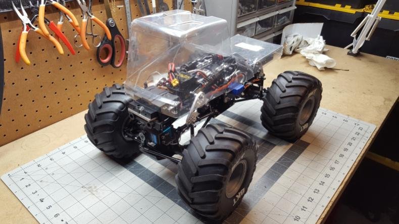

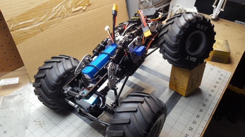

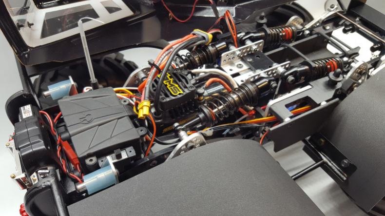

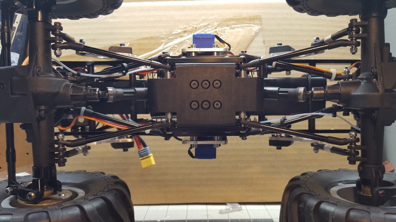

I dug through my parts bins. I had axles, tires, a transmission, frame, shocks, electronics (minus steering servos) and pretty of miscellaneous parts. The only major item is was missing was the body and servos. So I put an order in for those parts and started slapping it together.
Given the short wheelbase and 4ws I decided to take advantage of the venom creeper selectable diff locks. I had an old summit t-tock module on hand so now I can have full-lock, rear unlock, full unlock. With them lovked in crab steer this thing hops around a lot as expected. Unlocking the diffs definitely makes a noticeable difference. I know this is a novelty but I had the parts so why not.
More work to go on fenders and bumpers. Still thinking about a trailer but not sure I'll go that far.

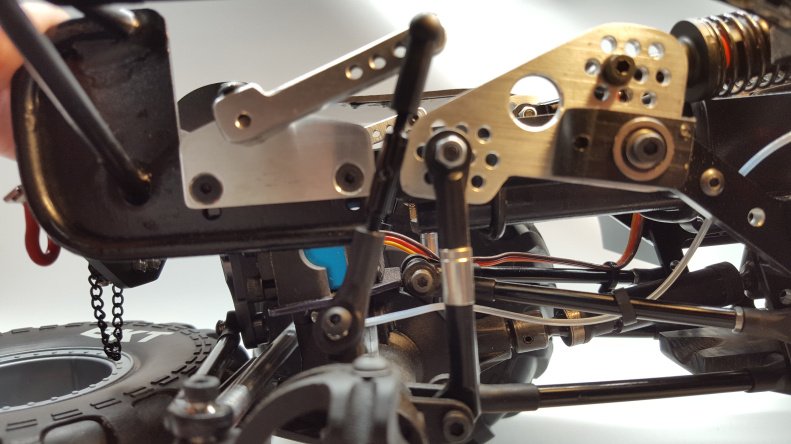

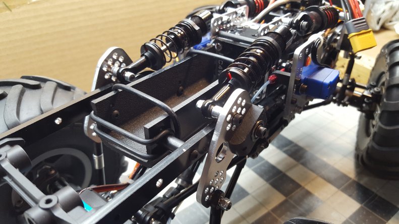

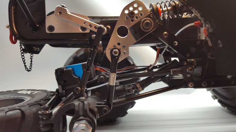

Holy adjustable cantilevers batman! Do all the extra speed holes make it ride better? Looks like they are bearing supported? Did you make them?
I'm liking the uniqueness of this.
I like adjustability! Plus when I start I'm never quite sure what pivot points will work the best. And yes the speed holes make it better! "thumbsup"
They are bearing supported and all custom made.

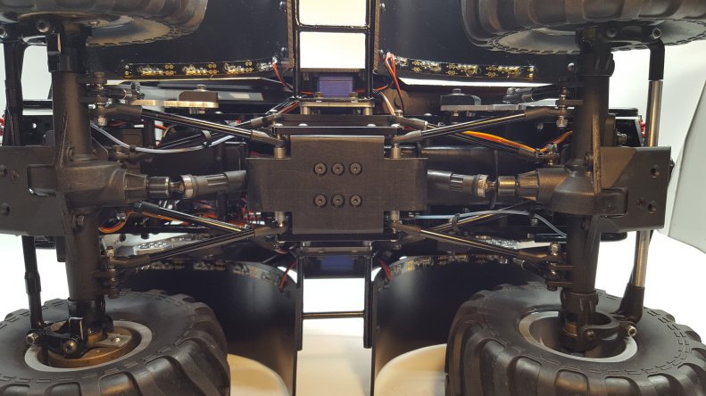

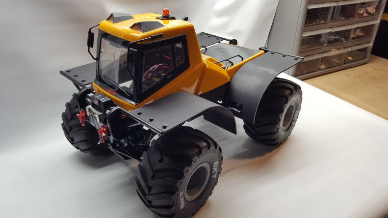

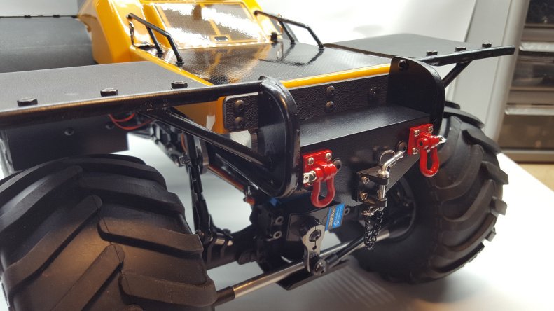

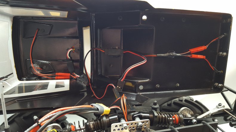

I didn't take a lot of progress pics so I'll just go with the finished product. Everything came out just how I had it pictured in my head. There is a lot going on here. 4WS, lockable diffs, winch, lighting, etc. The lockable diffs operate like a Traxxas summit: both open, front lock, both lock. For the lighting I had some cheap led strips that I tucked up under the fenders along with lights on the roof and rear. They are all orange so it looks a little strange! :)

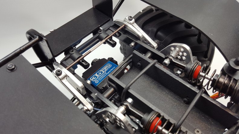

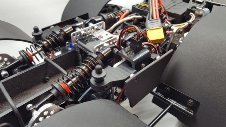

When I took it out for a couple test runs i noticed a lot of torque twist. I wanted the suspension to be pretty soft so I decided to fabricate a sway bar for the rear. Given the space constraints it took a little creativity to fit something in. It all cycles smoothly so I hope it does the job.
It has been a fun project. Deciding if I want to add a trailer.

Oh man! That came out alot cleaner than mine! Looks like it took less fabwork too. haha. Love the simple metal work. I like the raised bolts on the fenders, adds some detail.

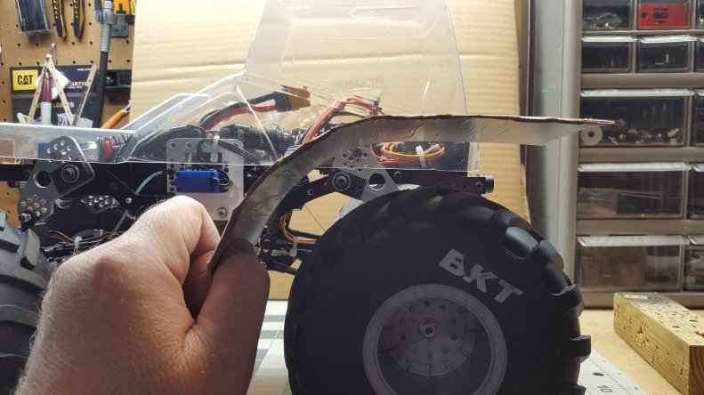

Yeah, my goal was to keep the metal fab work fairly simple. It allows me to get things mirrored on each side better with less variation. And the raised nuts on the fenders was a happy accident. I didn't want the nuts facing in towards the tires.
