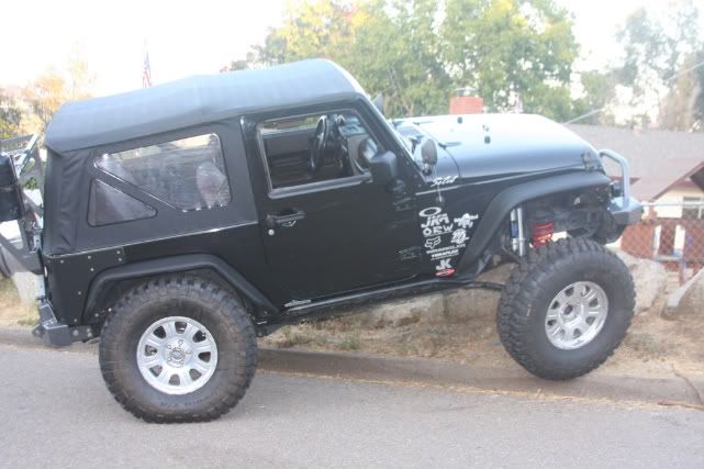

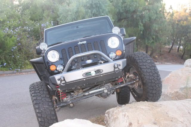

The 1:1 stats:
2007 Jeep Wrangler SWB "X"
Lift: 5" TeraFlex/Skyjacker "frankenlift"
Tires: 37" BFG KM2 Mud Terrians
Axles: Front & Rear Dana 44's
Axle Shafts: Front: RCV CV-joint / Rear: stock
Shocks: Fox 2.0 Reservoir Adjustable
Armor: Front Fenders: Poison Spyder / Rear Fenders & Crusher Corners: River Raider / Rock Rails: Poison Spyder
Bumpers: Front & Rear: Shrockworks
Winch: SuperWinch 9.0iEP
Gears: Superior 5.13's
Lockers: Front: Rubicon E-Locker / Rear: Eaton E-Locker
Off-road lights and Rock lights
So, that's what we are striving to build.

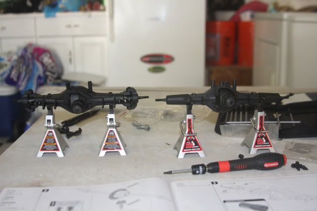

Starting point:

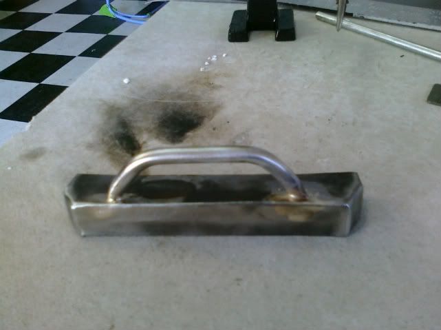

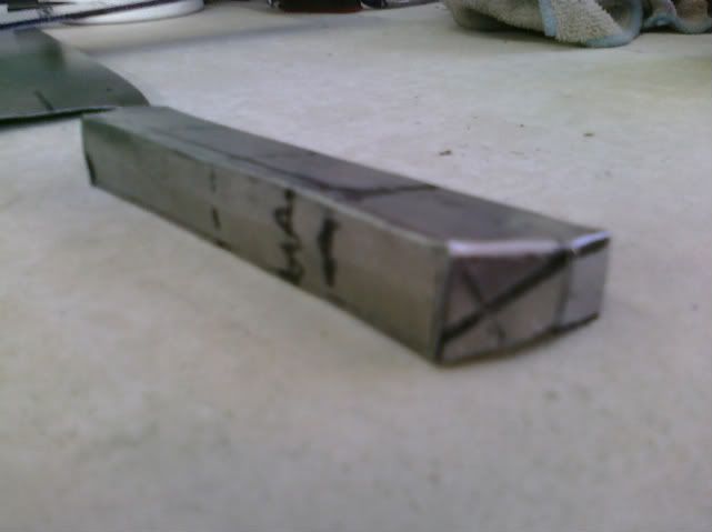

Front Bumper (first time brazing) Made out of 22 gauge sheet metal and 1/4" brake line.
We still need to cut out the top of the bumper for the winch, as well as a slot for the winch line in the front of the bumper.

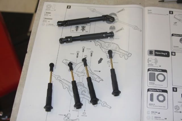

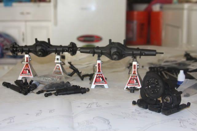

Start building the RC vehicle:
We want to use a 4-link set-up, so we got the 4-link truss for the rear, but still looking into a front 4-link solution. Also, since the 1:1 coils are red, we've painted the SCX10's coils red as well.

Looks like your off to a good start! Nice bumper fab 8)
Thanks. Still have a bit of work to go on it; I was surprised how well it is turning out, especially for the 1st try.
Nice start. I like the bumber good job for first time brazing.
Thanks. I was surprised at how easy brazing was to pick-up (well, when you have the right tools. I think it is all about the Harris Welco® Safety-Silv® 56 and having enough heat.)

Looking good and where did you get those little stands holding up the axles?
I saw those jack-stands in someone else's build thread, and did an internet search and only found one guy on eBay selling them. The interesting thing to me is that they are "Torin" brand (same brand you can find at Pep Boys), and that is close to my heart because my oldest son's name (the one who is helping me with this build) is "Torin."
Google "Torin mini jack stands"
Cool thanks

by the way,
I have a question for ur bumper.
is it steel or alum?...and how u brazing them?
I tried to use brass tube and sheet, but I don't know if it can be very strong or not:shock:

The bumper is steel, 22 gauge. The winch tube is brake-line. I'm using Harris Welco® Safety-Silv® 56 with a torch with MAPP & Oxygen gases. I was surprised at how easy it was to figure out how to braze.
