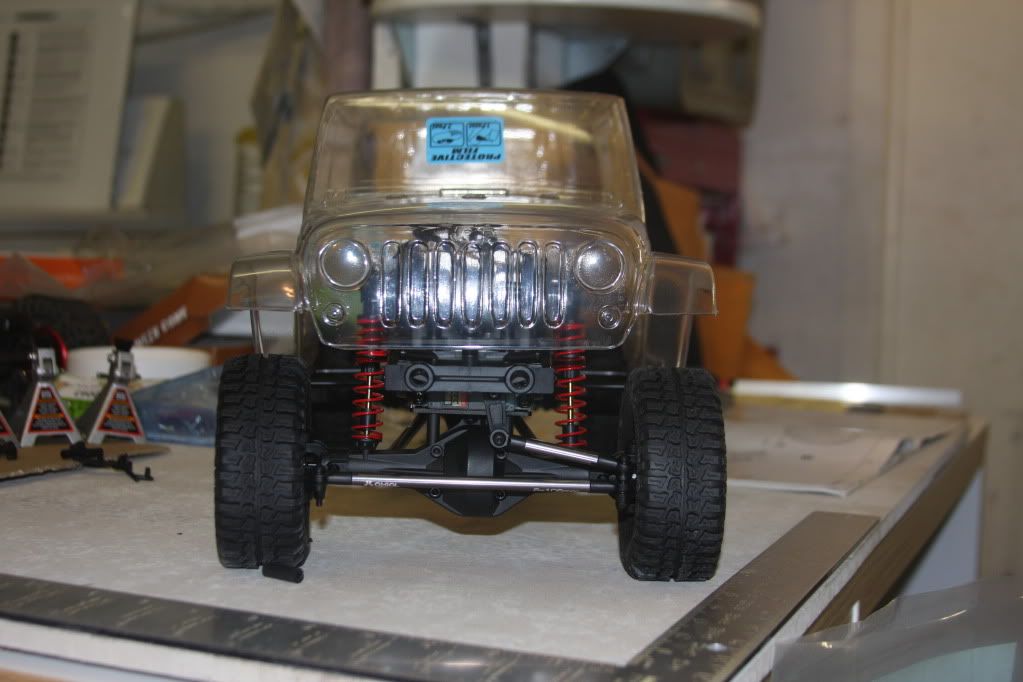

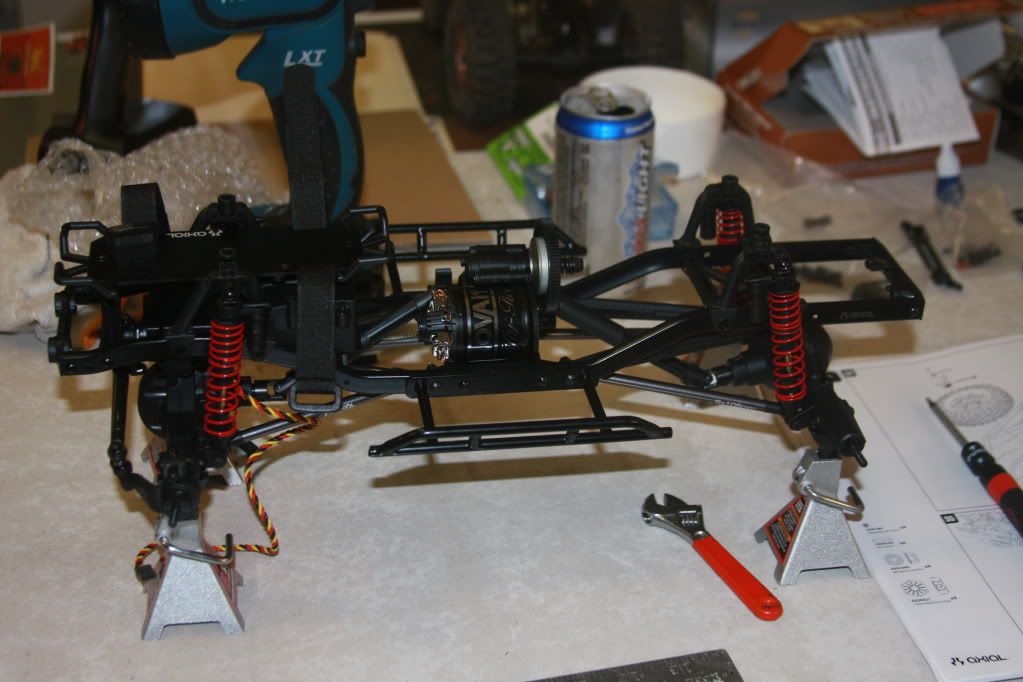

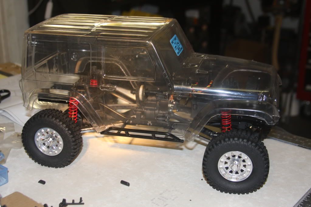

Update photos
So, progress is being made. All the electronics have been received, but nothing has been wired together yet. First, I'm putting the vehicle together in order to get the wheel-base set correctly. Then, I'll take it apart, do the wiring, and start some more fabrication: roll cage, rear bumper, etc...
But, it's coming together.
The 1:1 SWB JK in the background:
These wheels were the closest to the 1:1 that I could find.
I still think that these 1.9 tires are too small for my scaler look. The 1:1 has 37" BFG KM2's (see picture below). I don't know, maybe not after looking again. Maybe I just want bigger tires. Right, bigger is always better.
I have the 4-link truss in the rear, but the links are all the wrong length right now. As a matter of fact, the rear input shaft is pointing downwards (which is barely visible in one of the photos above).
Question:
Anyone know what the rear links should be to shorten the Honcho 12.3" WB down to the JK's 11.8" WB? (I would rather not change the front at this time).
Thanks.

off hand i dont remember which links shorten it up exactly
i saw it somewhere a little while ago i believe it was 98mm or something right around there
ill try to find it for you
looks good
Thanks. I'm gonna experiment with the rear links. 98mm are in front, maybe they are the right size for the rear, too.

I didn't really do the greatest job trimming this 1st JK body. Maybe I should put this one away, and trim the 2nd JK body. I've also gotta figure out how to make the silver decals ... but definitely, need to paint this thing. The new article in the Car Action mag has me inspired as well. 8)
Also, I've gotta fab the "crusher corners" and make the rear LED taillights.
:idea: What is the best adhesive to stick painted metal to the Lexan body?
