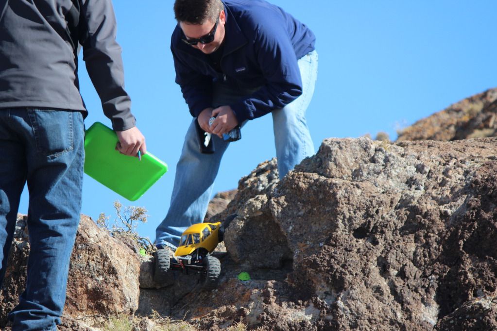

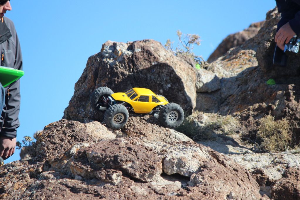

I pulled a 4th place with this truck over the past weekend at Best of the West. I made two stupid mistakes on my first course (immediately after hours of plane flights and driving) which knocked me down from 2nd....not fun, but that's how it goes. Anyway, a few pics:
