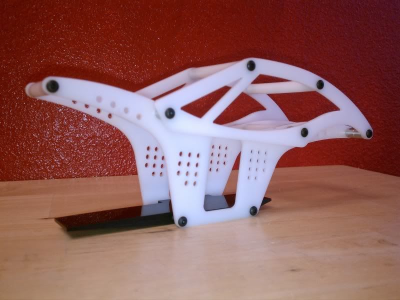

the chassis are nothing alike, if the side profile is what your trying to refer to, try this on for size.
its funny, yet sickening to me when i am at a comp and cant tell the difference between my chassis and others....

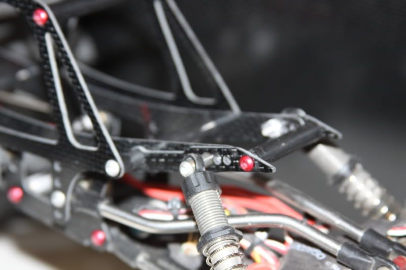

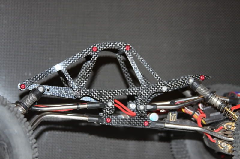

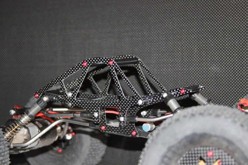

here are some pics. this is mine using the 1/32" lower plate.

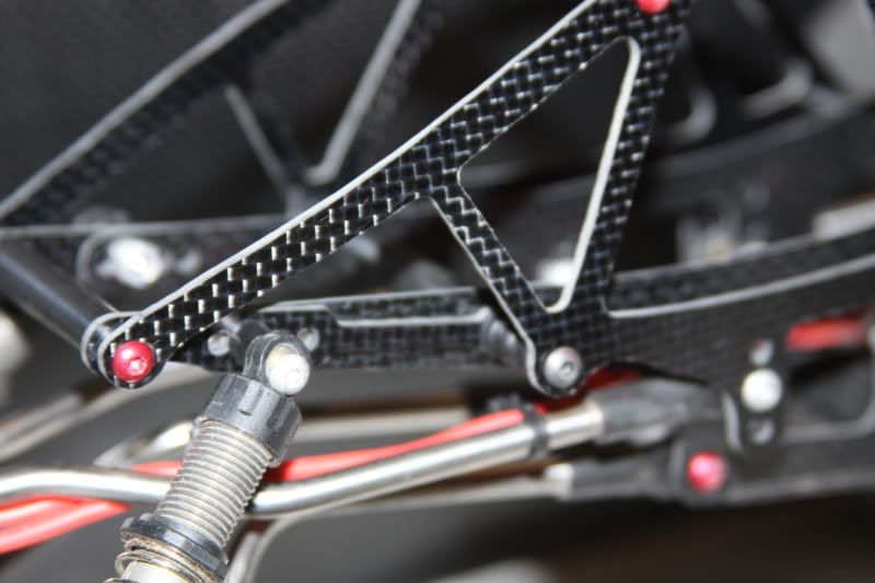

first off you will see the double sheared upper link monts. this adds extreme rigidity to the sub section.
the next thing was to get the standard 3.5 chassis to the legal length. i added doublers to all the shock mounting areas to strengthen the mounting surface while addid minimal weight.

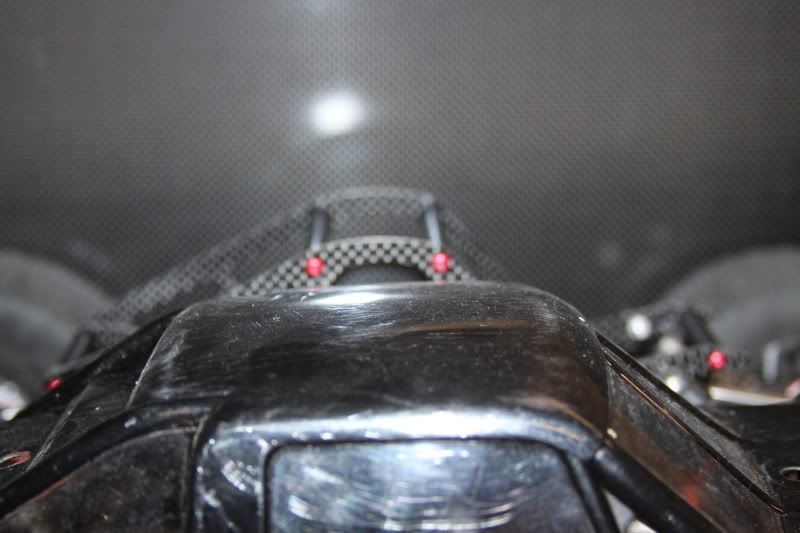

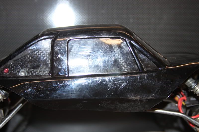

and the true inspiration( no offense jake) to the cab design. it is no secret that the x-citer rolls over better than anything.
i minimized the roof area and it is the xact height i ran it on the standard 3.5 chassis.

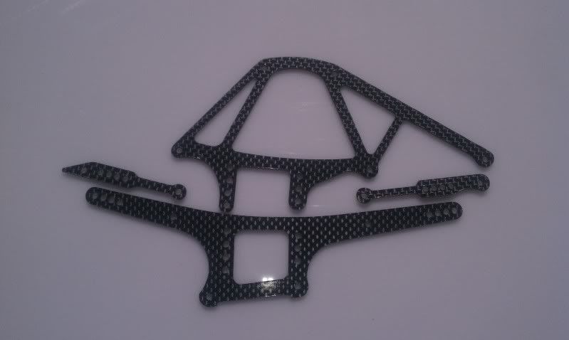

individual pieces...kinda shitty pic.

Individually, the pieces look odd (minus the main sideplate) but together they look "WOW"

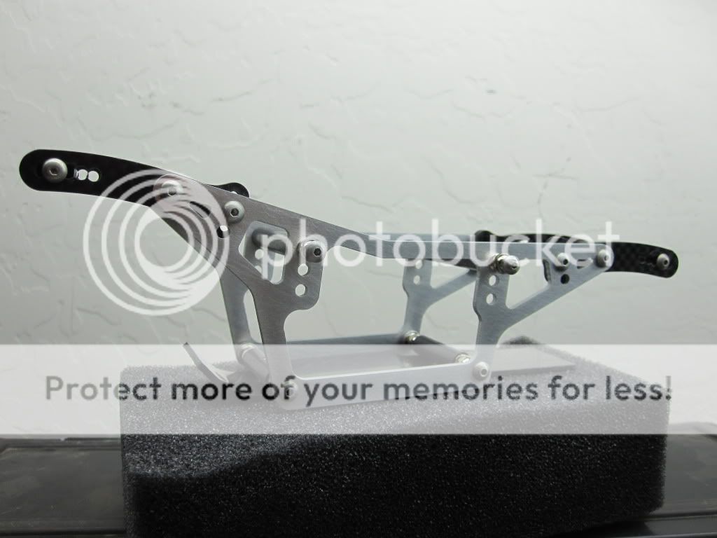

Proof not all kids are cute in case you were wondering. I am sure it works well, and I am also wondering when I need to drop my Berg off for you to update my car to this one. If you can't copy them, join them.
