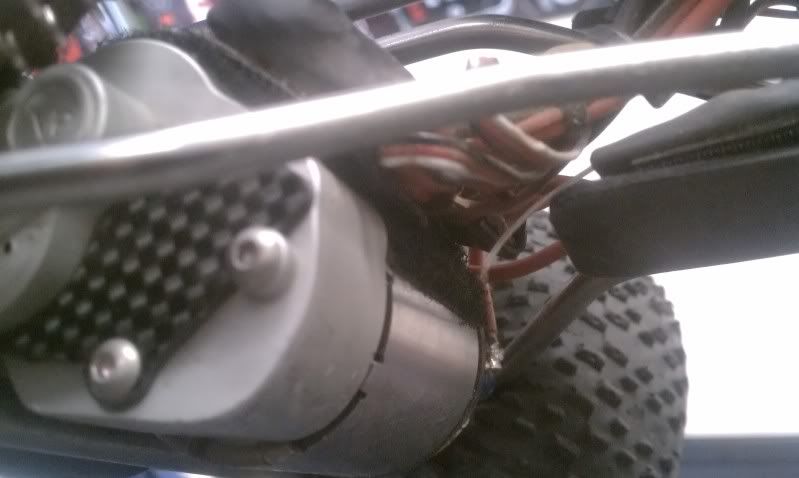

did some creative drill work....
and some more of that "space-age carbon fiber crap" as some refer to it...

Very nice work Jeremy "thumbsup" What's that put your weight at now?
Re: Krawl's "SECRET AGENT"
The drill work looks great, bet that took some patience. "thumbsup"
Looking good. Any idea on the before and after weights?
i believe everything ended up being 8-10 grams per axle.
i know i could easily put the plastic tops and housings on but that just seems so backwards to me....
i really like not ever thinking "am i gonna break something" esspecially with the gobs and gobs of excessive power all these brood motors are making!

Nice Mod Jeremy"thumbsup"
Have grinded my VP axle half about 7g:mrgreen:
Do you add a thin Carbon plate behind the Gearplate to hold sand away from the gears?? or a small tape??

most are pretty well covered. i will just have to be carefull of playing in the really sandy areas... this is something i already am very carefull of due to killing multiple 150+ dollar sets of motors with sand:shock:
i have more work to do on my axle tops still:twisted:

I have some Good ideas too:twisted: ( all on the Inside) to save another but its difficult without a Spare Axletop. and a good milling machine. now my Axle top is 15g ( 0.52oz) more than the Stock one:twisted:
On the Sandy Areas i know what you mean. but whats a bout little bit of glue or Epoxit to cover the rest of the holes

extra grearscience on the inside ...skim over the holes is what i have done now...see how that works.
