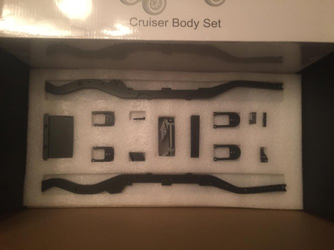

nice book on top...wifes say water is leaking...*&*(^(&%% few choice words back into bathroom...tighten a few things a little more no more leaks...the forces are working against me...get a few more pictures.

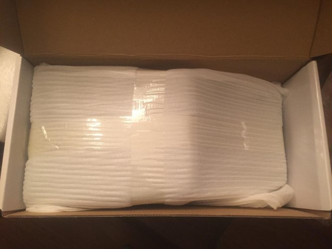

RC4WD does real nice packing to make sure no parts get damaged.

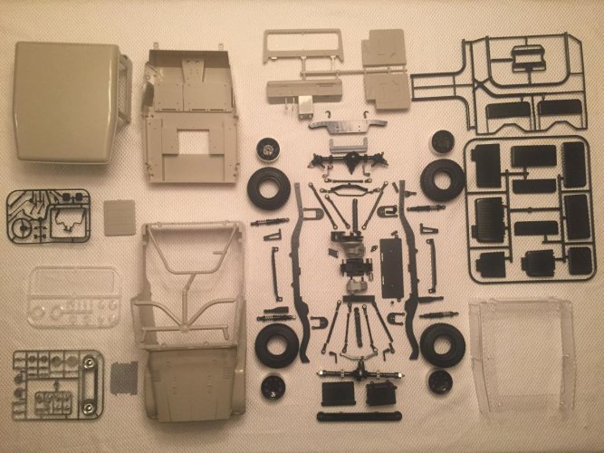

well i finally can get started building.. 4 days after i get...other team mates are already done by now...
laid out all the parts for this cool picture.

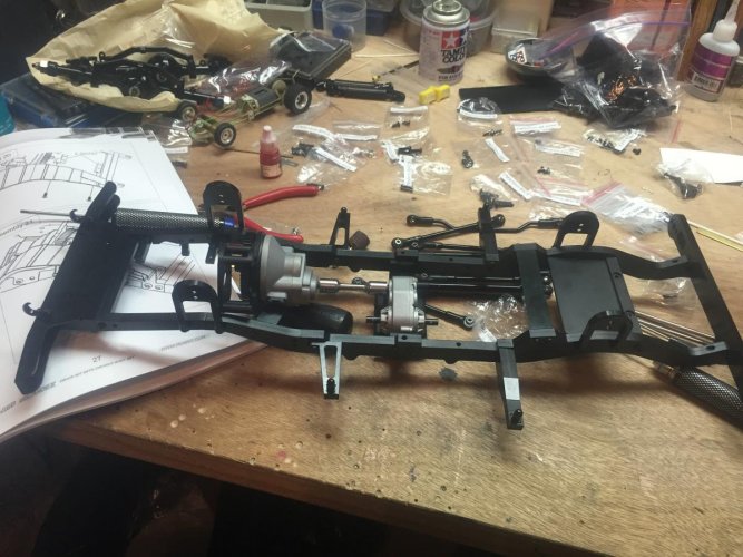

im not going deep into chassis build, the Gelande 2 has been around for while now... chassis is the same as far as i can tell...they did make new holes for the body mounts...i wonder why they didnt make it with leaf springs as the real 1;1 has them...but on too the chassis
i didnt have any major issues with the chassis...i did get confused as to where panhard braket went...frame had 3 holes and instruction book showed only 2...

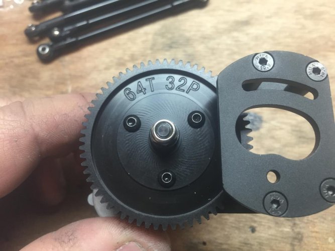

trans was taken apart and more grease was added...one thing i'm not crazy about is 32 pitch gears...there nosiey...IMO...i will chnage this out for a 48 pitch spur gear

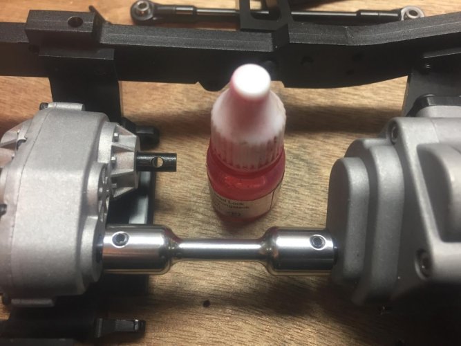

only other thing i notice was center drive shaft...when i tighten the screw pins, the shaft had a BIND in it when rotated.. i decided to add thread lock to them and not tighten them down real hard.... i just screwed them in till it had the bind then lossen till it was gone not much...thread lock will hold them in.

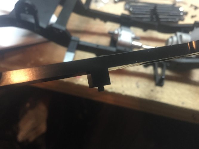

we had some talk between us team mates as too the screw in the rear bumper no being long enough...its holds but i may put a longer one in later..

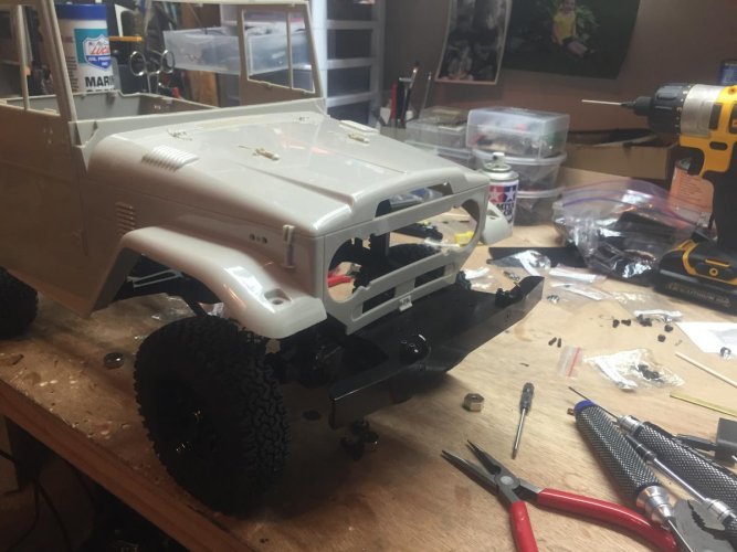

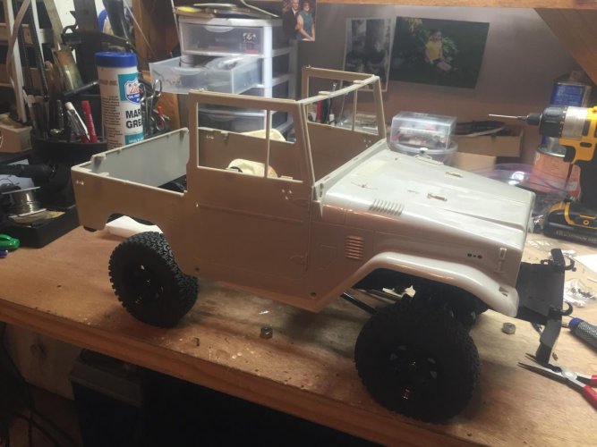

he have the chassis together..
now to try this beautful body on it
this is where i am now...loots to still do.

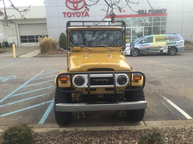

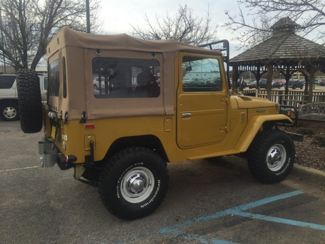

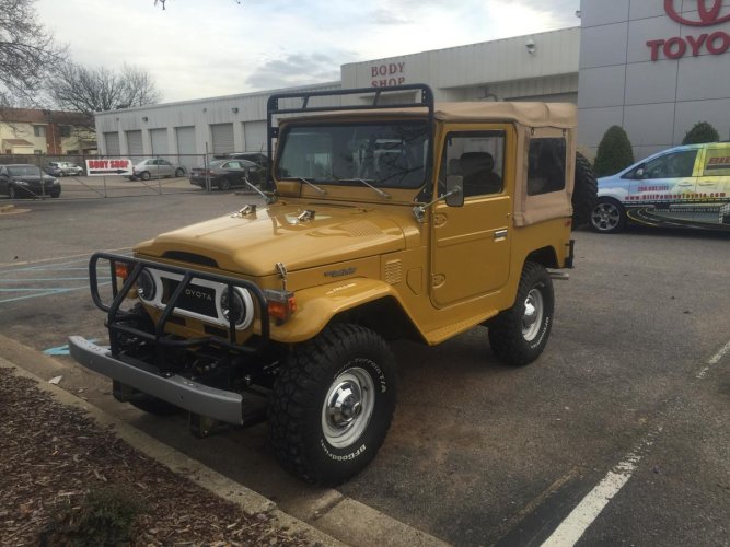

my team mates have been going back and forth as to there colors...what they dont have is paint codes... i do and mine is going to be....drum roll please....
im going with Suntan Yellow....why YOU ask...???? because when you work at a large toyota dealer and the owner loves FJs and he HAS friends that have FJs.....you get to work on a REAL FJ!
YES SUNTAN YELLOW IS my color of choice...!!
