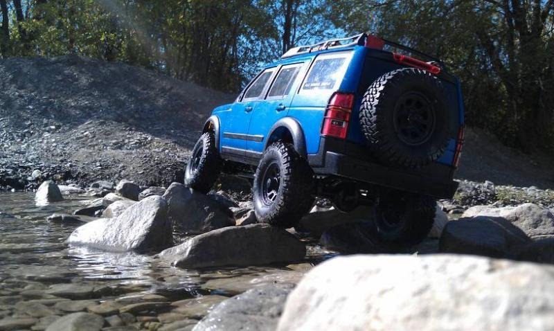

I've found a nice sweet spot tuning my suspension for maximum ground clearance while maintaining side hilling/roll over stability. I'm addicted to rock crawling - flat or uphill. Not so keen on trail. I like places I think the Honcho can't tackle then tackle them. I'm not a basher, I do it like I would 1:1
I've lifted it at least 10mm with the lift kit and re-oiled the original shocks with 30wt and screwed down the pretension considerably. Lower links are aluminum and adjusted to clock the axles slightly. The super swampers give it additional clearance as well.
It still has good flex and crawling over a radical horizontal pitch changes it slowly lurches over then as soon as a wheel grounds there's zero rebound - its remarkably stable given its high COG.
Here's the pics

I'm trying to find a way to lower my XJ 10mm or so, raising the body on a SCX-10 in my eyes only makes it worse on angles. If you look at all the KOH/Ultra4, the rigs sit very low, with large tires. My 1:1 is as low as I can get it, while maintaining enough lift to clear tires. Minimum clearance is 13.9".
My suggestion is lower it back down, run a droop setup and add bump stops to the compression side to eliminate rubbing. This will increase stability on all categories, move the bumpers in and you will have the same approach/departure angles. Is that a Honcho front bumper on the rear? LOL
i'd start by adjusting the tension on your coilovers so there is some actual down-travel left in them - currently they're almost maxed out and most likely reason you claim the rig is stiff. then i'd drive and test it. next you might think about removing the lift brackets or just raising them up one hole to lower the stance and get a better COG. i don't think you'll rub since you've already cut your body.
you think it stays planted now...wait until you lower it, add weight to the tires, and put more weight inside the axles via beef tubes, HD locker, and metal steering parts -- THEN it will stay planted "thumbsup"

True, the skid plate is a hindrance more often than not but I'm reluctant to remove it after seeing the gouges rocks have taken out of it -

I'm definitely taking all advice onboard - hey, the diff guard is gone! I really appreciated that advice.
I kept my Honcho stock for a few months and my biggest complaint with it was getting it hung up in the middle with all 4 wheels spinning freely so I knew I needed ground clearance. I bought the shock lift kit "and" the super swampers at the same time and installed them both - probably a mistake to do 2 upgrades at once. The swampers gave it nearly 10mm lift at the diffs where it need it - so the shock lift was most probably overkill but definitely beneficial with its chasis ground clearance. I also meant I had to tune the shocks / springs quite a bit more stiff than they were previously.
Until now I was "anti" 2.2's for my rig but I think it's now inevitable... Justify to myself to spend some more $ for wheels and tyres then swap out or change the lift to droop. And while I'm justifying I should probably choose new shocks ...
