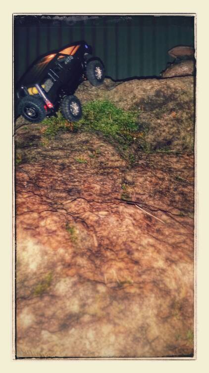

July 2013: here's where things stand currently. Yet to do: finish the paint and final clear coat, barwork (that'll happen in early 2014 when my 3Doodler arrives), snorkel (in progress), considering a dim interior ceiling light, possible window tinting, tail and reversing lights in the trailer... the list goes on. She's getting there though, despite my having created MANY rookie flaws in the body.
