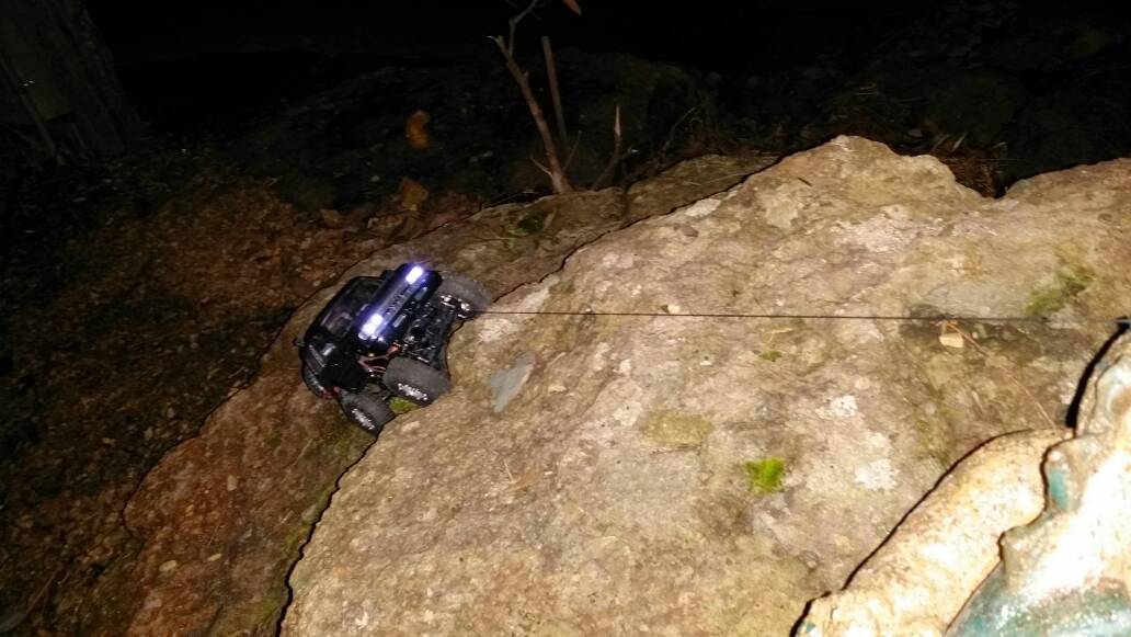

Out for a spot of crawling in the front yard tonight...
Even a pimped out truck needs help sometimes!
