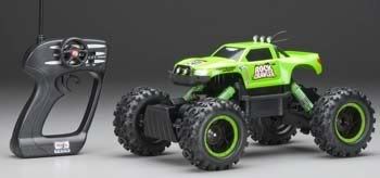

I know it's toy grade, but i found it very cool that even Maisto is interested in rc crawling8)
http://www3.towerhobbies.com/cgi-bin/wti0001p?&I=LXZGN9&P=7
It's only $43.00 also"thumbsup"

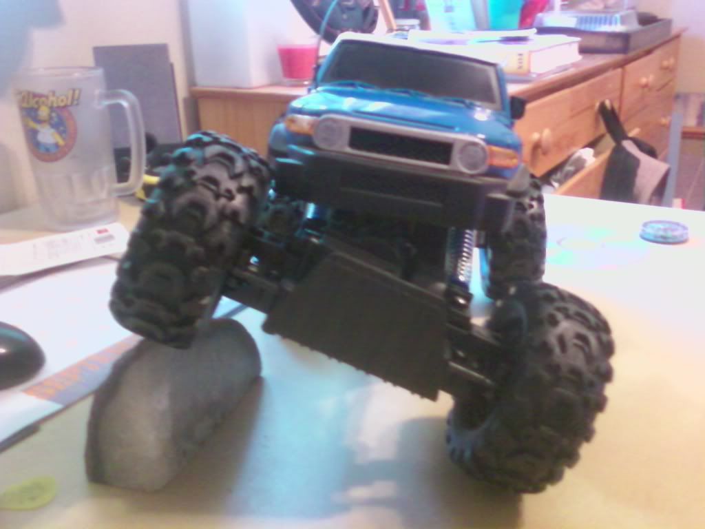

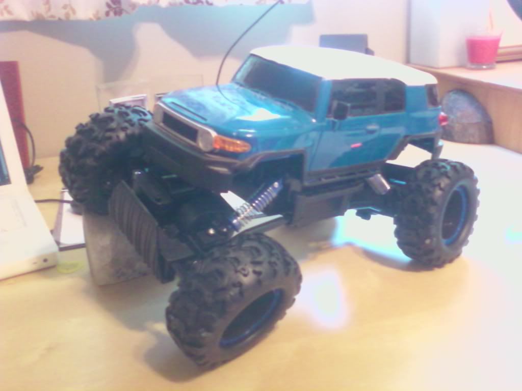

It does indeed have potential if you want to go at it. Picked one up the other day and have so far stripped it of its stock board, added a cheap Acme reciever thats fully proportional, an electrifly ESC (its meant for a plane so it only has forward that is fully proportional) works though "thumbsup", added a hobby grade servo thats super glued to the front axle :mrgreen: with a home made tie rod that works great. And to to help its massive amount of clod stall ive added a re-chargeable 7.4V 800mah pack that wires in piggyback with the AA's for some extra kick. soooooo yeah :roll: lol anyone know how to add picks?
