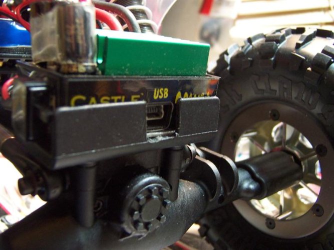

If you are going to run a Mamba Max ESC on the rear plate you might want to do what I did. In order to be able to use the USB port on the ESC and NOT have the wires coming out the back of you rig (If you don't your battery wires wont reach) just cut a small box out of the rear plate. This way you can still program your ESC and keep the wires clean and away from hanging off the back"thumbsup"

Good Idea on the slot BTW!
No probs yet. I went through the whole thing a used LocTite on everything. Took the axles apart and lubed them up. My kit was missing screws but no biggie....
