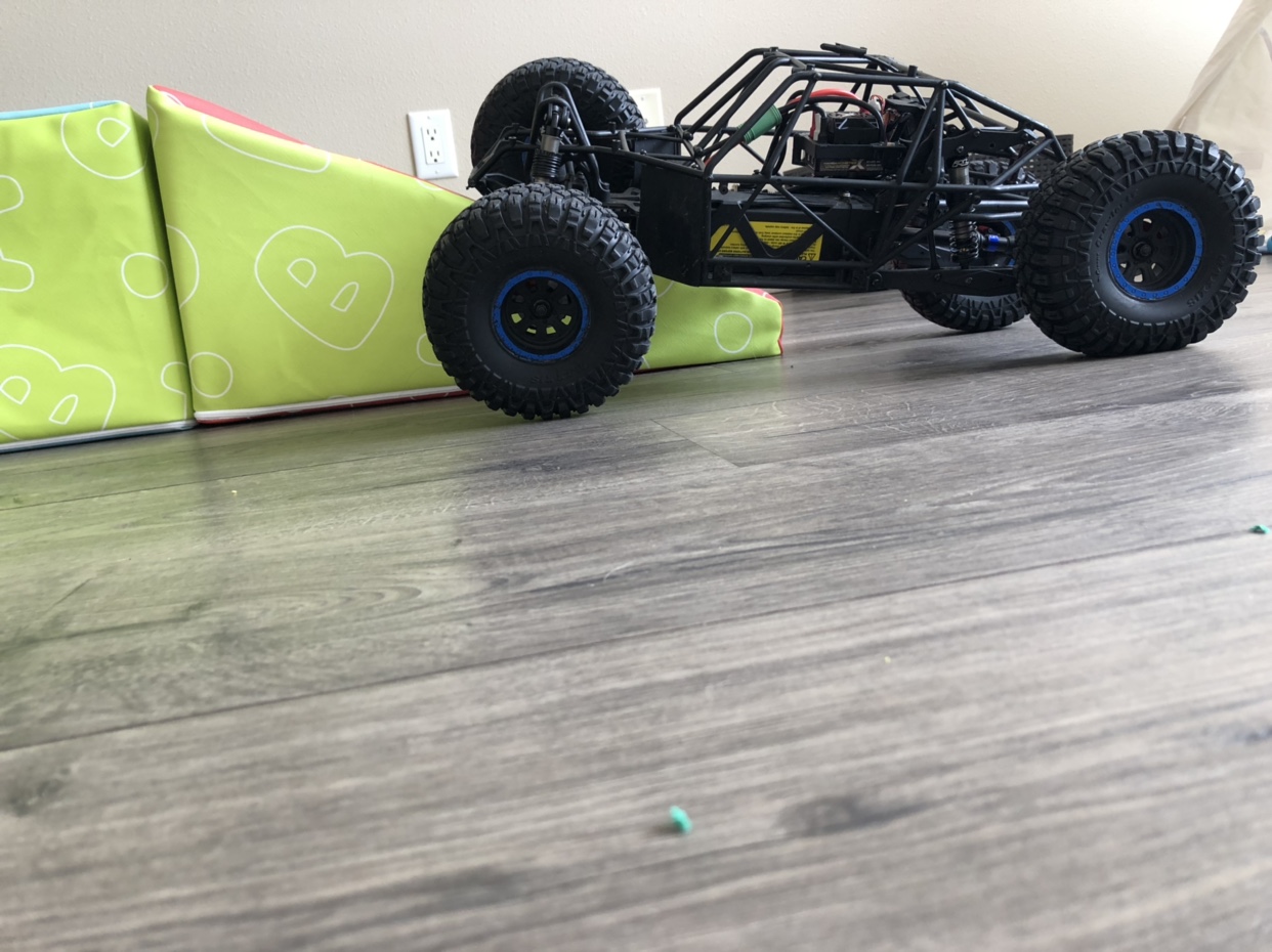

Was screwing around today playing with the Monster X drag settings. My son has a little play mat with a nice 30* angle to it so i decided to do an RTI test with and without the rear sway bar connected. Makes a huge difference:
Sway bar connected:
Sway bar disconnected:
Truck went up the ramp under its own power, so this is how it sits naturally. Sorry if the pictures arnt exactly the same. Its pretty hard to take the pic and try to hold the truck in place with the throttle.
Obviously the truck drives like a wet noodle with the sway bar disconnected but it crawls like a beast. It would be nice to run the Hot Racing front sway bars and be able to quickly disconnect both when you wanna get in the rocks. That way it would be stable at speed but still flexy when you need it.
One thing I will say is that with the sway bars disconnected, the rear trailing arms seem to bind on the rear shocks when trying to fully articulate. I think the arms are actually limiting travel, so I may try to open up the slots in the arms to help it twist a little more.

Hogged out the lower trailing arms:
Its not pretty but it lets the powerstrokes flop over a little more before binding against the arms. This gave me another couple inches on my makeshift RTI ramp:
So now the rear tire can actually hit the ramp before leaving the ground [emoji3]
One thing i never mentioned was that i got the powerstroke slash spring assortment as well as the prospec rear spring assortment. I just switched to running the powerstroke red primary(small) spring in the front with a red prospec spring, to running a yellow prospec spring and red primary.
This balances the front articulation a little better with the rear. The rear was bottoming out on the ramp while the front still had maybe 10mm of travel left. The yellow spring knocks that down to a few mm.
