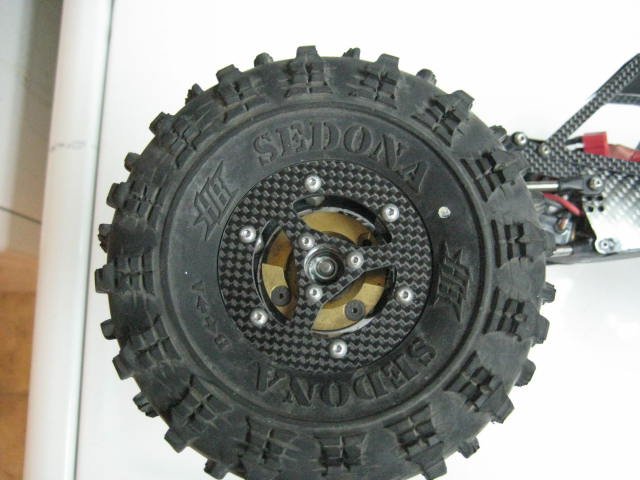

now im on to some CF beadlock rings. i ran the first two out of scrap 1/16th material and allready see some changes that need to be made but for the most part they came out the way i wanted them to. i have been using my tryangle offset and only three bolts for a couple years now.
here is a pic of the proto type.

That looks sexy in all CF glory. Are the CF skins made from rigid CF sheet?

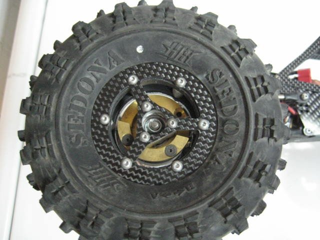

Also, suggestion o nthe wheels. Since the material is so thin, maybe you should rotate the spoes 30* in relation to the lock ring & hub hardware. My thinking is that oriented that way, the spokes would meet up to the hub and outer ring area where there is the most material, thus making the wheel more durable. The way you have it now, the holes for the hardware is right at the ends of the spokes.
no, it is a CF skin material from dragon plate.
[/QUOTE]Also, suggestion o nthe wheels. Since the material is so thin, maybe you should rotate the spoes 30* in relation to the lock ring & hub hardware. My thinking is that oriented that way, the spokes would meet up to the hub and outer ring area where there is the most material, thus making the wheel more durable. The way you have it now, the holes for the hardware is right at the ends of the spokes.[/QUOTE]
i see your point scorpion king, i will give it a try. when i originally drew the cad for them, it was for an all AL wheel and i was only going to use three bead lock holes. i would have aliminated the holes at the end of the spokes. thanks for the advice."thumbsup"
here you go scorpion king."thumbsup"
i like it , thanksyou sir.
i think i will call these MFD "THR33" CF beadlocks
