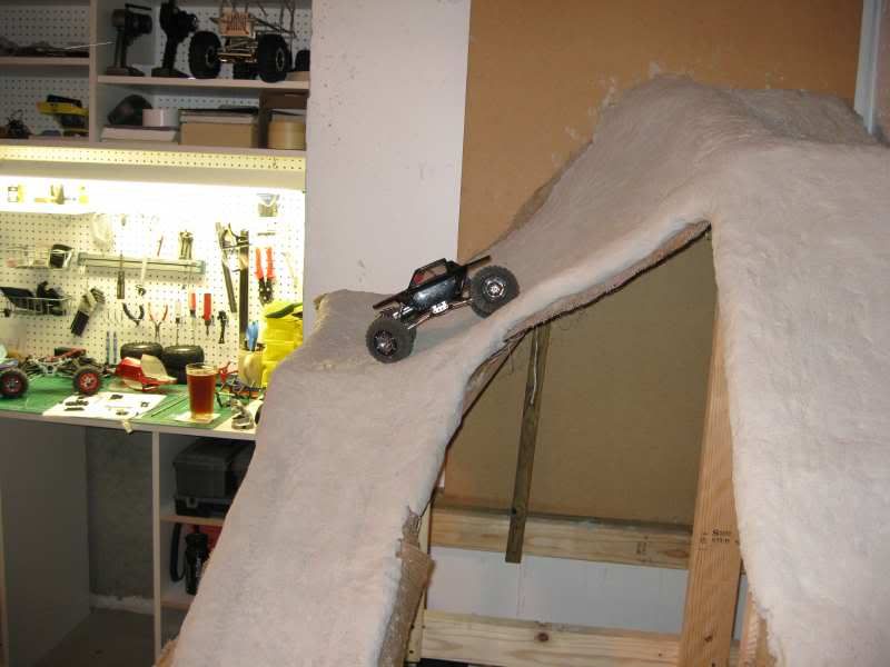

Clint stopped by last night for a few beers and to try the Bronko out on the basement course. That incline is about 40 degrees.......yes we measured it:

Poor little Bronko sure took a beating. :shock: Super fun to drive and Still going strong though.
Thanks for taking the time to film a successful run. Thanks for posting all the failures too :flipoff:
40 degrees on the low side, more like 50 by the wall, right? Way off camber toward the side I keep slipping off of.
