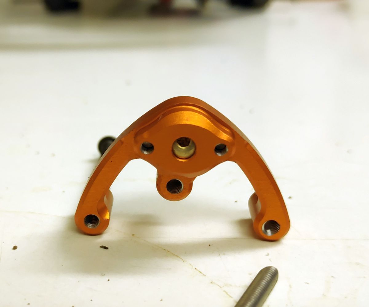

Important to install the motor mount screws first as I didn't and had to remove the shock tower screws and do this.
Apart from installing, but not fully tightening the motor mount screws until all other screws are in, the mount is quite loose between the frame rails each side, rather than a sliding fit like the stock mount. The mount is also a bit narrower across the frame rails, so I put the bumper mount back in before tightening everything down. Also is doesn't allow the motor to drop down any further than the stock mount.
The link mount on the axle was easy to install. It comes with screws, but the stock ones will fit. It would be possible to use one of these on the rear and use a panhard rod if someone felt like doing that.
