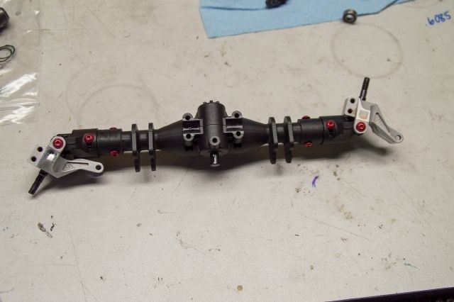

Has anyone really punished an XR Mod Losi axle?
One reason I love them so much on my scalers is the durability. They're absolutely bulletproof in stock form and give 45° steering.
I've just wondered if gaining an additional (useable) 10° of steering is worth the risk of compromising the structural integrity?
Cant speak about punishing one but Id have to think durability is right there with the XR mod.
I would have loved this steering on my old LCC and even a scaler if I had used them. "thumbsup"
But the scalers def take a bigger pounding.
Vanquish XR steering pieces on a Losi crawler axle are bulletproof. But the plastic Losi housing isn't. Breaks just inside the shock/lower arm brackets. Fortunately, they're cheap so trim up a spare.
