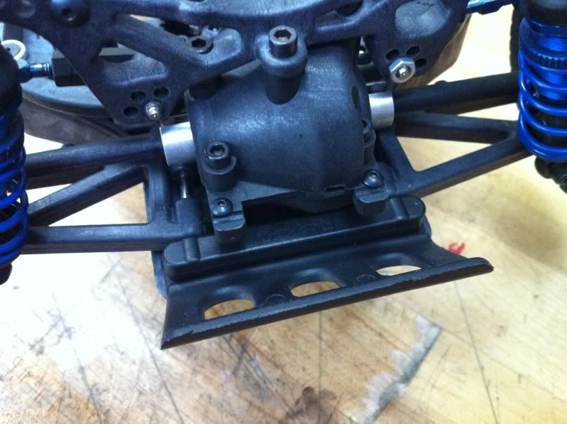

Hey mthead, do you mind taking a picture of the rear of that chassis, it looks alot like my exceed car. I broke a pivot block awhile back and i dont feel like paying $25 shipping on a 4$ part. So im looking for an easier part to get.
Here ya go..
For a rough guesstimate, the pin holes are 1.65" apart and the mount holes are 1.87" apart, hope that helps.. "thumbsup"

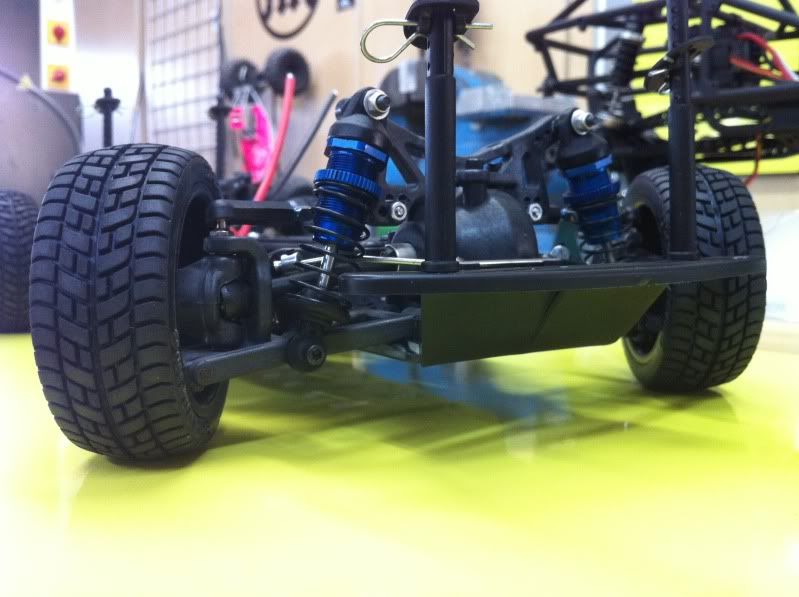

So I got a little bit done, installed the new shock shafts, springs and lighter oil (40wt, 3 hole piston). She has a nice respectable 3/4" clearance.
Also modded the servo area in preparation for the NTC3 steering conversion. I have two #50 holes drilled where I think they should be, I'll wait until the parts show up to double check before going full size.
Finally installed the motor,
I believe I have enough power to tear up my lighted aluminum diffs. Never found the box with the original steel diffs so I ordered two sets to have on hand. If I go through with the 200mm conversion I'll have to throw them in or do the weed wacker mod to the new bones. Those steel pins in the bones will kill the aluminum diffs in one pack.
Build #3 on hold for parts.. :ror:
