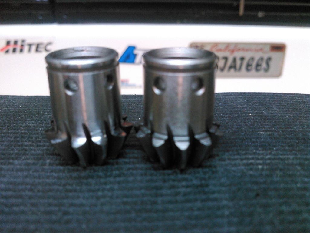

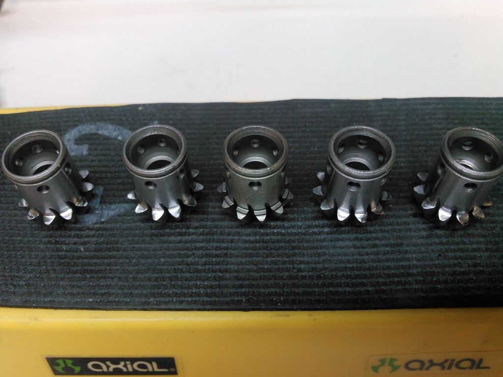

Can you pick out the one that doesn't work in this picture ??
BHB MOD VS AXIAL
This is how the bearing should look after the mod. (IF) too much material has been removed you can always install the shims first to recede the pinion."thumbsup" BUT ONLY IF ... Honestly.. I think the teeth let you know ... you've gone too far.. 90 degrees from the tip of the tooth to the pinion shaft...
I figured you love seeing them going back out with in 8 hrs "thumbsup"
Well I've noticed I've been receiving more single pinions ... That must mean Dhawk V2 are selling like hotcakes... Your welcome Jimmy Dhawk Lol :mrgreen:
Yes the video, Dhawks V2 and basher testimony is convicting enough lol but I should of taken this picture along time ago because a picture says a thousand words lol"thumbsup"
This is why Axial sells out of replacement parts... Sad because it IS one IF not the baddest Rc on the market !!
