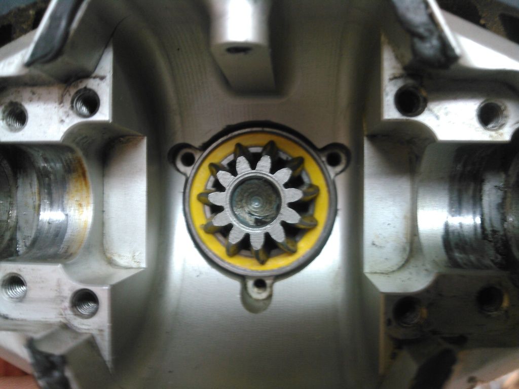

So guys It's been a week and not a word from Scott (Axial) or Harley...I've sent emails and called Scott and left a message...He seemed like a great guy so I'm giving him the benefit of a doubt."thumbsup" It really doesn't have much to do with Harley at this point I just it would give him a solution for his customers "like me"..And maybe reach out to the RC community.... I also begged him to come up with a transmission case that corrects the gear geometry in the transmission... I've got a buddy with a CNC shop that I'm gonna go talk to... maybe someday soon you'll be buying a BHB Tranny "thumbsup" Made in BH Maine, U.S.A MaDe FoR BaShErS bY BaShErS let me know what ya think...

50 RUNS 35-40 6S BHB PINION MOD IS A MUST !!!! LOOK FOR YOUR SELVES !!! MY GEARS LOOK BRAND NEW STILL AND I'VE BASHED THE SHIT OUT OF THEM!!! 6S 2WD 20TOOTH PINION LOCKED UP SMOKN DONUTS...BROKE EVERYTHING BUT THE GEARS!!!!
50 RUNS VANQUISH HD BEVELED GEAR PINION MOD (BUT A MUST FOR STOCK AXIAL AXLE ALSO)

Just finished my second run tonight on these new HD gears in new plastic front and rear diff cases. Not even a click! i've never made it more than 1 run without nasty noises coming from either the front or rear diffs. All new diffs and 500k front and rear make this truck a dream to drive now!
As for modding the pinion, i only had to do the front. The rear was perfection with the stock axle. The front, not so much... lots of dremeling and test fitting, but i finally got it perfect.

I am in the process of building the kit. Both front and rear were binding with the HD bevel gears. Called Axial about this issue and they act like it is the first time they had heard of it. Explained to him that it was a common problem and there was alot of talk about it on the forum. He did offer to send me 2 new sets of gears when they come back in stock. I told him if they dont revise the design that new gears wouldnt make any difference. Tried your mod in the rear and it worked great. Now onto the front. I was almost to the point of selling the yeti and cutting my losses. Thank you for taking the time to post threads and videos to help us all. BHB ROCKS!!!

I did this and about 4 runs on 6S and they were done. Good luck.
So I finally tore into the rear diff. It was a bearing failure NOT gear issue. Pinion bearing exploded and packed the pinion with balls and shoved the pinion out the diff. Totally my fault. I have a new set of gears for front and rear and did the BHB mod today at work. we will see what happens now. Will get into front diff this weekend. BHB mod was not too difficult and with his vid it really helped.

After doing the BHB mod it seems simpler than it sounds. testing will tell but I didn't spend a ton of time just cut off the ridge and checked for high spots and all looks good. The way the gear tooth is tapered or leans towards the front of the pinion it's pretty cut and dry. No over thinking needed.

before my mod I took Harley's advice sanded the spacer and ran er with the retaining cup out .05 and tried to let em break in ... F them all up.. That's why I was doing limited bashn runs mostly crawling..
all good now... but I did have to replace my 24mm Vanquish bearing also:evil:
LOOK HOW MUCH THE FN HD GEARS F UP MY VANQUISH AFTER 2-3 SHORT RUNS...PLUS NEW BOCA BEARINGS AND HD SET....
