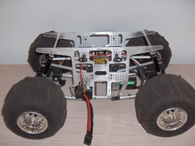

Some folks might remember this truck(there's a thread about it somewhere in here I think) because I raced it at end of our last RCMTC-HI season. While it was wicked fast it had a few problems like cogging, stiff suspension, and link setup. So when the season ended I worked with JoeWorks on making some design changes for a new chassis.
The result is the new JoeWorks V4.0. The new chassis straightens up the link geometry so I don't have to use bent links. The battery mount is also slightly different and that allowed me to mount the E-Revo transmission, level. By levelling the trans I can now run smaller pinions. I was limited to 14t pinions on the V3.0 chassis because the motor would contact the driveshaft. And last, the chassis is about 1.25" taller. 1" is for the longer 120mm shocks I am now using and the extra .25" was so I could get rid of the bent links used on V3.0. I made the change from the 5700kv motor with 14t pinion on V3.0 to a 4600kv motor with 12t pinion on this truck. Joe actually finished the chassis a few months back but I had other things going on so it went on the backburner. I finally got it back together and running for the last race before the Mid-Season Championship.
Chassis: JoeWorks V4.0
Axles: Tamiya TXT
Transmssion: Traxxas E-Revo (single motor, single speed)
Driveshafts: Traxxas Revo Center Shafts
Shocks: Hot Racing 120mm Air Shocks
Tire/Wheel: Imex Pullers on Tamiya TXT rims
Esc/Motor: Castle Creations Mamba Max Pro/4600kv combo

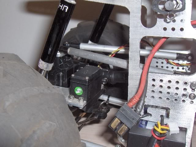

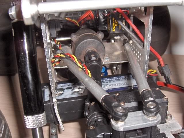

BTA steering system I made. It's tight but the drag link does clear the bottom links and the top links do not touch the servo even when the shocks are fully compressed.

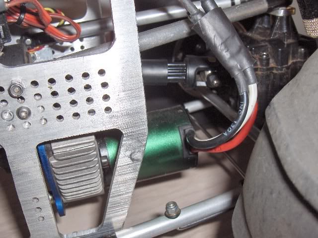

4600kv motor

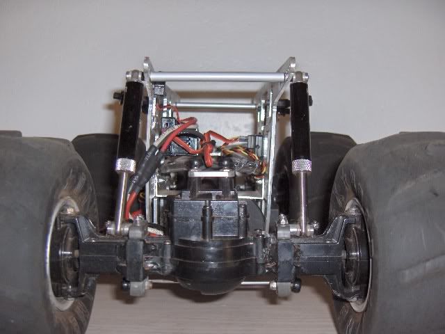

The entire drivetrain sits below the level of the top links. In fact the entire battery, motor, and most of the transmission sits near the centerline of the wheels.

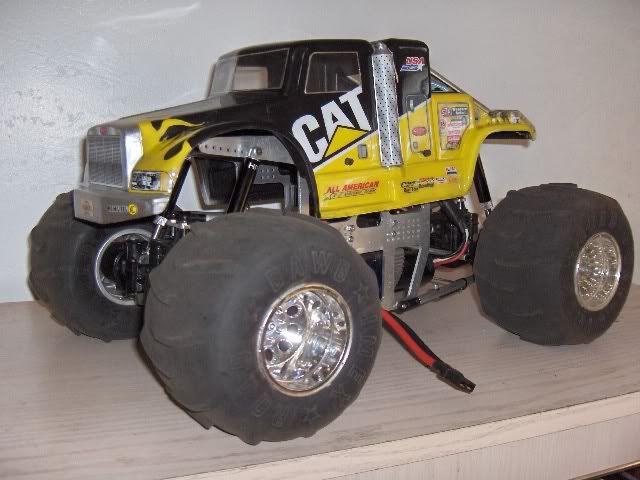

Yes, I kept the stock rod ends. On a lightweight truck like this the stock rod ends will only pop under very severe crashes. In fact I just freestyled my truck at Mids and the front top link only popped after I tried a backflip and it landed crooked on the front axle very hard.
The trucks sits with about 1/3 of the suspension travel of the 120mm shocks in droop.
