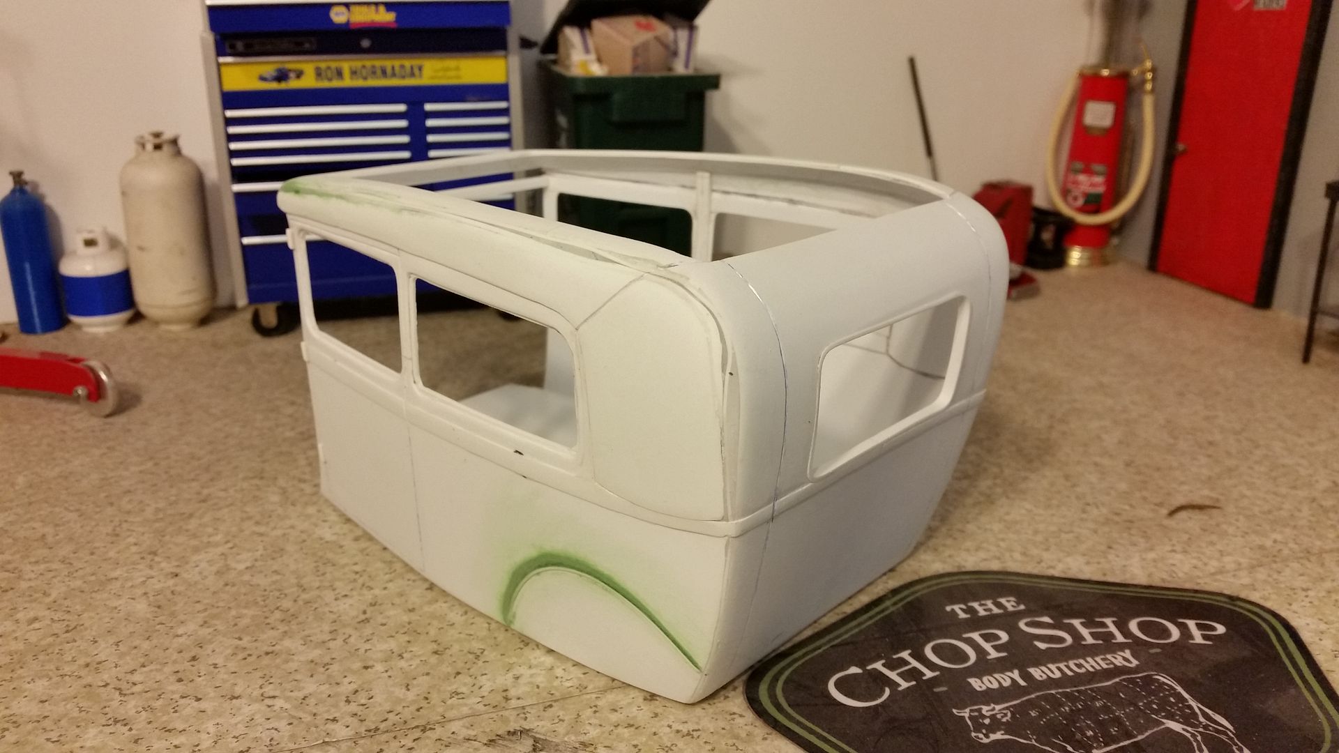

SO I did some more work on the Tudor last night. I clocked 3 more hours on the build. As it stands I'm right at a total of 6 hrs in labor. I added some reinforcement to the b pillars. I used two strips of .40 styrene and carved a groove down the middle of it to create some detail. I had to cut the pillars to relieve some pressure on it that was causing a bow to form too.
I also added the side pieces and another layer of .40 styrene to the roof. Then I started sanding...and sanding....and sanding.
It's getting worthy of the shop now. I needed to add some side detail around the windows and the back. I used some .20 styrene for that. You can see one side versus the other. I still need to do around the windows and add a few other touches.
The rear window ended up being a little bigger than I wanted, but I might be able to make it smaller with some trim work.
Here's the passenger side before the trim...
