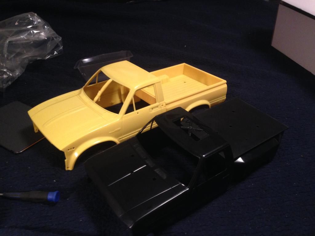

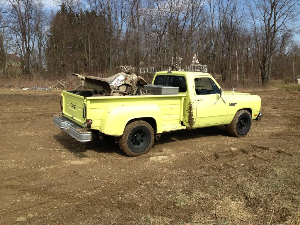

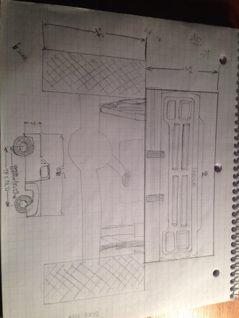

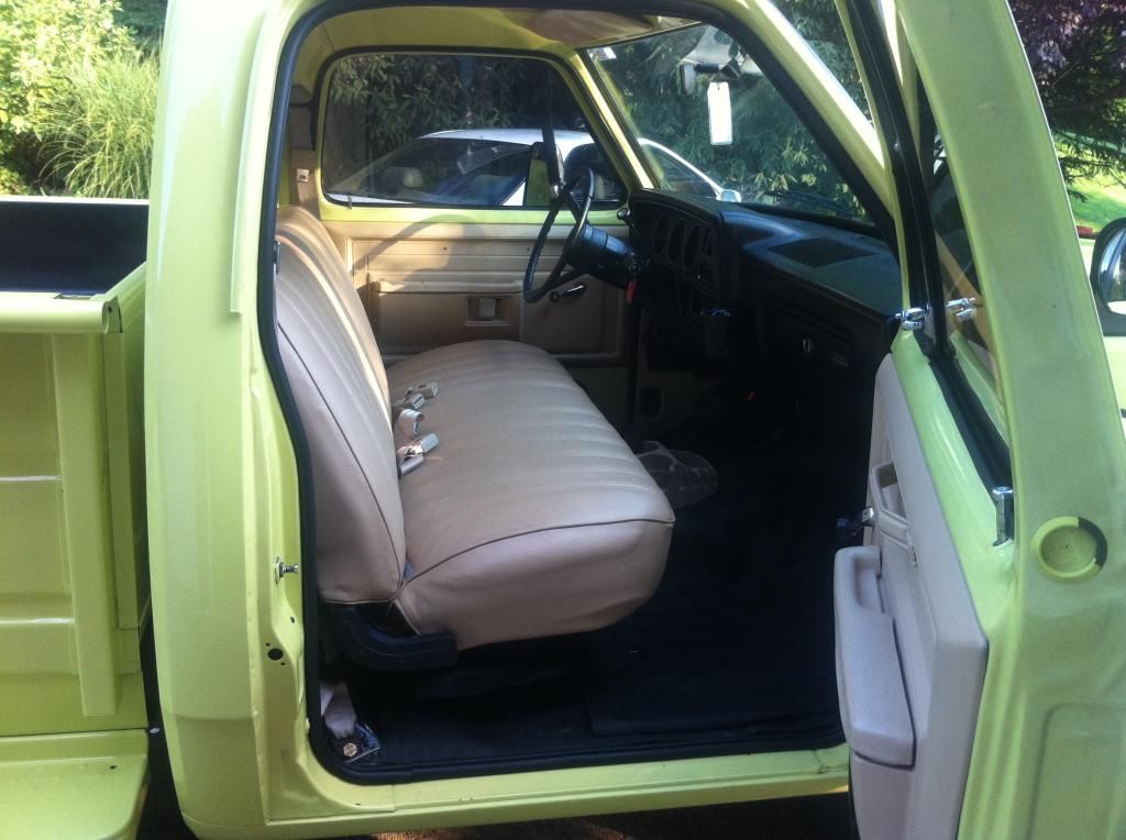

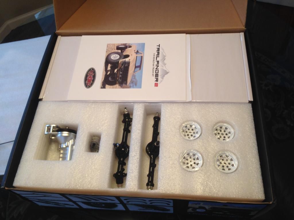

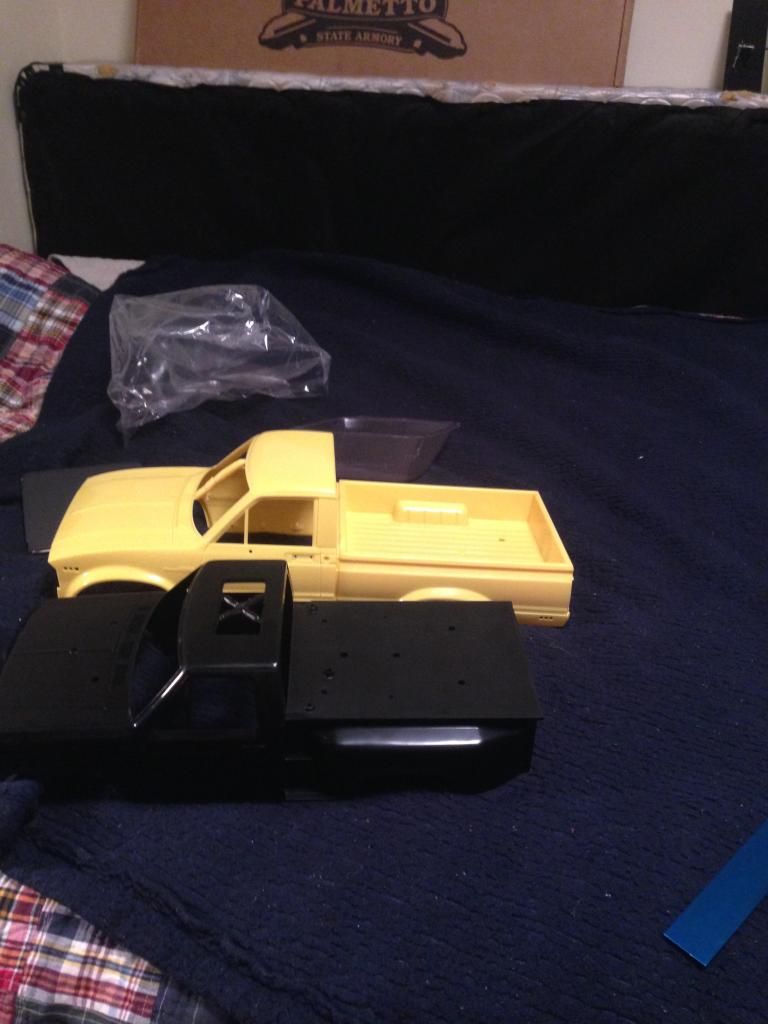

Ok so here it goes, I have an scx 10 with a honcho and dingo body but I really wanted to do something different and unique. The inspiration for this build is my 1:1, a 1983 Dodge Ram D-250 with an 8ft Stepside bed! I've seen a lot of 6 foot stepsides so if you have any pictures of an 8ft stepside Post em up! So to start off I decided to start with the trail finder 2 for several reasons, it has leaf springs all the way around and the 2 speed tranny, as well as the metal axles. I never have worked with hardbodies or styrene before this so if you have any input pleaase let me know! I didn't think I was good enough to start from scratch with styrene so after hours of searching I decided on the Tamiya Blackfoot 3 body. Tamiya says its a 1/10 scale but after a lot of measuring and math I determined that compared to my truck and the RC4WD chassis that I will be making a 1/11 Ram. So after a lot of measuring and re measuring I have determined that I will have to add 2 inches to the wheelbase and 0.5 inches to the width, and I am still contemplating adding 0.25" to the height. That will come later. So Now onto some Pictures of the real truck and the progress!!
[/IMG]
How it starts for every TF2 Builder!

The First Big CUT!

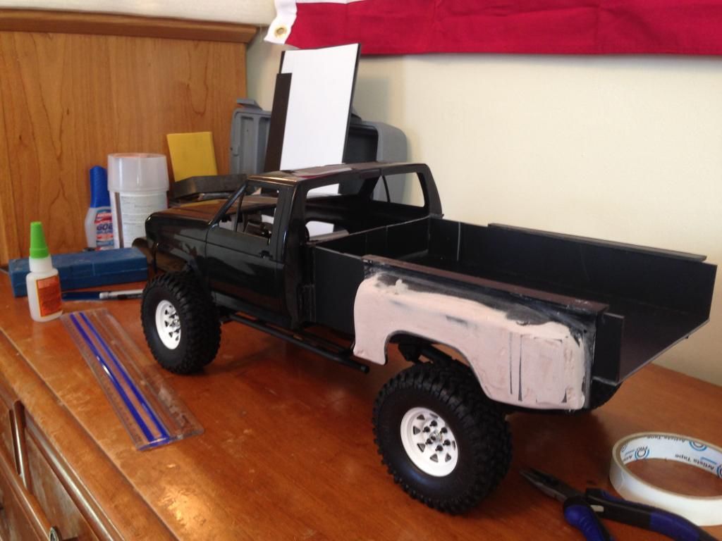

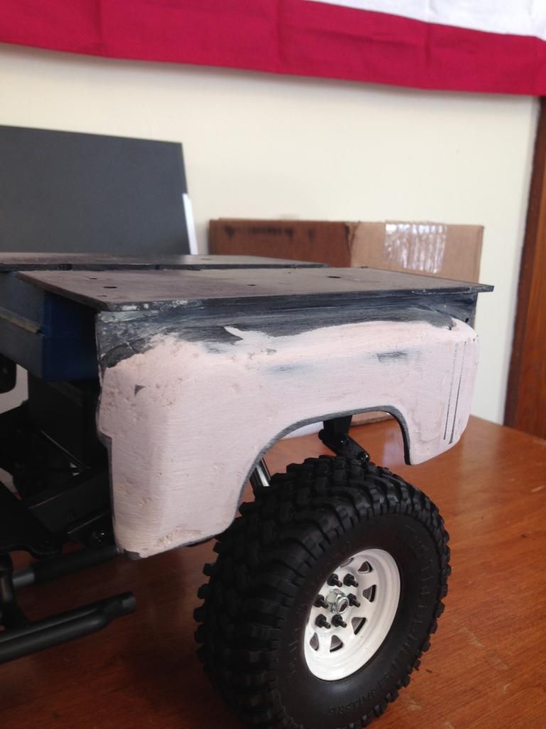

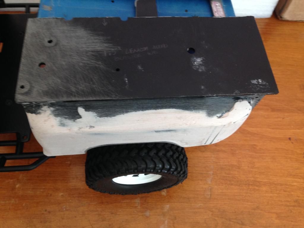

Prepping the bed for reshaped Fenders with 3mm styrene to fill some space
Filling the Cutout on the cab
Cut out the small square in the corner
Continuing the bed post all the way down

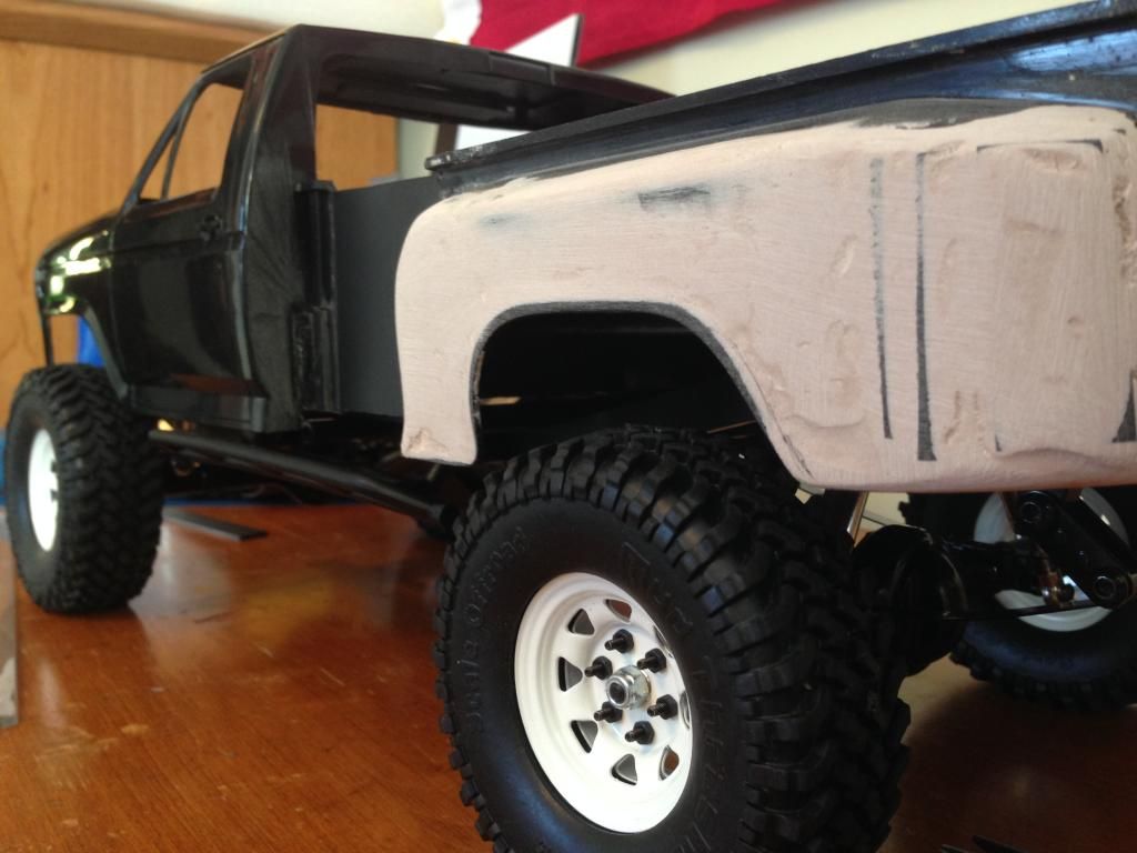

Thats all for now I started to Bondo up the fenders but don't have any pictures yet Stay tuned for an awesome truck!!

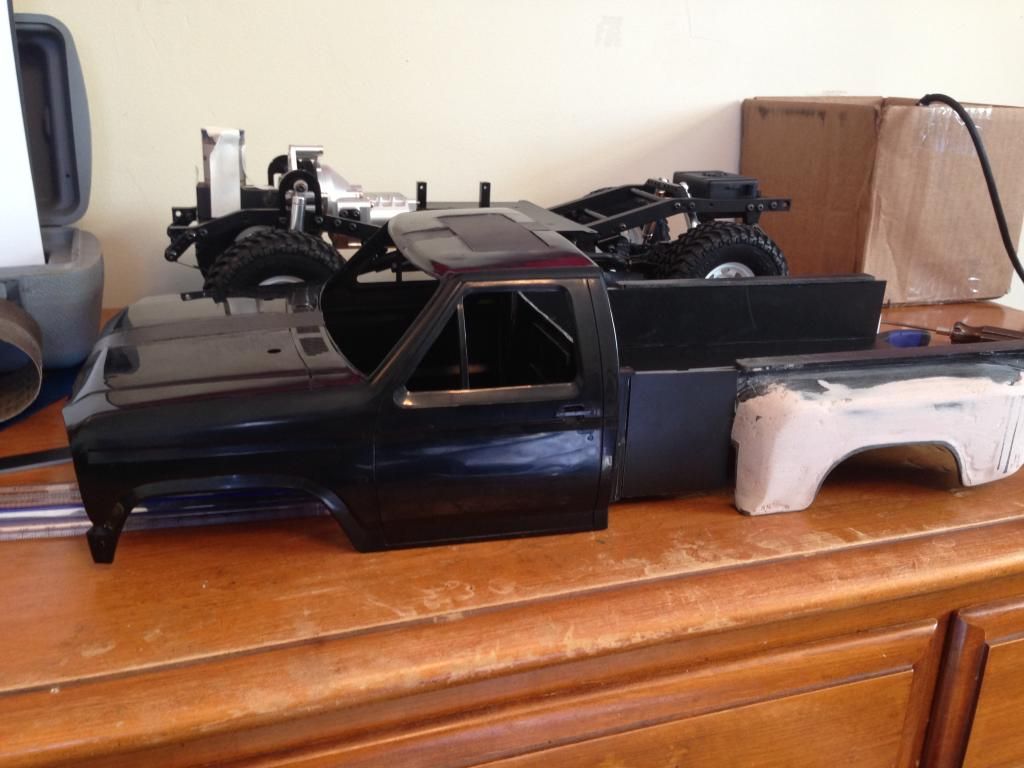

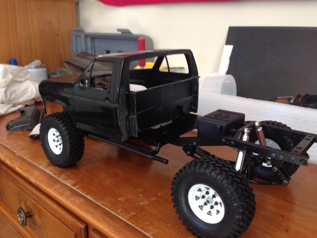

Ok so Here we go with some more progress, LOTS of Pictures!

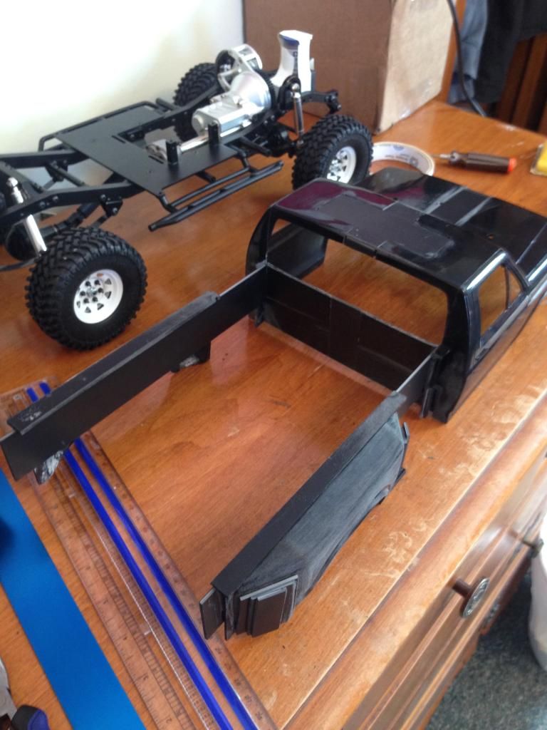

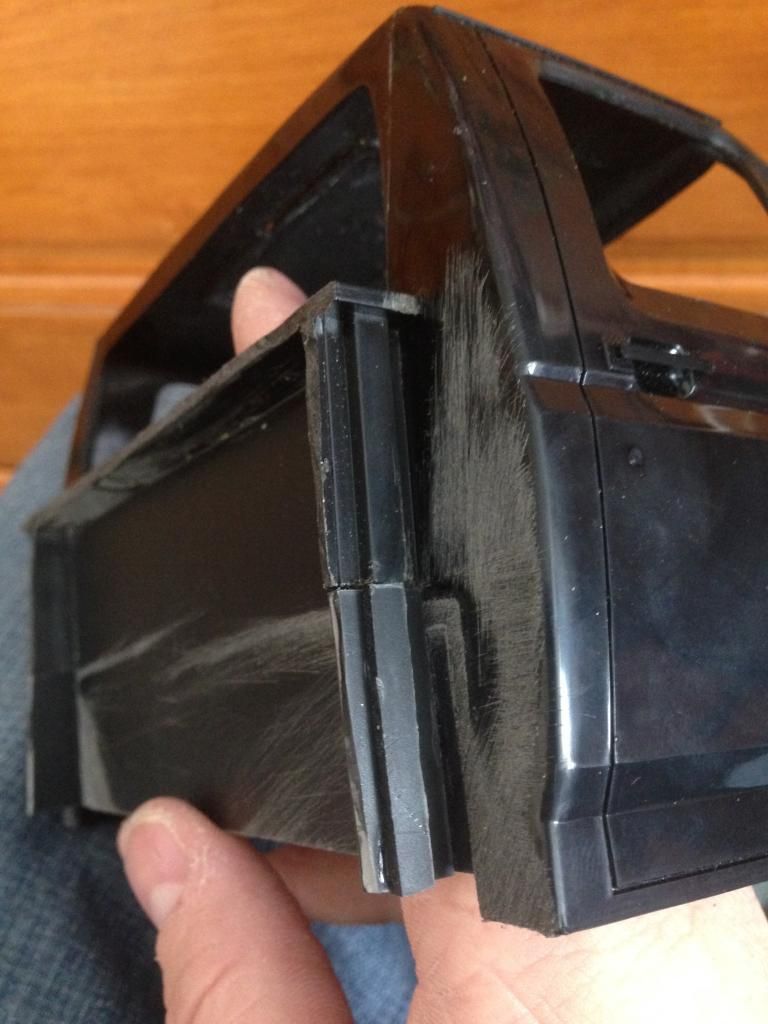

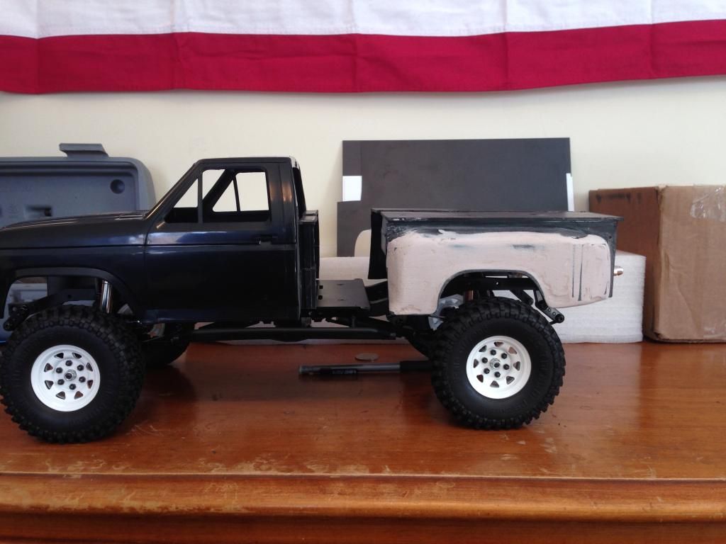

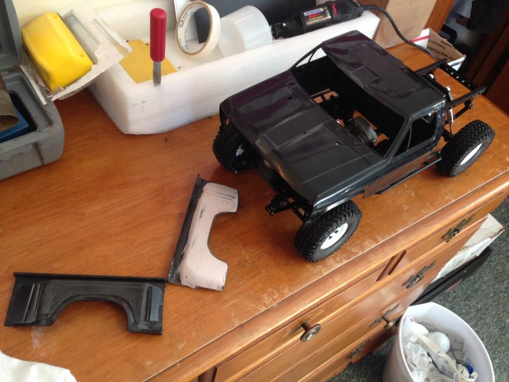

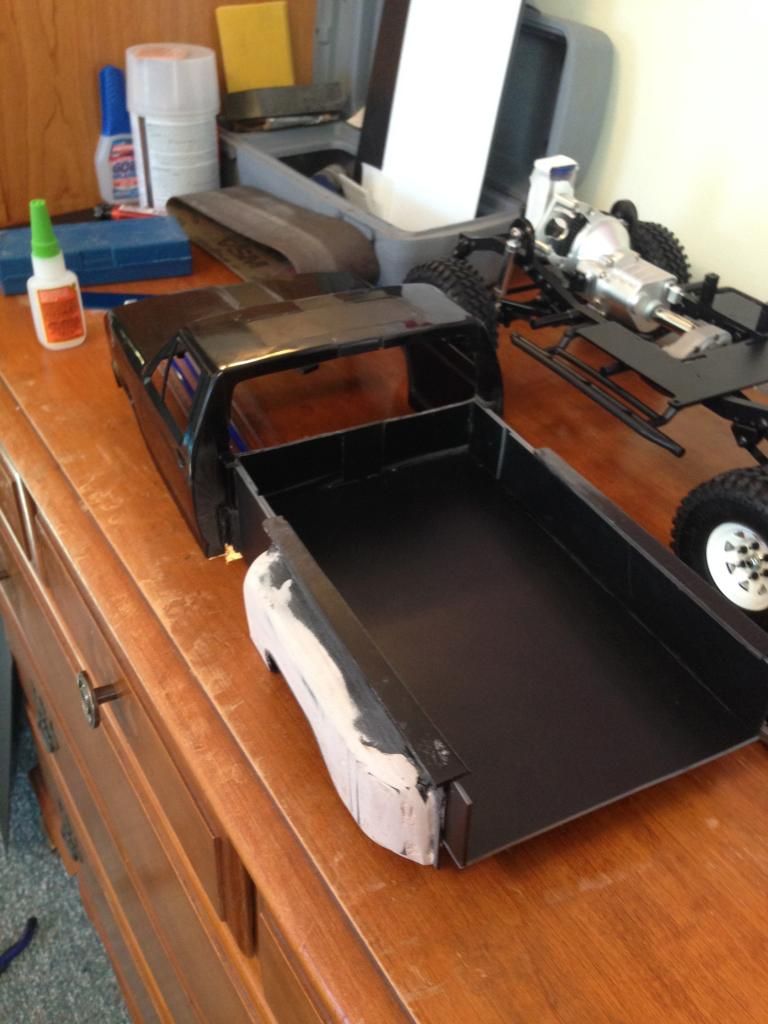

did another big cut, this time its right down the middle! Put spacers in to start filling the gaps
Got the front gaps pretty much filled in and I decided to do a Drop- bed so hacked the bedsides all up too!

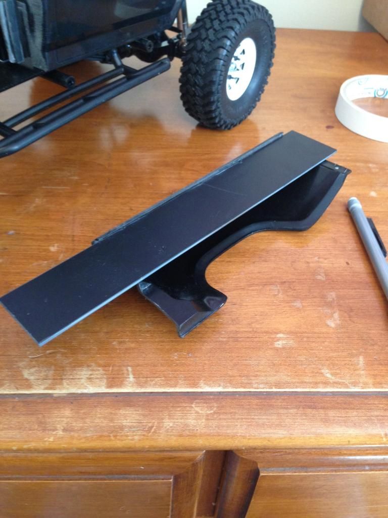

Workin on the bed now!

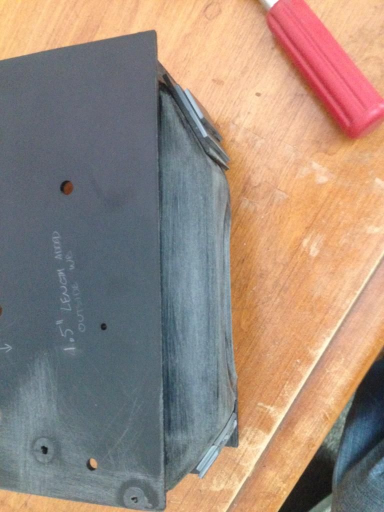

So The bedsides went on and I did a little miscalculation and the wheelbase ended up .25" short. Not to fear!
Cut it down the middle added .25" on another layer and now the layers line up the the actual bedsides!

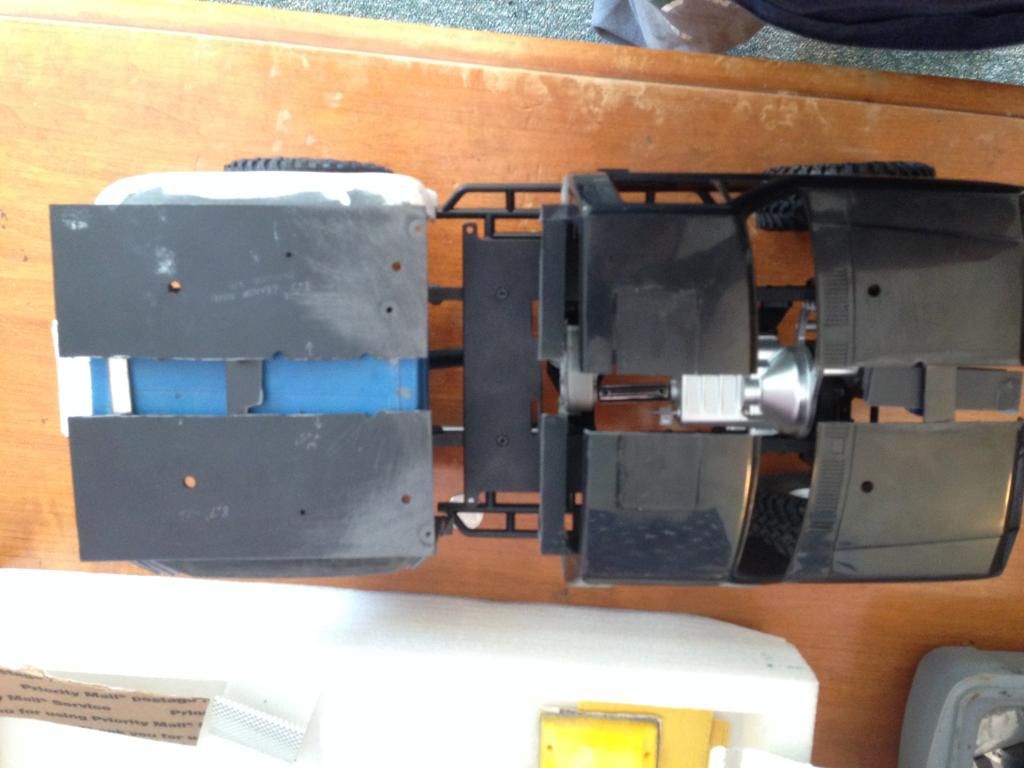

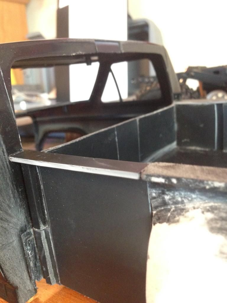

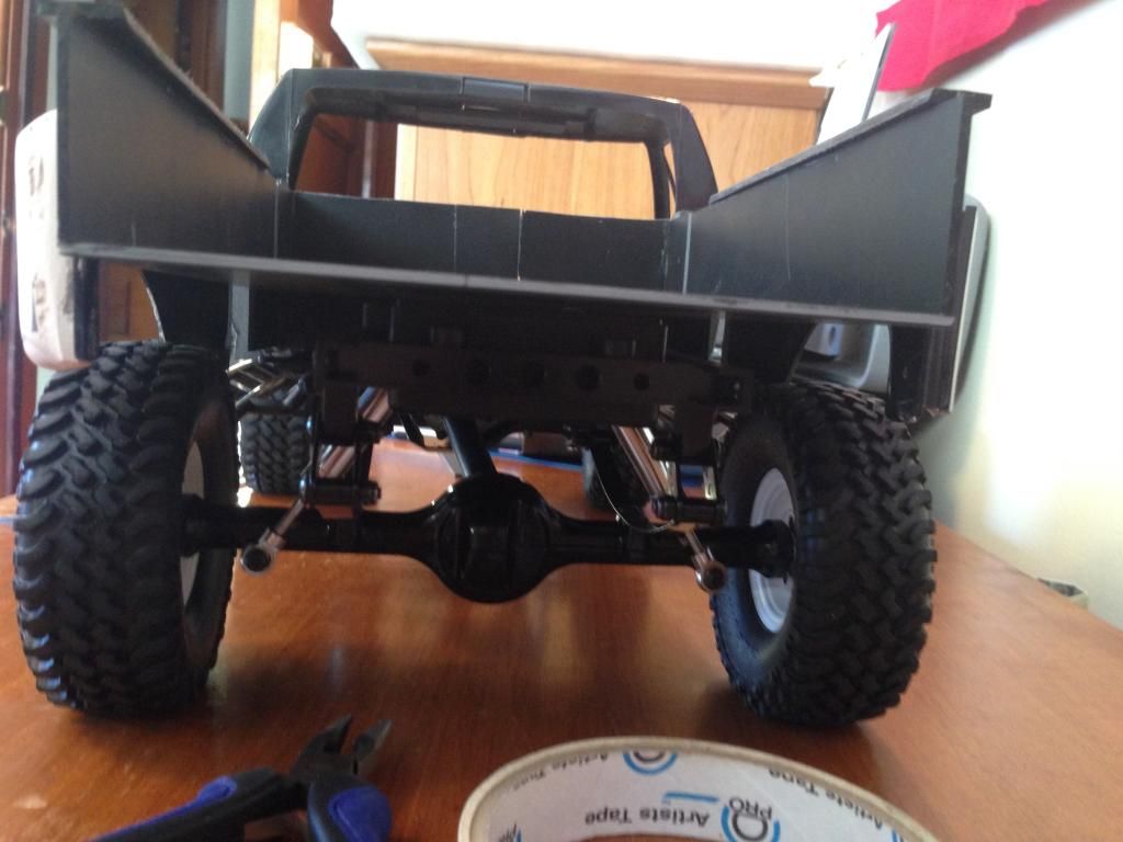

Structural members.

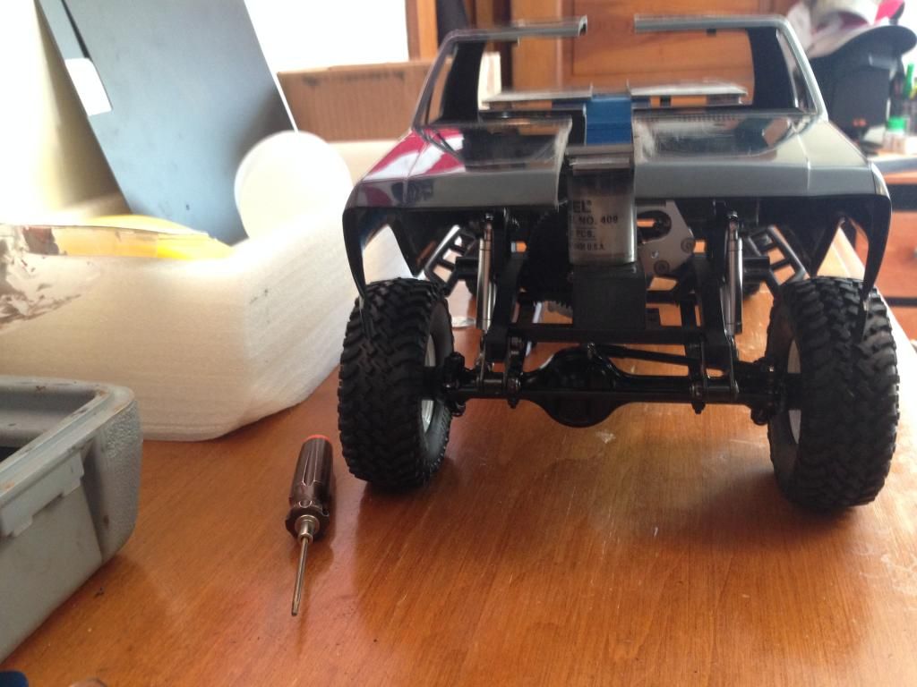

Moved the receiver box location to underneath the rod instead of on top so it is in line with the shocks

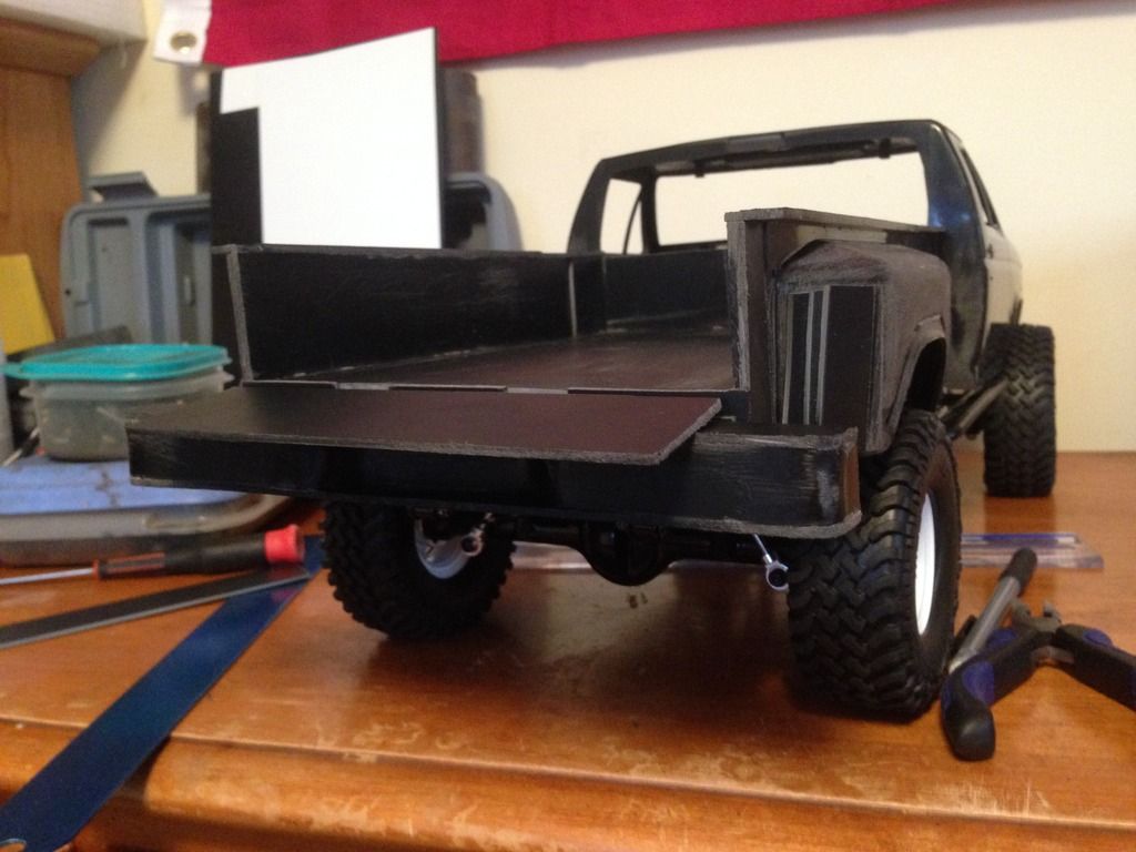

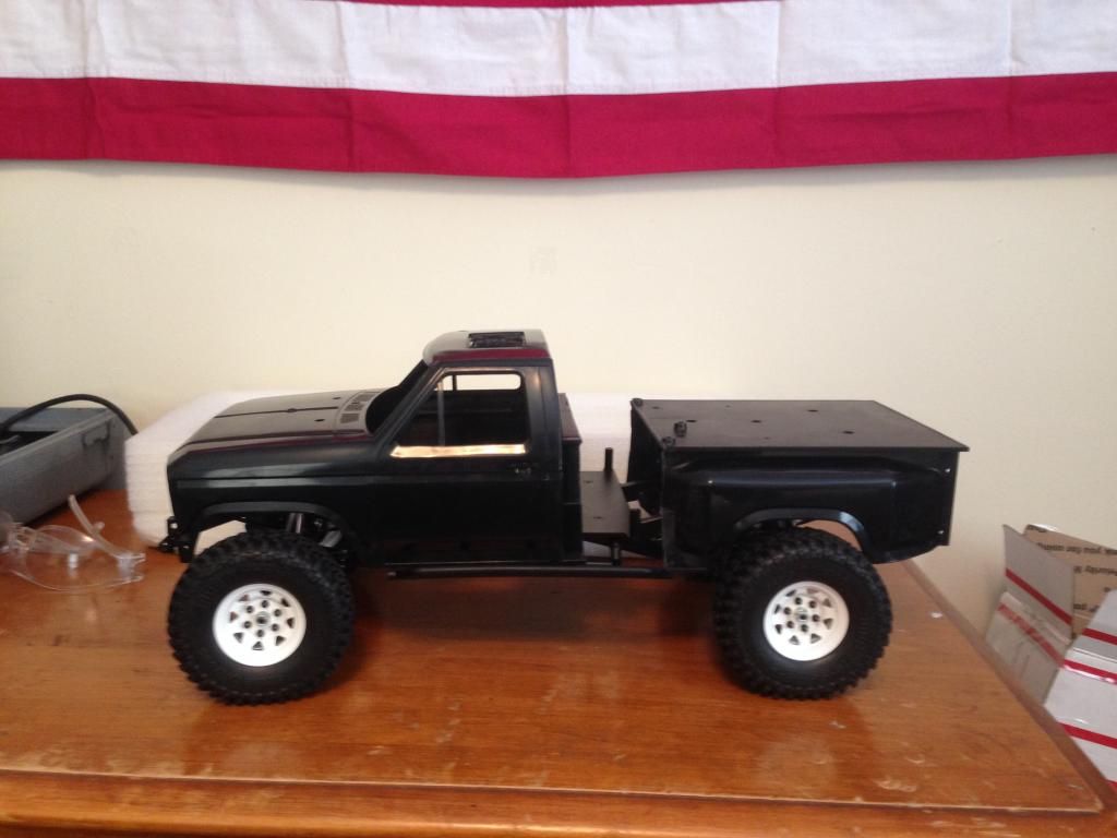

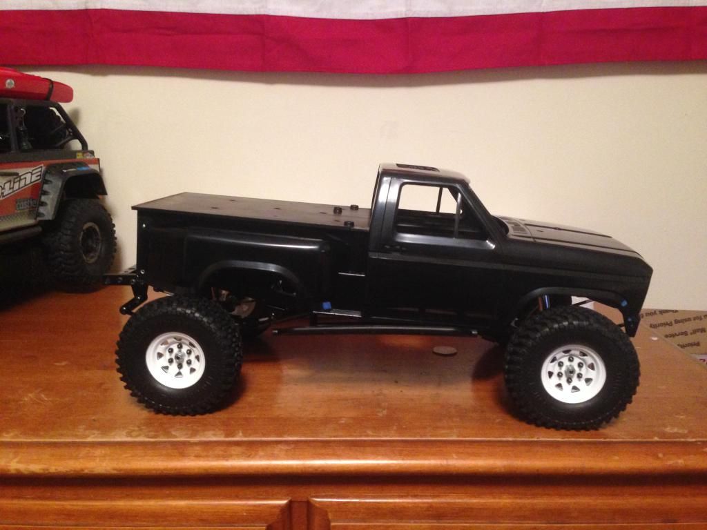

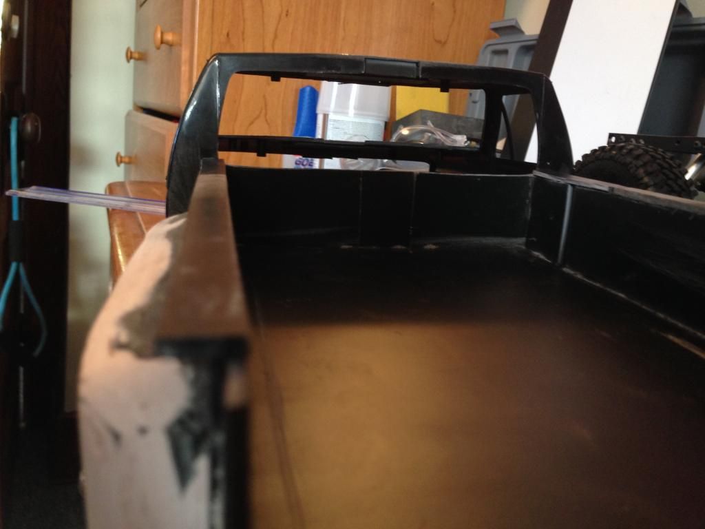

And finally I got the bed floor in!
Looking Good!!!
Loving this glue!
Bed Rails installed

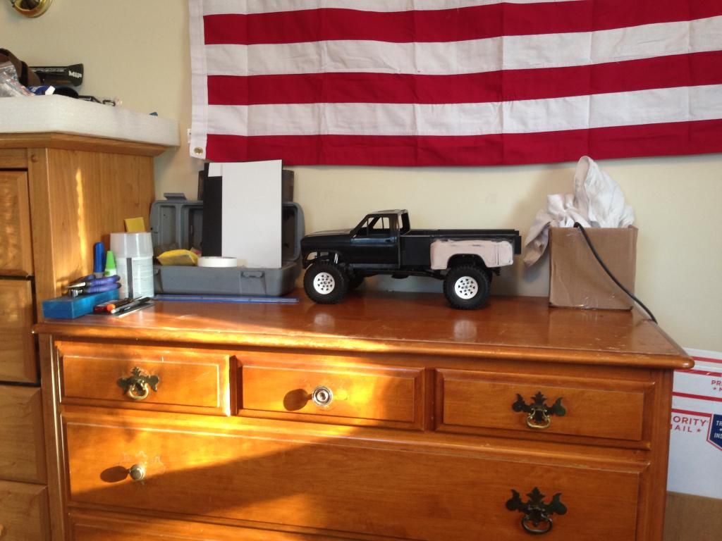

And the Required Flex Shot..
Not too shabby for the top of a dresser workbench

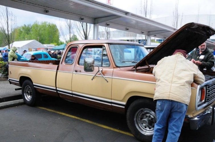

We used to have a '78 Club Cab longbed. It was a bitch to park, but was a great truck. Looked like this...

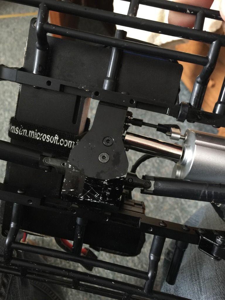

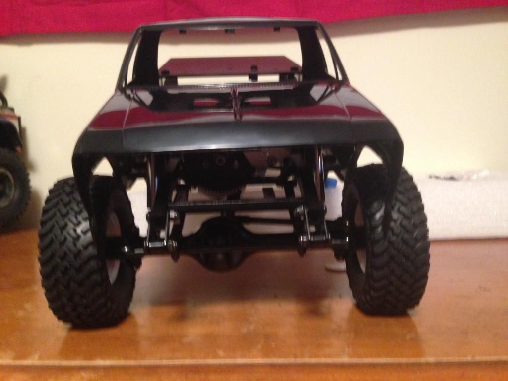

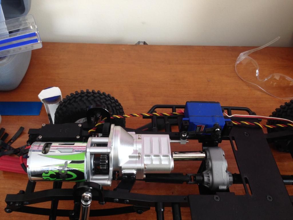

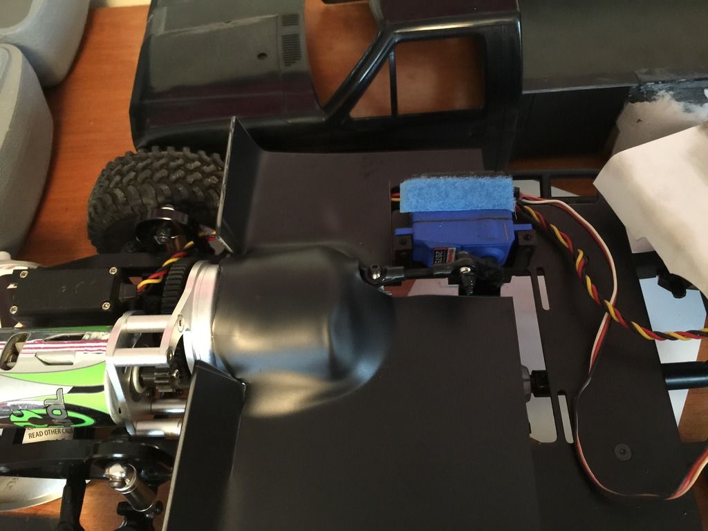

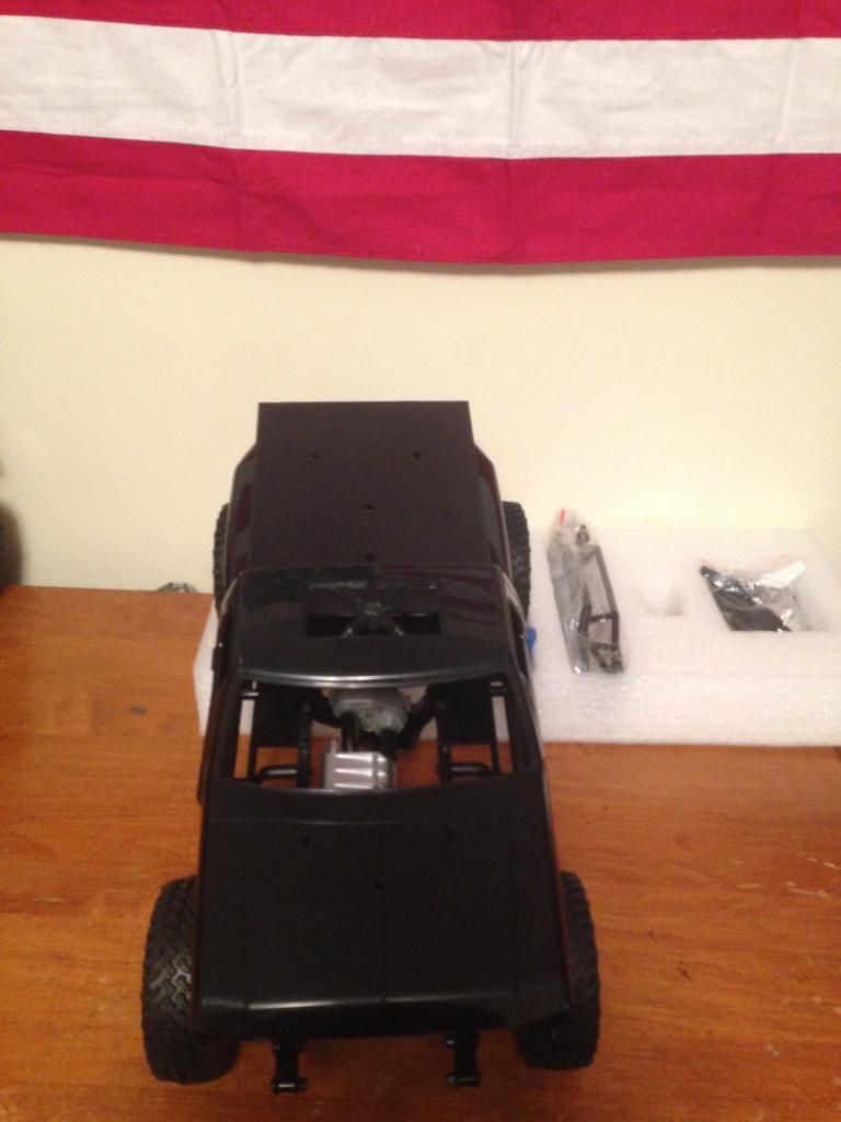

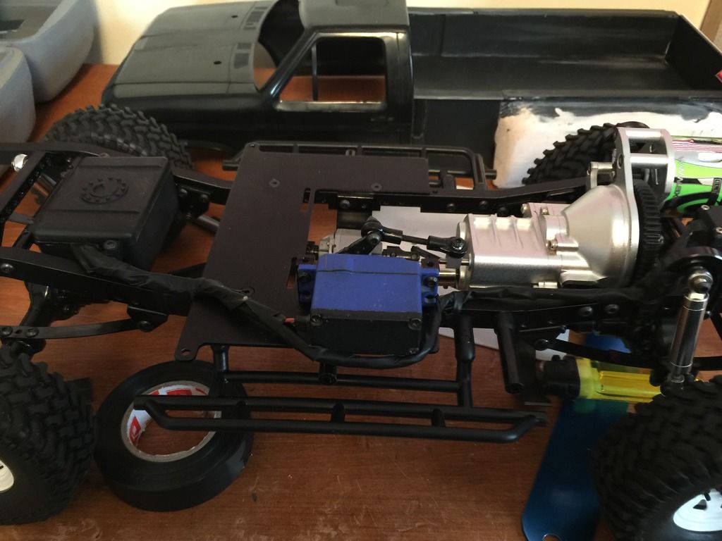

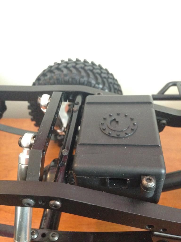

Its Been awhile but here is just a little bit more progress I got some electronics installed on her and Found out I needed to cut a slot out for the shifter servo.
And I ordered an AE-5 esc for it so hopefully that comes soon. But I just threw an xl-5 in just to see how it runs and I have a question. Should you be able to shift on the fly if you get your servo endpoints set correctly or do you have to come to a complete stop?

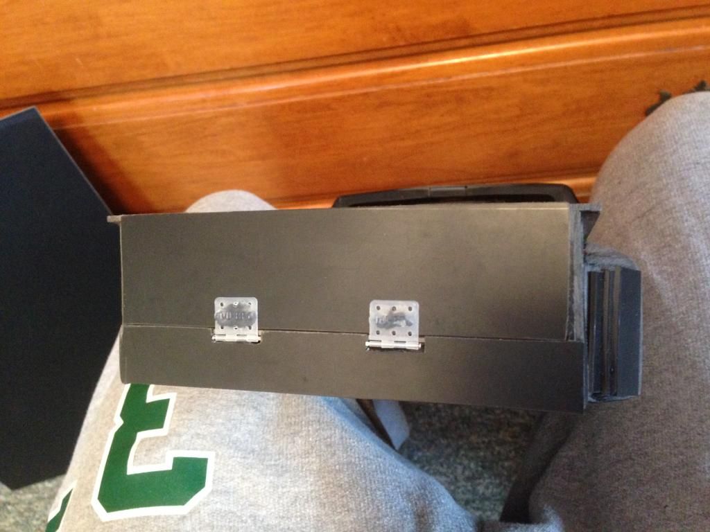

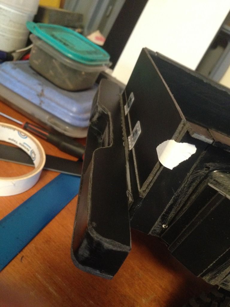

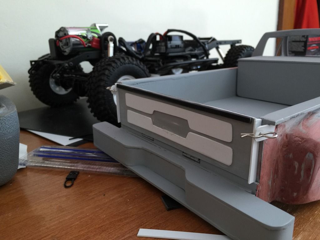

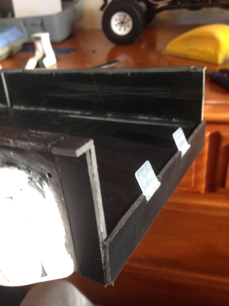

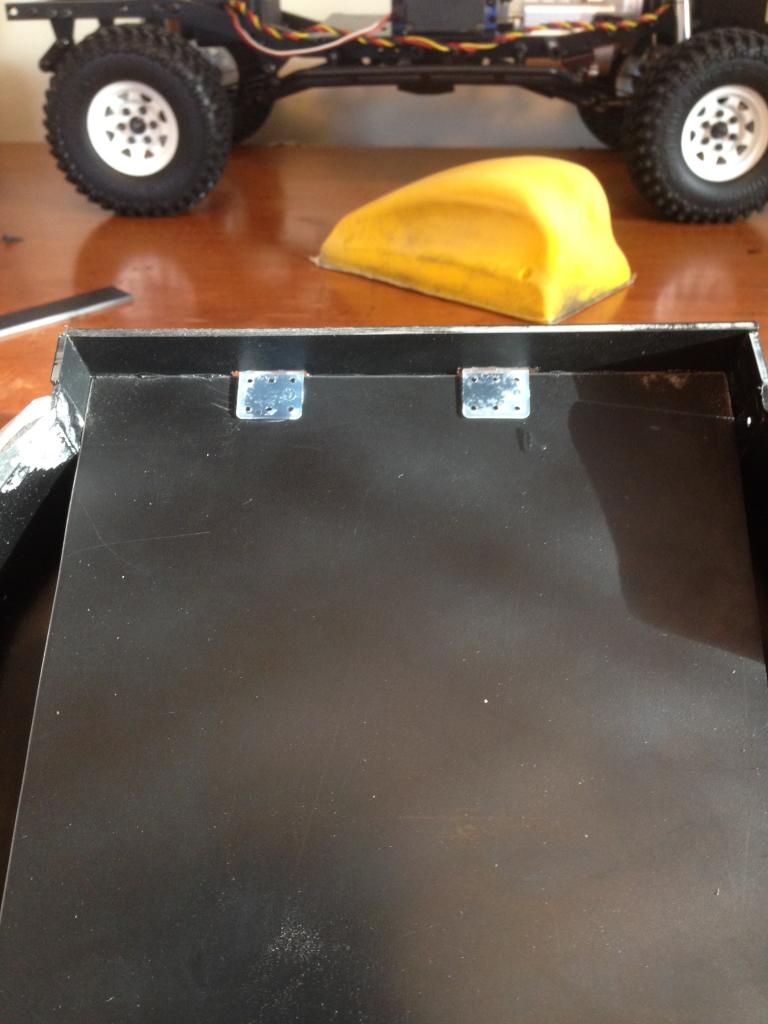

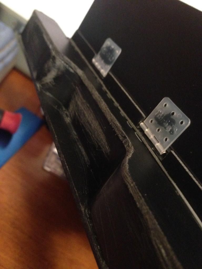

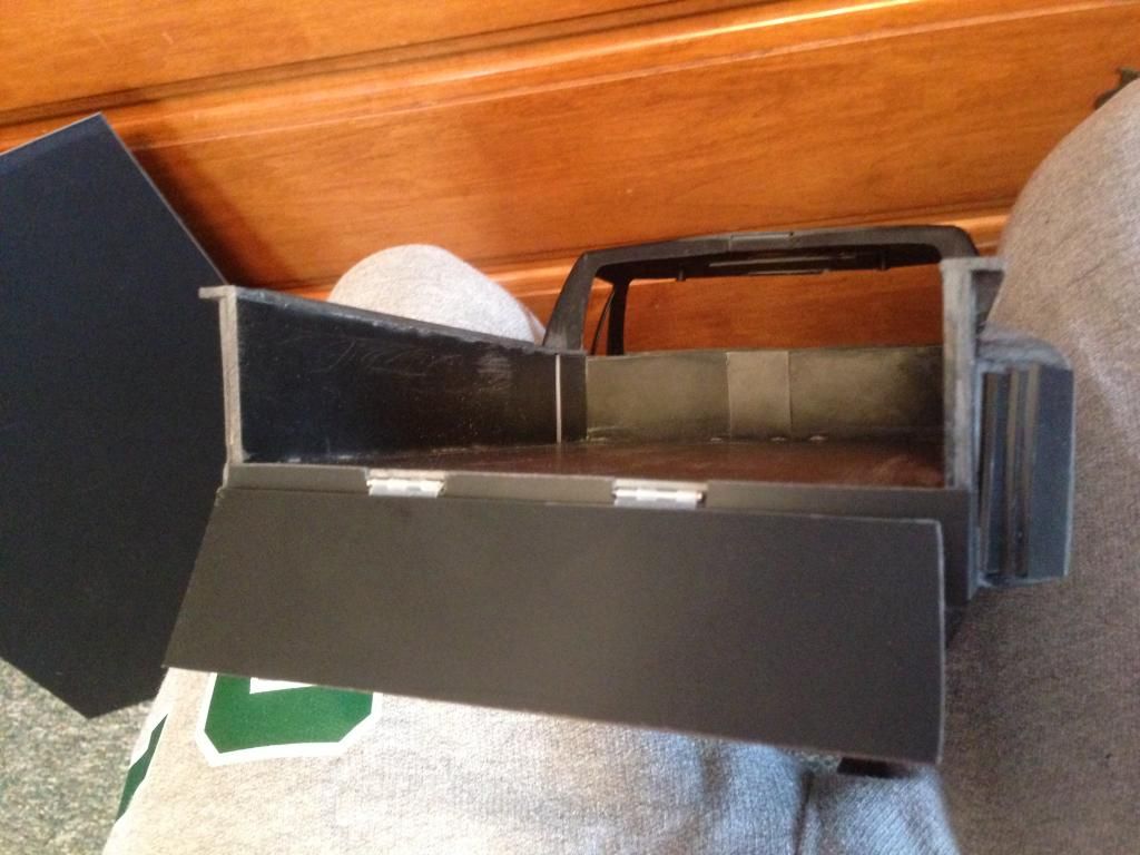

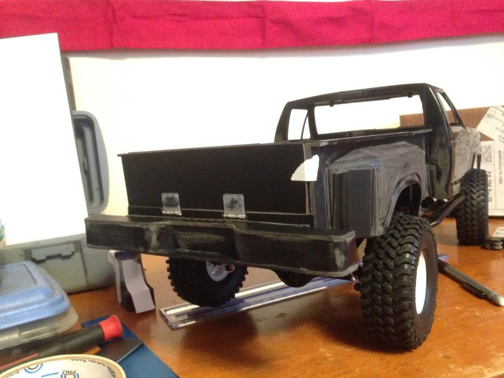

I also got some airplane hinges glued up for the working tailgate and started on the tailgate. It still needs an outer layer to hide the hinges

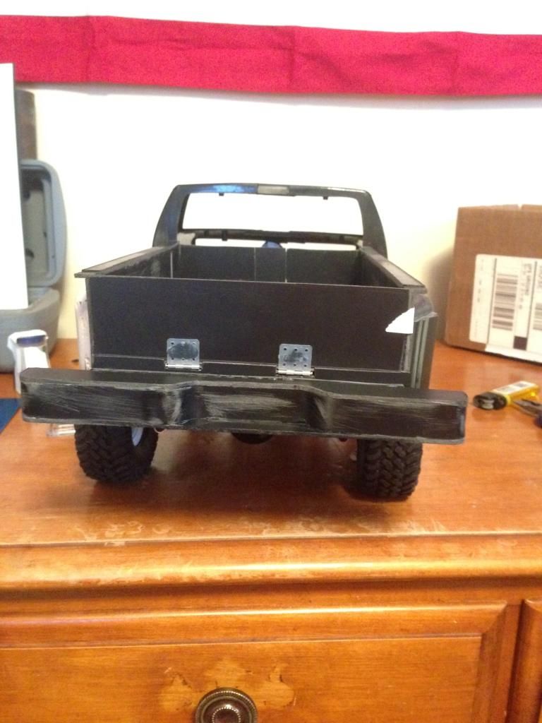

Then I started working on the rear bumper by cutting a long strip and using a lighter to heat it up and bend it to shape.

I wrapped all the servo wires with electrical tape to get a cleaner look...

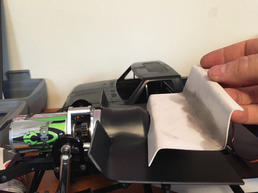

Then I started on the interior with bending up a seat.. still needs a lot of work but its a start

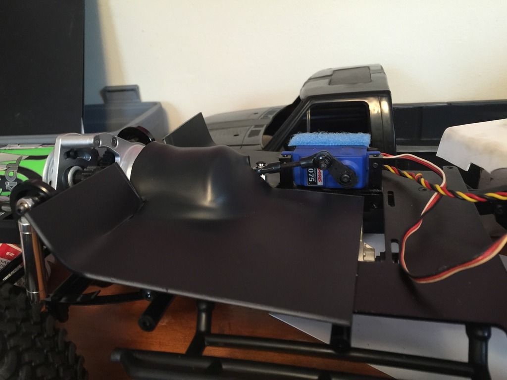

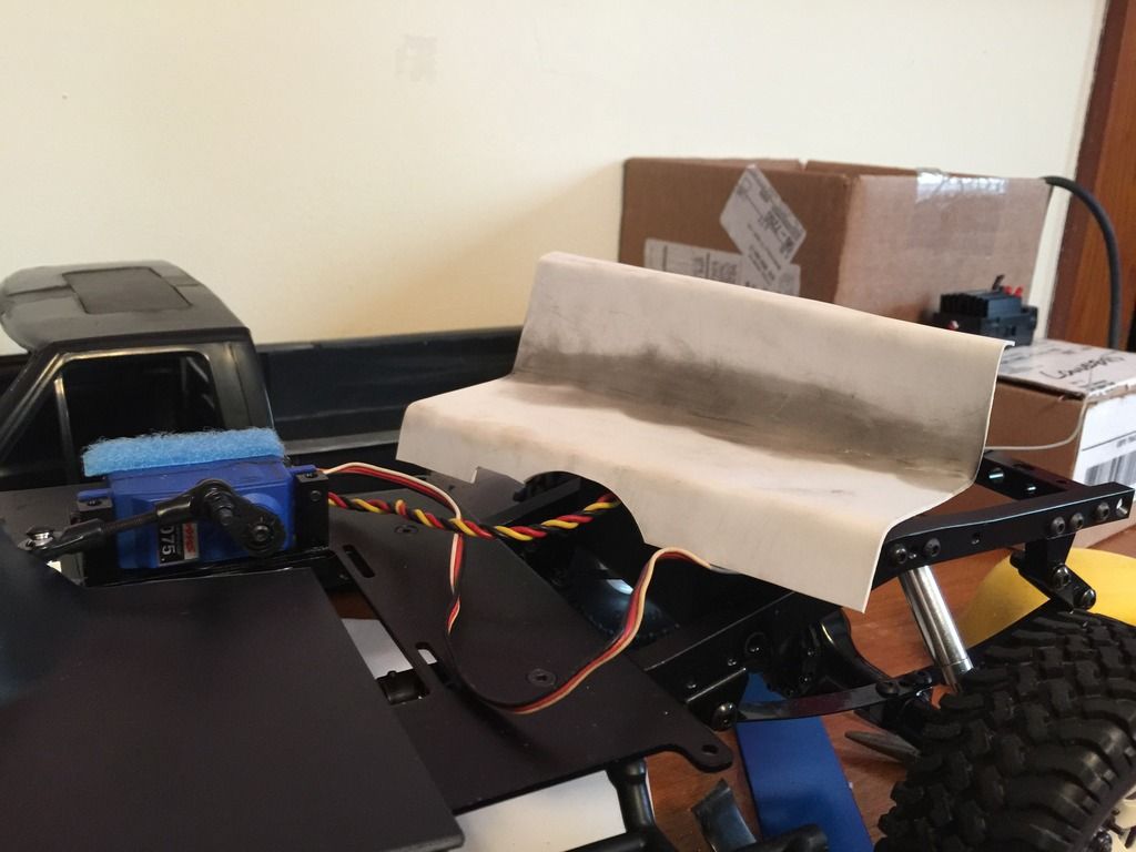

Cut and molded a piece for the floorpan. Heated it up with a lighter and pressed it down over a tamiya spray can to get the transmission hump.
Had to cut out a spot for the shift servo.
But the seat will cover it all nicely

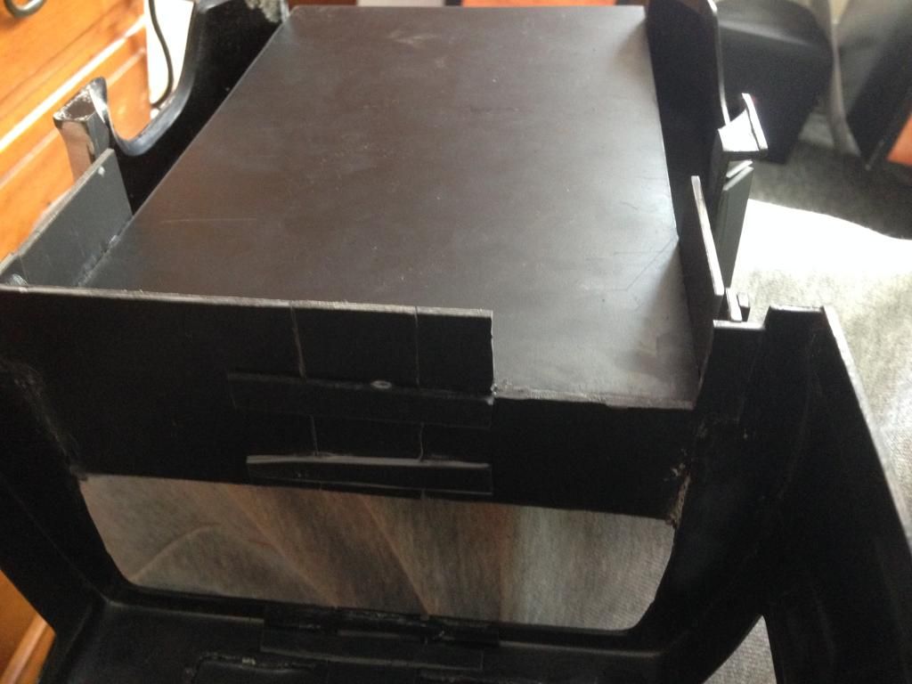

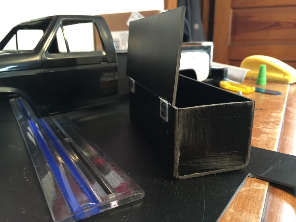

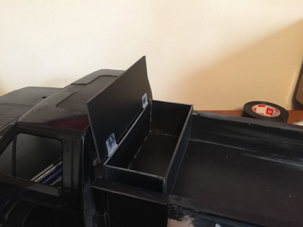

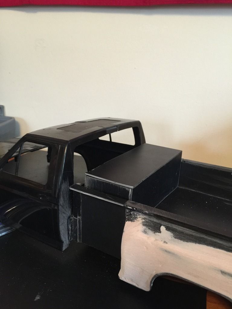

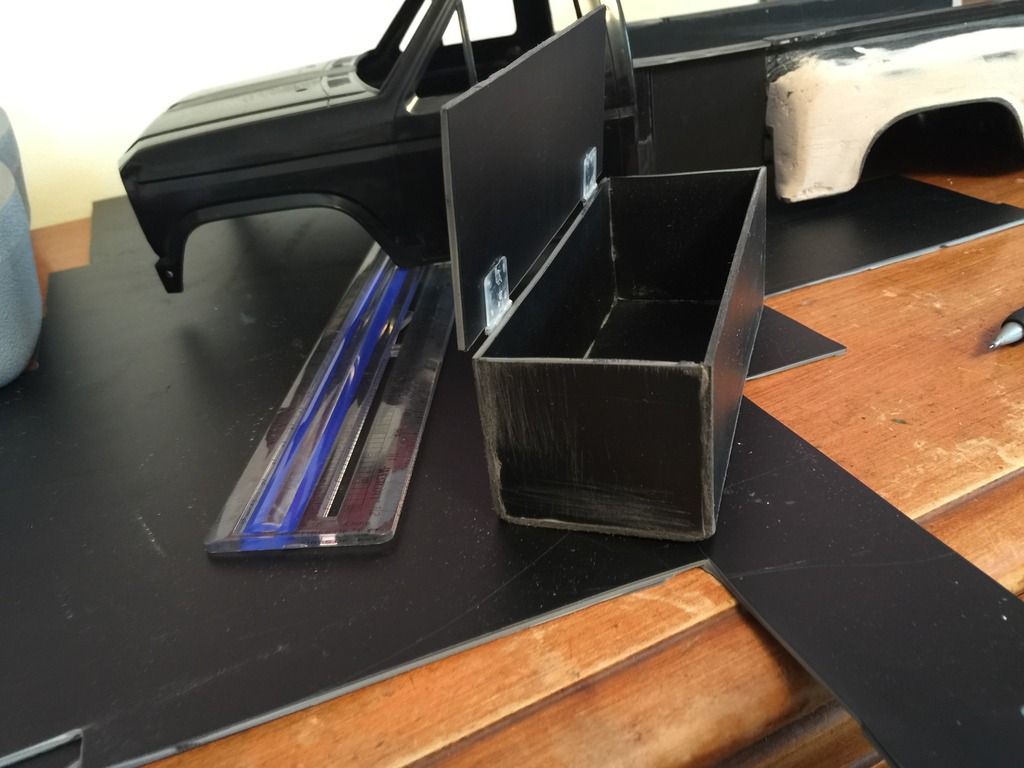

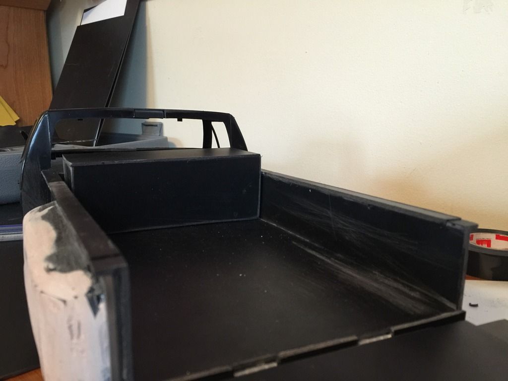

Then I decided to give a go at the toolbox in the bed that I am going to use to hold the esc and the battery for easy access.
More Airplane hinges
Didn't glue the toolbox in yet because I am going to be making a balsa wood bed strips.

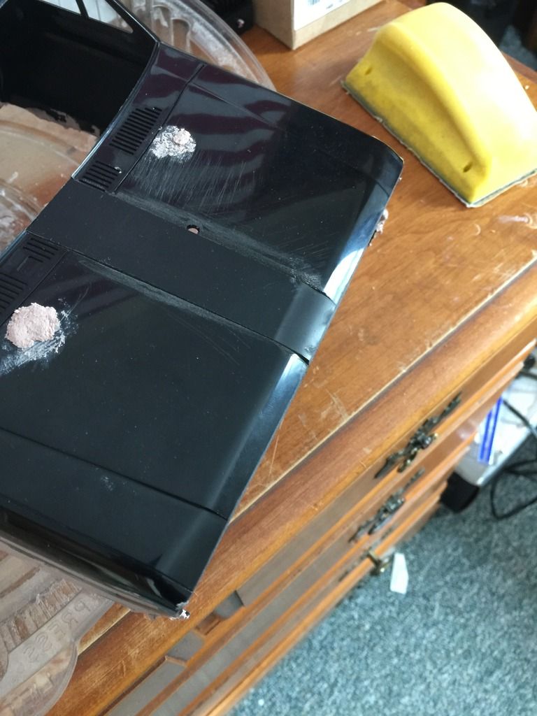

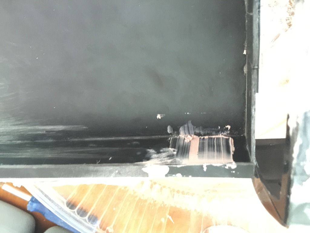

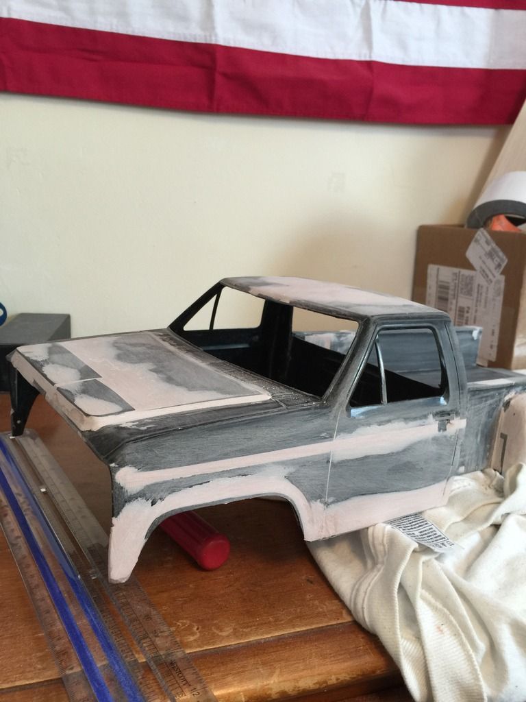

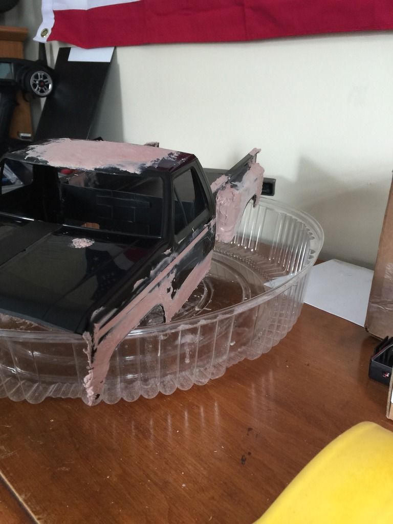

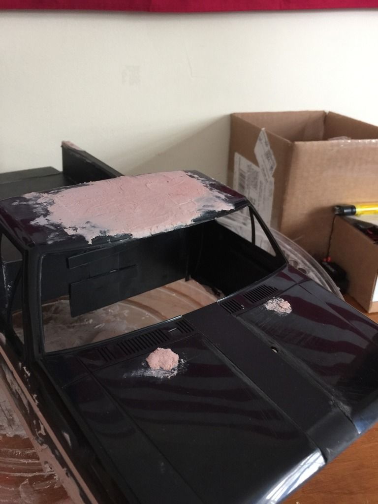

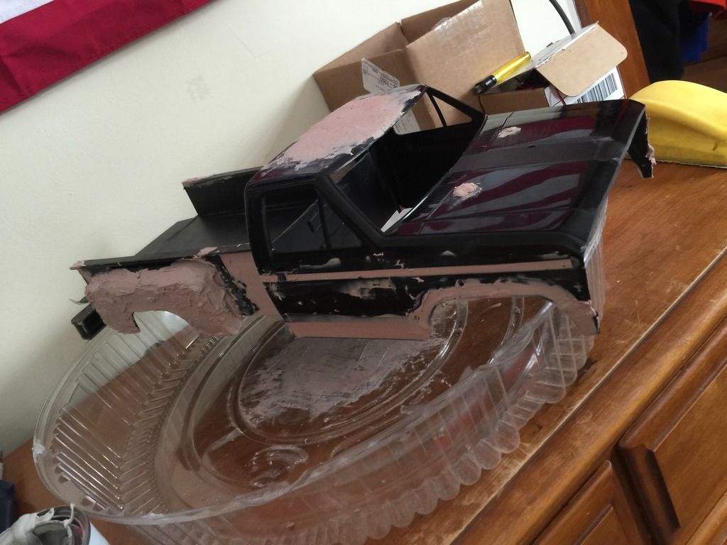

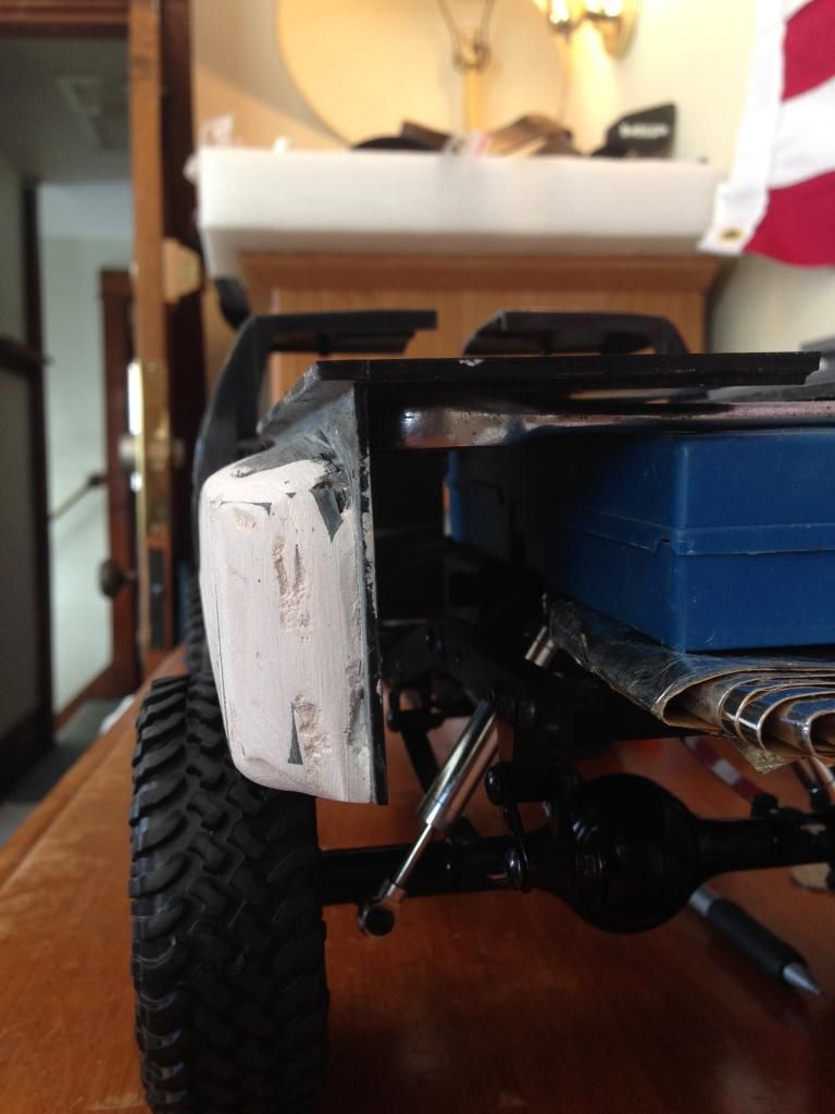

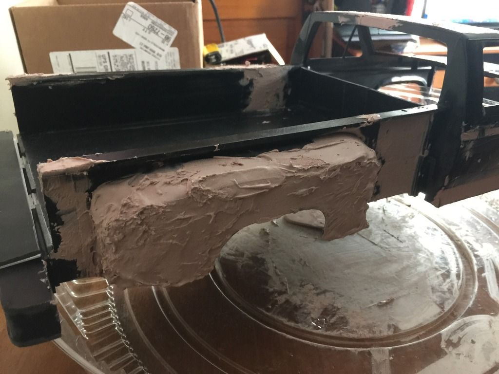

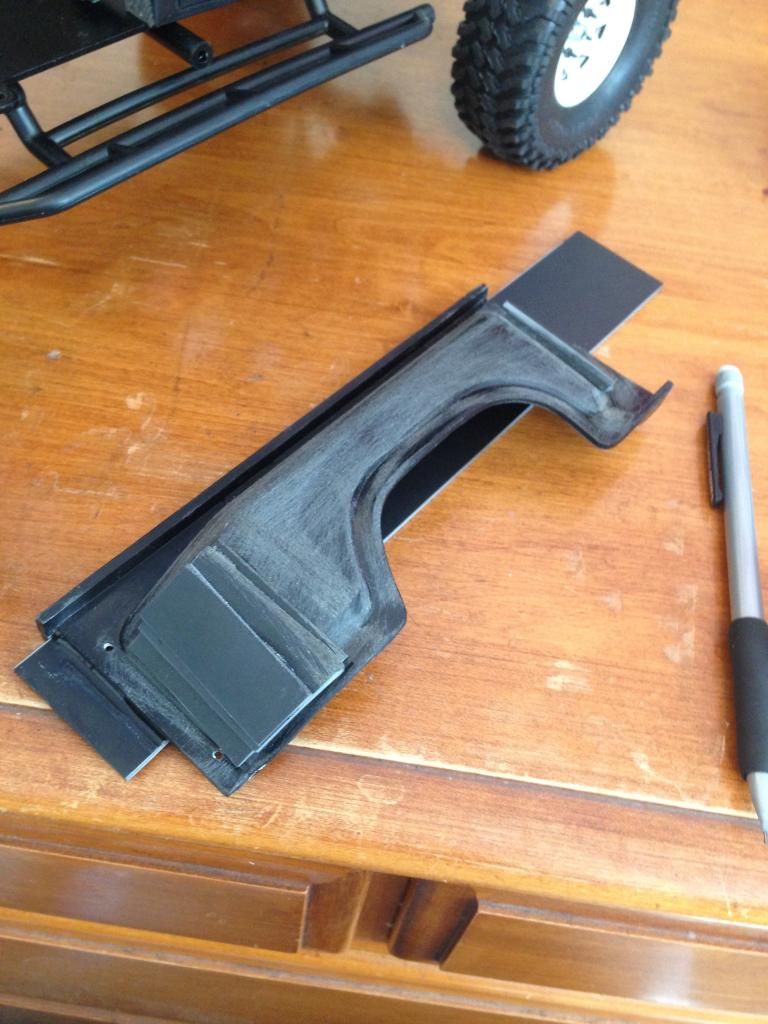

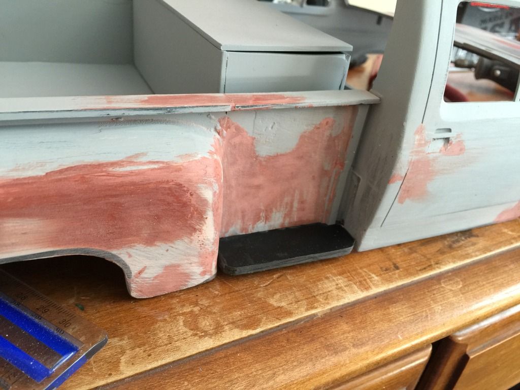

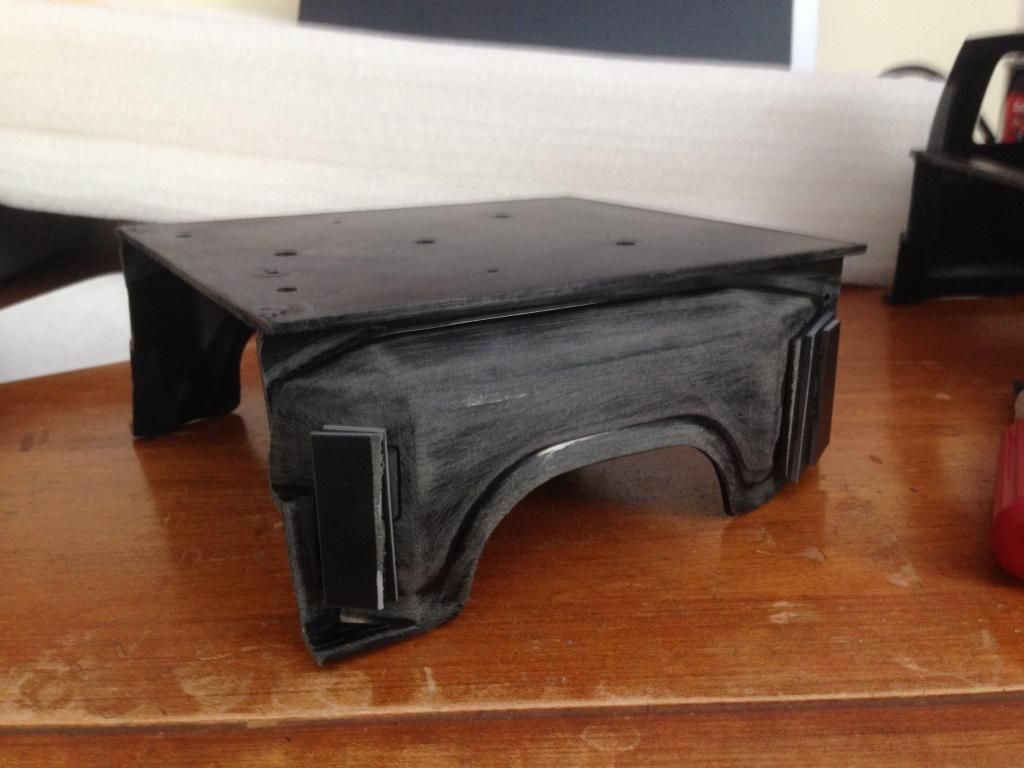

Here is some more progress of the truck! I did some more bondo work, filling in the body lines of the ford and gonna start to add the door panel shapes of the dodge. It has been a ton of work but it starting to come together, really debating whether or not to do an interior. Does anyone know what/ where I can get a trail finder interior?

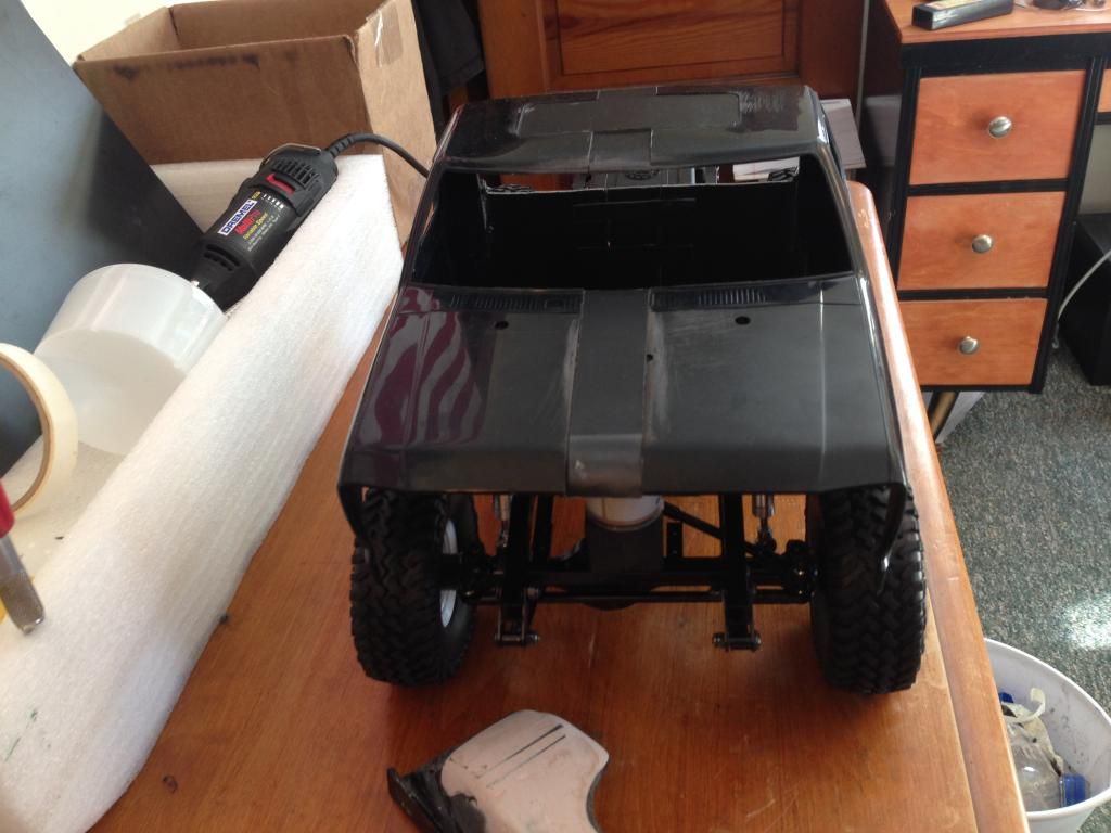

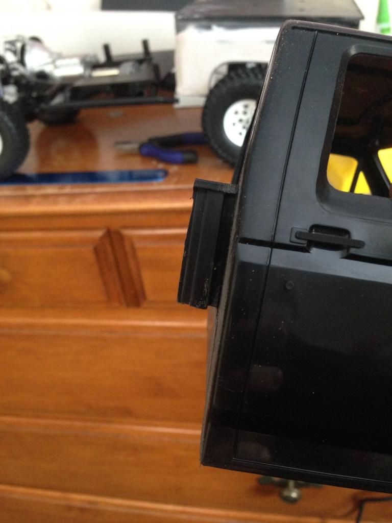

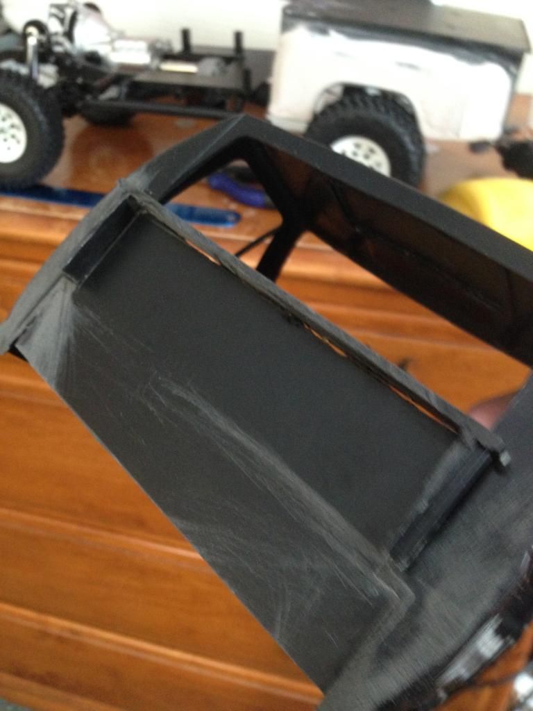

Chopped off the front angled piece to match the flat front of a dodge
Got her a little scratched up!
Stay tuned and spread the word please!

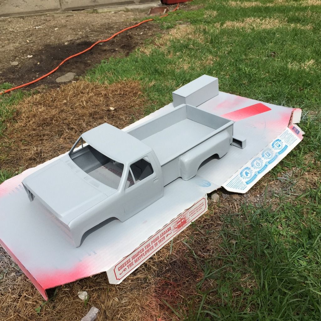

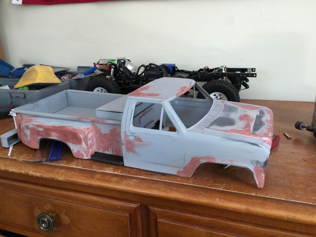

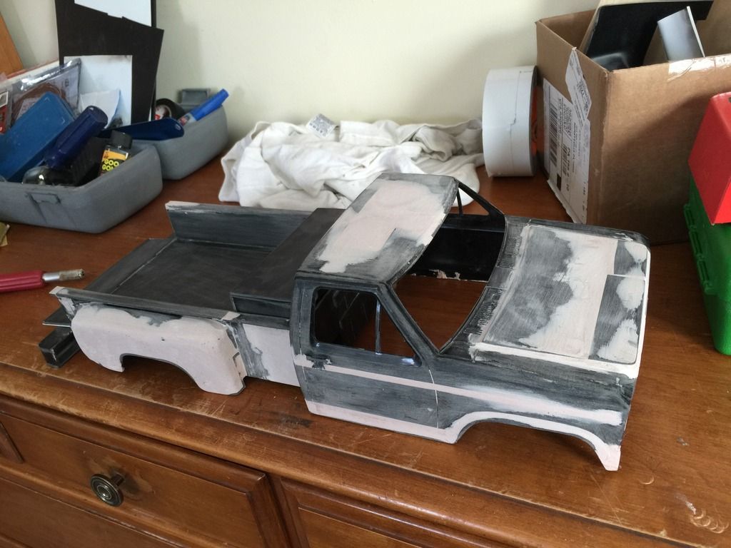

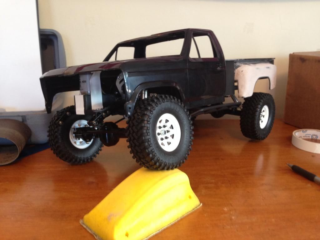

It has been awhile since I replied. but here is some more progress of the truck. Got all the bondo work done and sanded nice and smooth
Then I got impatient and wanted to put paint on it...so I did primer
More sanding, sanding, sanding... and small gap filler
and then i forgot I needed to add a few more detail parts bedsides and tailgate details
Then more primer on after that but I don't have a picture of that yet
Almost ready for paint...and Summer!
Let me know what you think!
